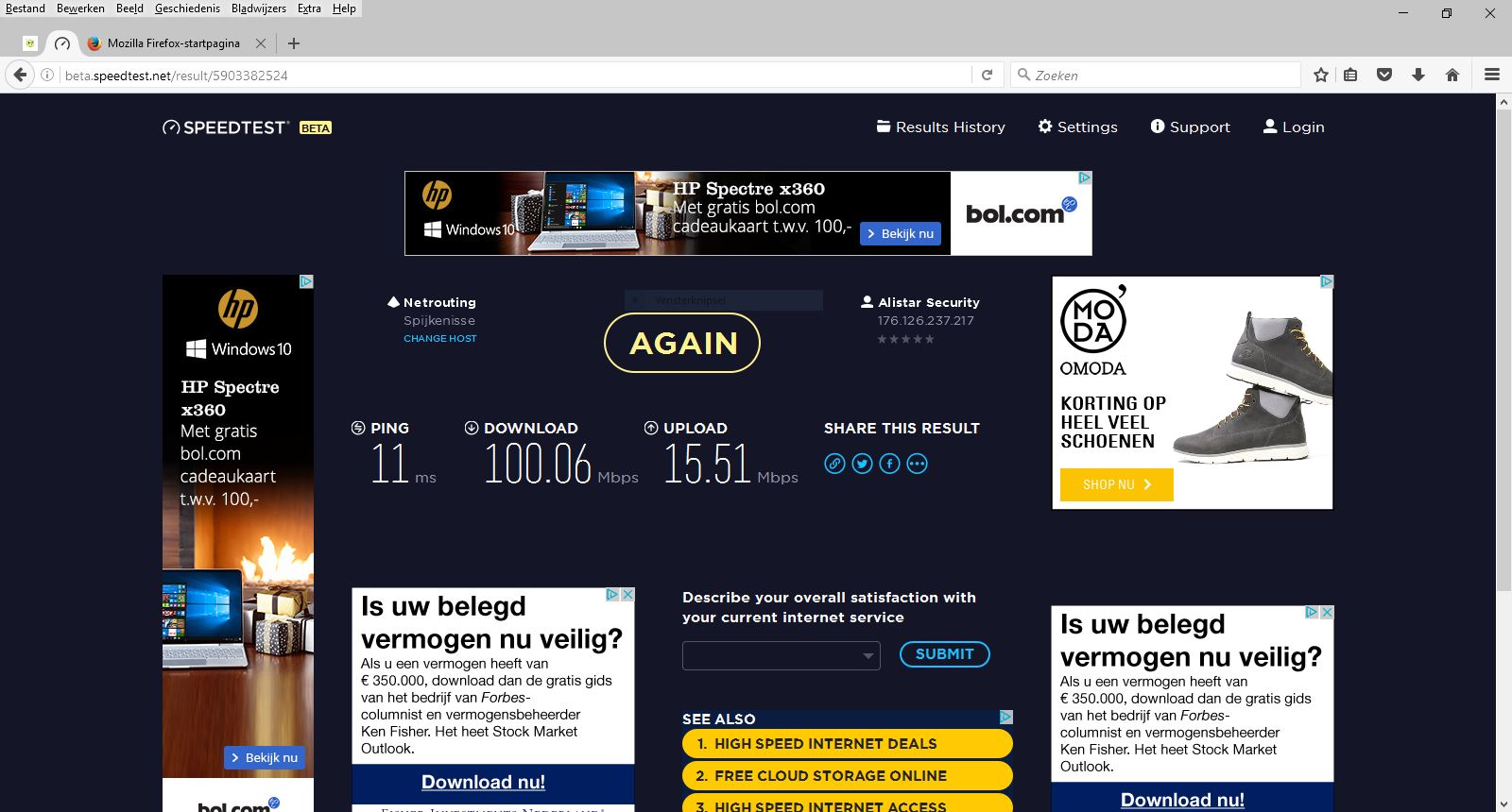

    Yeah.....I found the problem....today I ask my ISP to put their modem/router into bridge mode, that did the trick!
    Somehow it blocked more than I thought....

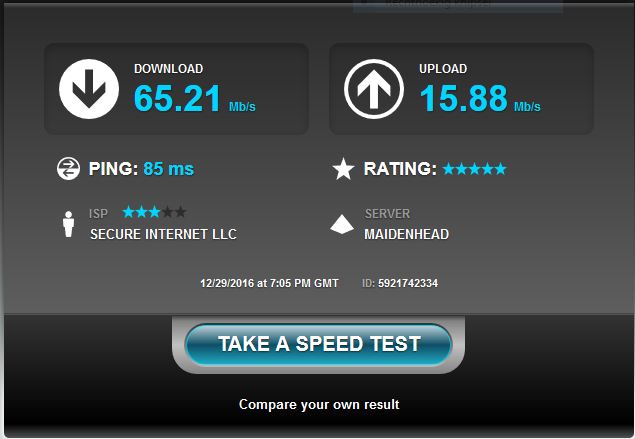

    Here a Speedtest with a PureVPN UK server around 8 pm:
    So much for thinking that dutch OpenVPN host have no speed...
    Connected with VPNbook ovpn file: "vpnbook-euro1-udp25000.ovpn"
    Maybe you should try it too "Infinity"...just for fun?
