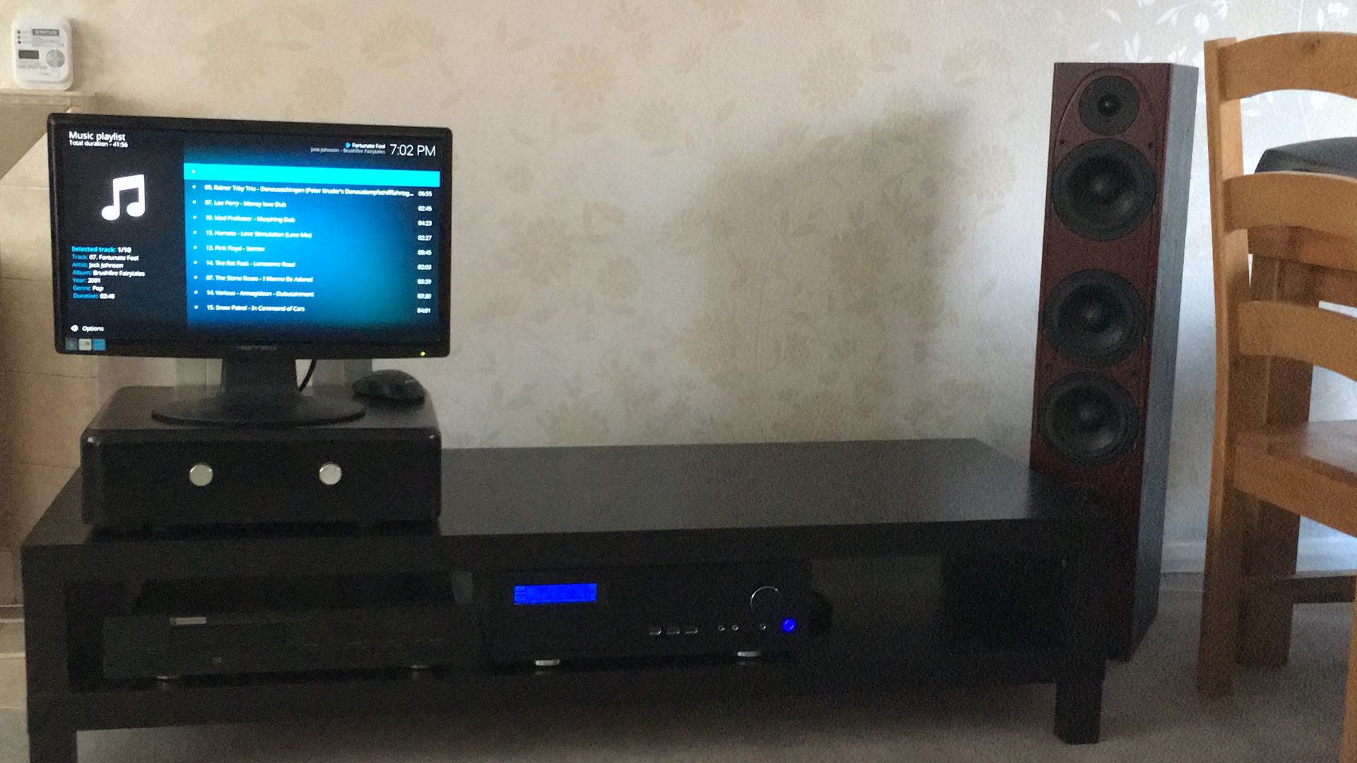

    lol - the sound card i had bought does not fit the motherboard - so that's a non starter - but actually the on board sound is quite impressive so no great shakes
    the main thing i am having issues with is getting the LE to boot from USB reliably
    during setup of LE i selected - the " run" option to run from USB and use the same 8GB USB for storage also
    but the box seems to have a mind of its own - sometimes booting from the USB - sometimes from the HDD - even though i have set the bios for the boot order to be removable drive 1st
    but if i disable the HDD in the boot menu in bios - the box fails to boot at all - and just gives a message saying no operating system found
    also when it does boot from the USB - each time it goes through the LE USB installation menu asking if i want to run/install/ etc
    when i would have thought - once you made a choice - in my case to run from USB - it would remember that setting and skip this step
    can any one shed any light on what the behaviour should be and how i can get it to boot from the USB each time ??
    much appreciated !!
    OK - it worked
    libreelec fired up ok and even found and ran the WIFI card just fine
    good stuff !!!
    i did say it never seems to be a 5minute job for me -
    this time the box was not booting up even to a boot screen - and it seems i had a dead stick of Ram and a few red lights on the motherboard - but once i figured out what the issue was and removed the offending stick of RAM it was OK
    odd that RAM should die in storage - would have expected something with electrolytic capacitors to fail if anything - but it runs fine with 1 stick of 4gb
    having some issues with boot order - even when set to boot from USB first it seems to default to the old xbmc frodo -12.2 on the HDD
    want to use it mainly for music - and have a better sound card to install somewhere
    does anyone know if i can plug that in after installing libreelec - or will it not search for and install drivers for that if plugged in after initial install
    thanks again ! :thumbup:
