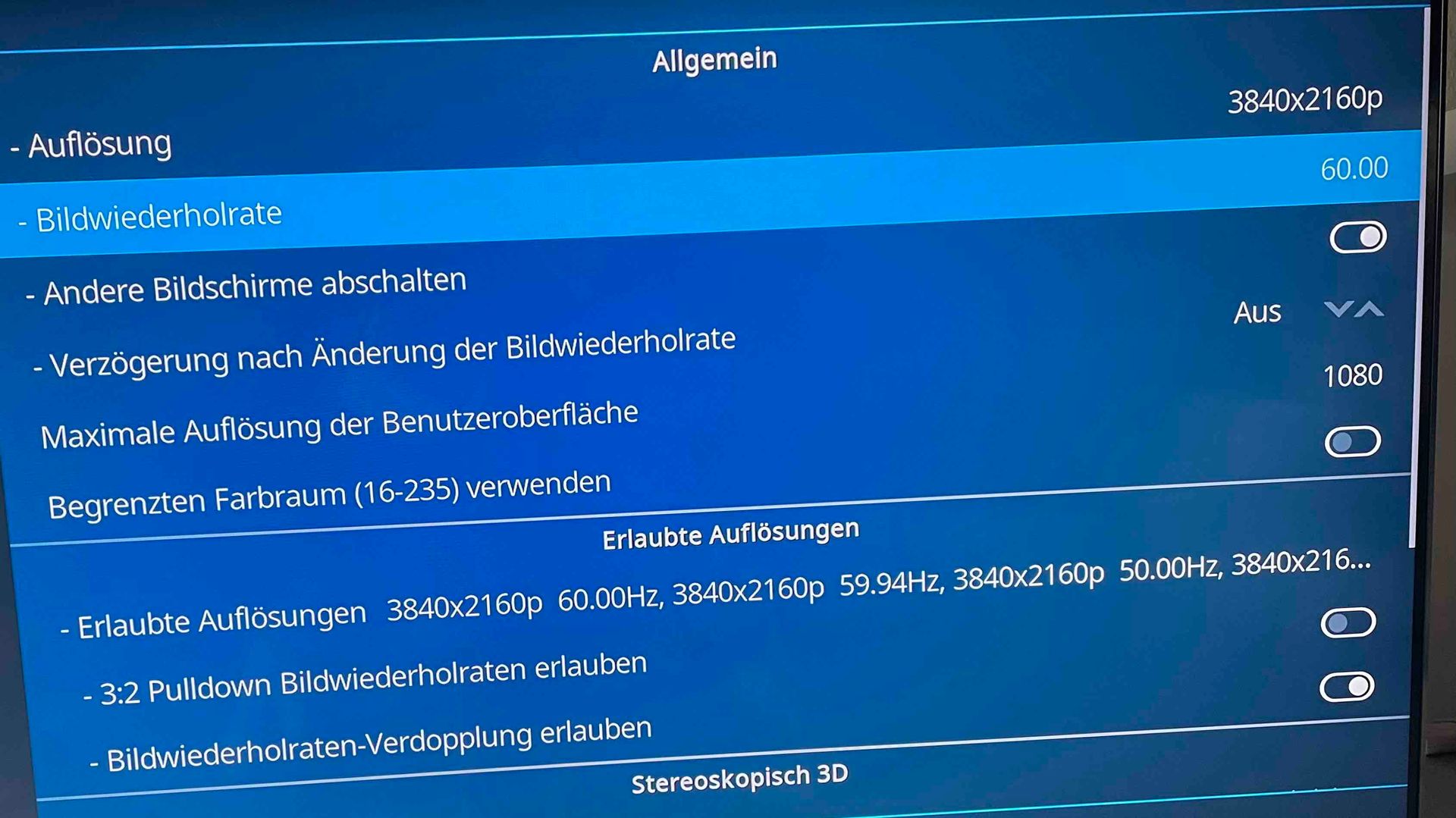

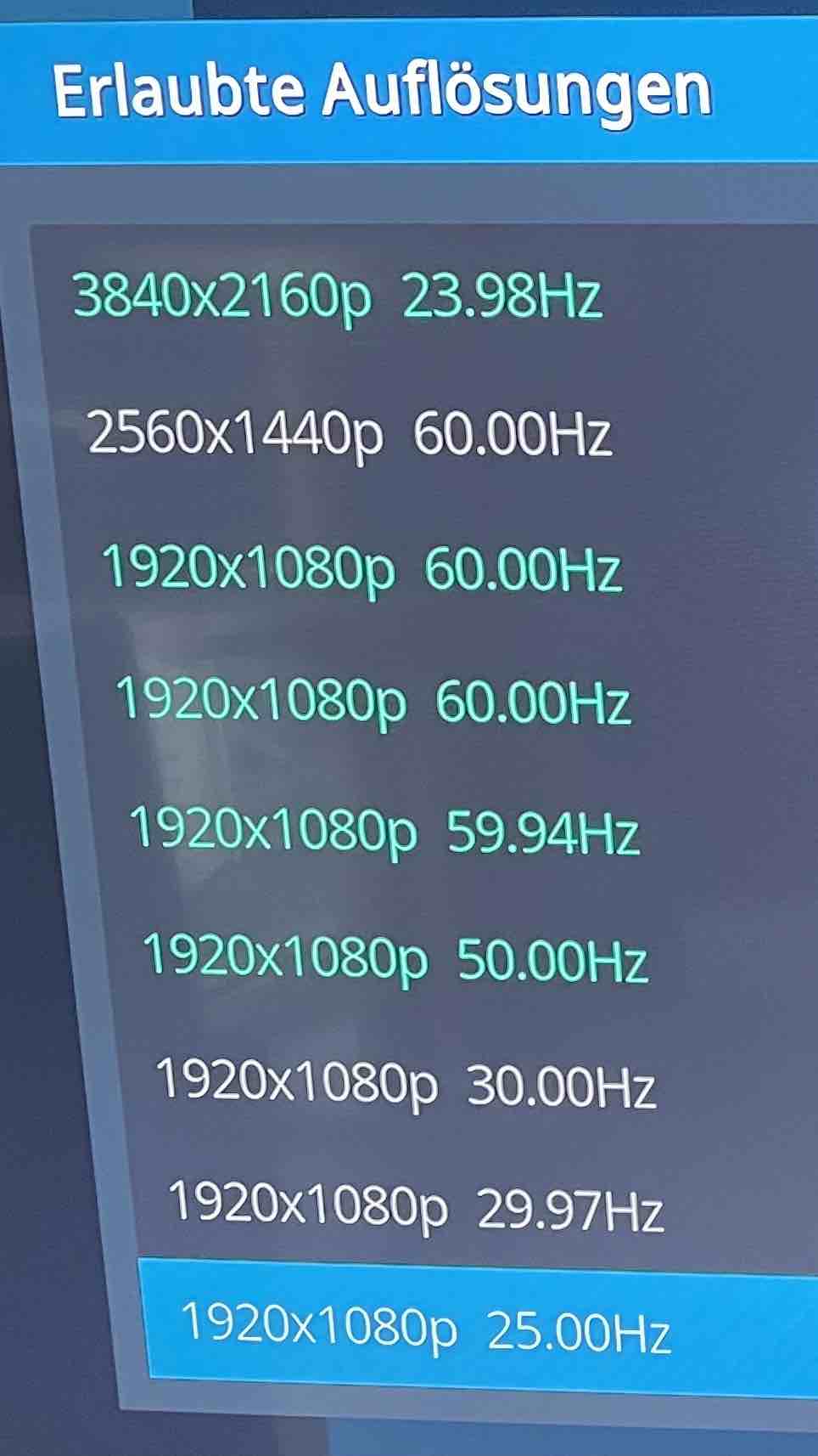

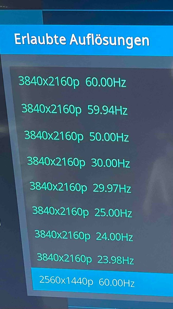

thank you for looking at my problem again. I first adjusted the whitelist (see 2 pictures in the attachment). Then I changed the refresh rate to 60Hz (see attached image). I turned on debugging again, reproduced the error, and uploaded the log: http://ix.io/3SLQ

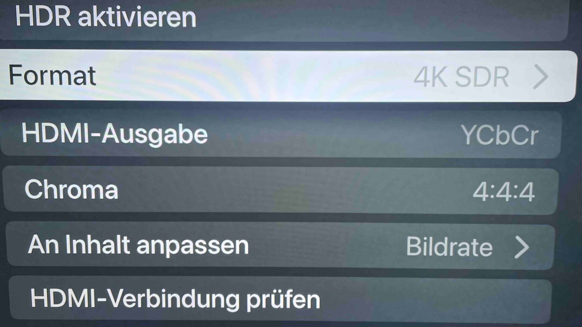

HiassofT AppleTV works with 4:4:4 YCbCr (see attached file).

I installed 10.0.2 over the weekend. I still have problems with the 4kp60. I turned on the switch in the config.txt. Then I set the refresh rate to 60Hz in the settings. That works too and I have a picture. If I turn off the screen and turn it on again after 10 seconds, I no longer get a picture. I only get a picture again after restarting the RPi4. The behavior can be reproduced.
