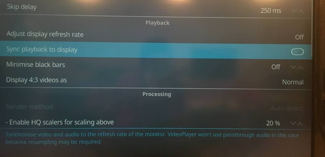

Actually I'm also struggling because of removing "Sync playback to display". Totally all 24fps video is not smooth even when frame rate is set to 24Hz manually. Is there any chance to enabled it in some xml configuration files?

Btw, do you know how to return "Sync playback to display" options which is in the original KODI?
