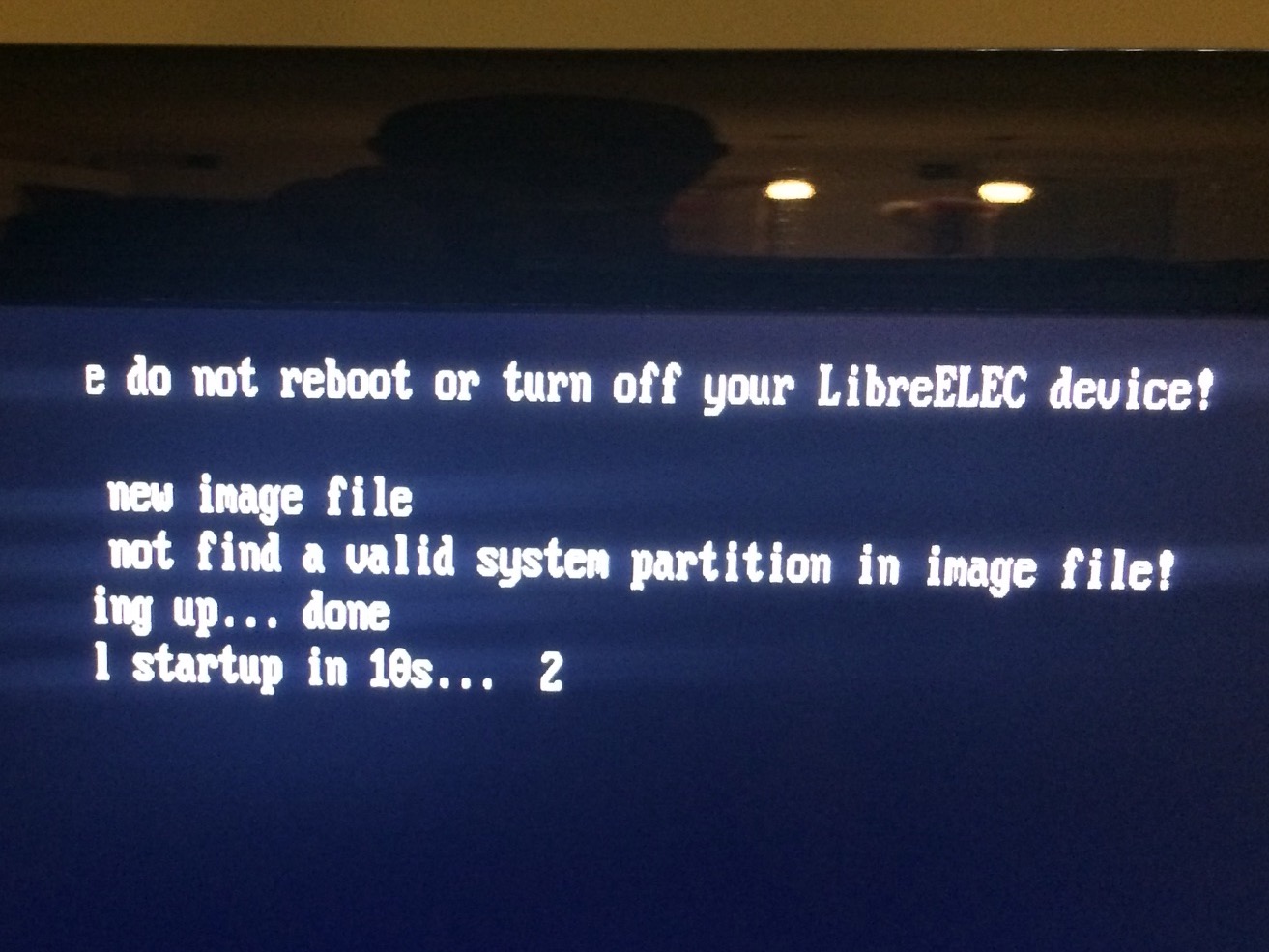

    I need some help please. I'm trying to update my a95x (s905, 1GB/8GB) with the latest development build of 008. I downloaded and renamed to img.gz and dtb.img, put into Update folder via samba access, then reboot and I get an error saying "not find a valid system partition in image file" (see attached photo).
    I'm sure it's a stupid mistake on my part - any help will be much appreciated....

    OK, had no time to play with my A95X (S905 non X, 1GB/8GB) for a few days, but yesterday I had a deeper look nad found that there was something wrong with updating. I made a clean SD install and voila - it works with no problems and passthrough is OK, only wake from standby is shot, but AFAIK this is a Nexbox problem? It seems that putting the update files in the update folder did not update the device tree - maybe I was wrong to put the device tree in the Update folder visible over SMB? Although the device did update to the latest build and erased the update files in the folder. I do have two more questions:
    1. Is it OK if I manually replace device tree on SD card (should be the surest way)? Should I do it before updating to the latest build or after?

    Yes. Actually you don't need a toothpick to boot from SD card again.
    Have you read updating notes carefully and updated your device tree?
    Sorry, maybe I'm a real noob, but is it correct to put the device tree file in the update folder together with the latest build? This is my method, should I do something else? I also tried both gxbb_p200_1G_100M_RealtekWiFi.dtb and gxbb_p200_1G_100M.dtb. I'm running from SD card. Maybe I'm doing something wrong...
