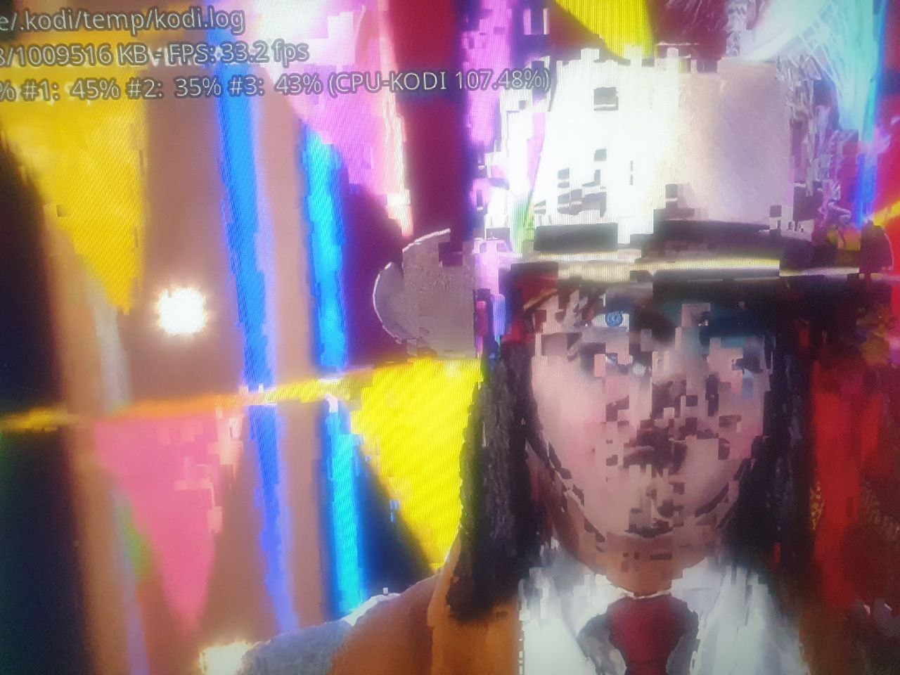

Thank you, it worked for my 'hk1 max' 2GB RAM with 16GB storage model, but one of the issues I have is that it's very slow when playing VP9 at 1080p using the Netflix plugin, and if I enable H264, it flickers.

The attached file flows really well, whether it's VP9 and/or H264 when I use the Netflix plugin at 720p. I'd say it's at a 98% satisfaction level. Also, when I play TVheadend channels, it's improved and not as slow as in version 10. In this version 11, it seems a bit unstable. Another detail I noticed is that in Netflix, if I want to resume a video that I previously switched from VP9 to H264, the TV box restarts. However, sticking to H264, I find it much smoother than before. Thanks.

The Libreelec 11 version works very well either with direct files and WiFi. Additionally, the Star+ plugin runs smoothly for me. However, I have an issue with the Netflix plugin. When I activate VP9, the videos appear slow and the quality doesn't seem to be 720p. The CPU usage goes up to 220%. It seems smoother if I choose H264; however, the range is between 18 to 28 fps and sometimes it plays slowly. The CPU goes up to 350%, it appears smoother, but the image looks washed out and doesn't seem like 720p.

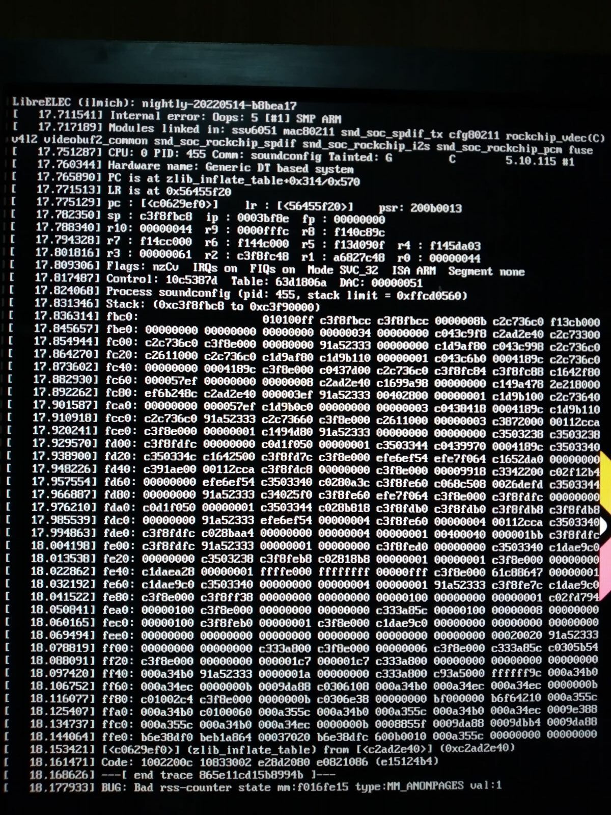

I tried a fix for graphics kernel driver. I have also restored the clocks/voltage of July.
please let me know.

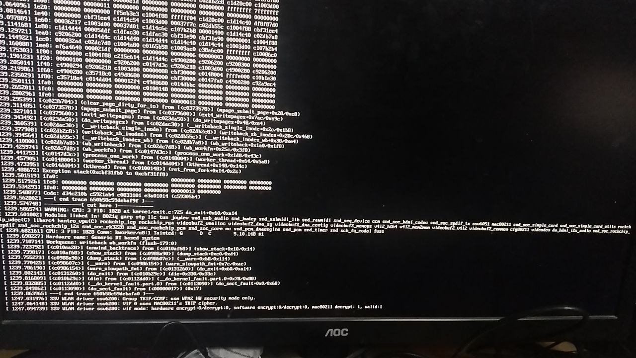

with rk3229-box-v884k in SD it does not let me continue advancing although placing the version with overclock works but after using it it crashed
I was able to run, on my tv box v88 4k but with the dtb "rk3229-box-v884k" it does not start but with "rk3229-box-v884k-ovclk" I was able to install the plugin although I have errors when placed on a black screen
Log rk3229 v88 4k
thanks Ilmich
v88 4k when I update (/update) it tells me a black screen and it does not connect to the network, but if I install it directly from the sd Kodi it closes when I try to complete the steps it restarts and the third time it hangs

markosc, I've updated only the image for v884k and v88mars.. try and let me know
It is curious as much as the previous one and this version when I insert the rj45 cable with the wifi activated automatically I can enter through ssh and the samba share but if I restart the box or it is turned off I will not be able to enter the ssh or samba, I have to repeat the plugging process the rj45 cable
