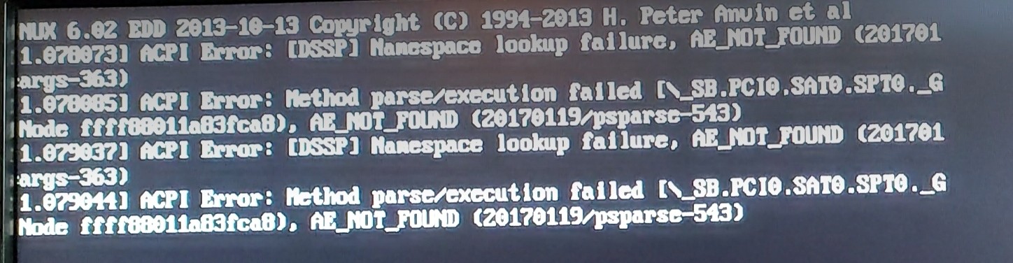

    Yes, there was OpenELEC -> LibreELEC update before, so I tried to change the partition size : I used rufus to create a bootable USB thumbdrive with Gparted Live image on it, but it doesn't boot. I followed this video https://www.youtube.com/watch?v=1E5_tCkzuVQ but when I choose the USB thumbdrive to boot, an error appears for less than a second:
    LE then just boots as normal to 8.2
