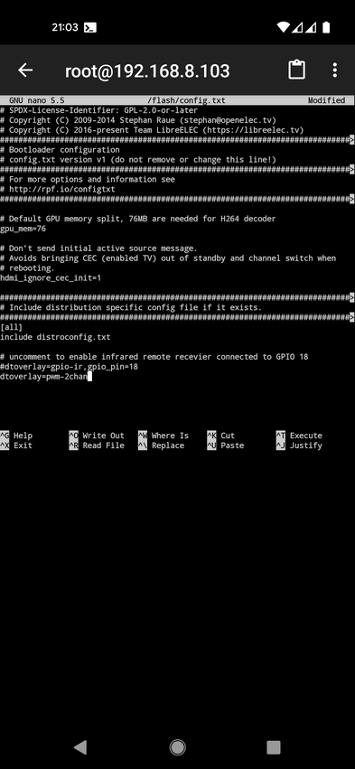

Output channels was already 2. And I tried all devices including MAI PCM without success.
The param did not help, still no HDMI sound.
