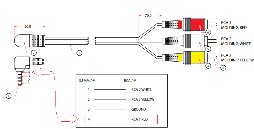

    Hias, Thank you for your time and effort. I am getting better results now. Ok, as noted in my original post, the Red RCA plug buzzes when plugged in? Turns out that the buzzing was the video signal. So when I plug the Red cable into the Video (Yellow) socket of the TV, I got VIDEO but no sound when plugging in the white and yellow into the remaining white and red RCA sockets. So I got out my multimeter to confirm my 4-pole jack and did some research, seems that this is what is the coloring/standard Raspberry PI follows (note pin #4 closest to the body of the jack):
    and this is how my cable is colored (Yellow and Red are swapped):
    So Red plug rather than Yellow for the video signal, no big deal. But any clues as to why I don't get any audio? No audio from Kodi's menu navigation sounds nor when playing a movie. I toned out the other RCA plugs (white and yellow) and ground pin, they all consistent--just minor color difference in Video.
