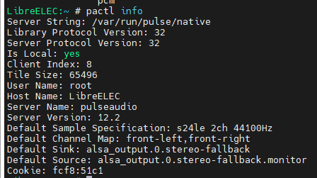

Ok now I am on PulseAudio now and trying to set correctly the quality with my DAC:
I modify daemon.conf as follow:
Codedefault-sample-format = s24le default-sample-rate = 44100 alternate-sample-rate = 96000 default-sample-channels = 2 default-channel-map = front-left,front-right
If I digit
everything looks ok:

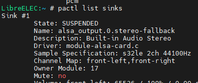

but if I digit:
pactl list sinks
I have the following:
Same for pact list sources where I have 32 bit.
Why in the sinks the bit are 32 when I set 24 on the daemon.conf?
