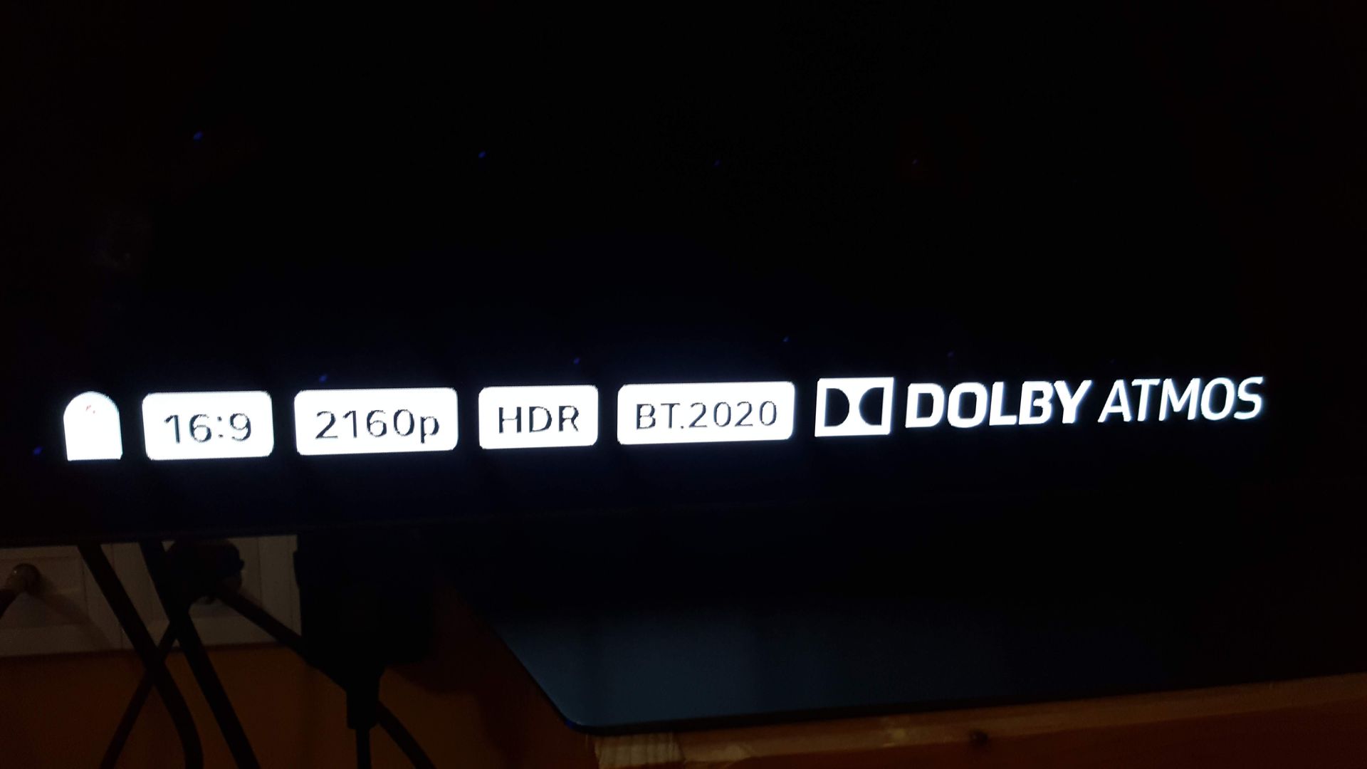

In principle, I manage to fix the audio passthrough issue:
The TrueHD/Atmos works now, but please give it a try too, because I cannot test DTS-HD on my TV.
Hi dtech,
wow that was very fast!
Tested it and all 3D sound formats (DTS-X, Atmos, Auro 3D) work now.
Thank you very much for the quick solution and your effort

Hello and thank you for your quick reply and your work.
Yes, the sound is output via HDMI to my Marantz receiver. I had previously installed another build and there it ran without problems. I even flashed back to my old system (the output of the HD sound like Atmos/DTS-X worked again) and then re-installed your image which again led to the fact that the HD sound formats no longer worked.
As I said, I only get a short loud creak. When I disable passtrough again, I get the sound in PCM format.
I also have an LG OLED (the C9 which supports DTS-HD as well as Atmos). I will test later if it works when I connect the K1 Pro box directly to the TV and pass the sound via eARC.
