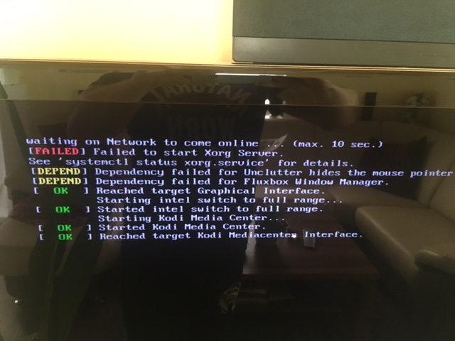

I've the same "nvidia" issue with the latest 8.0.2 LE... In Milhouse nightlies with 18.x no problem

Try "rm /var/run/xorg-configure.done && /usr/lib/xorg/xorg-configure nvidia-legacy" in /storage/.config/autostart.sh.This works! Thanks!
I get this messages after upgrading to the newest version :s
