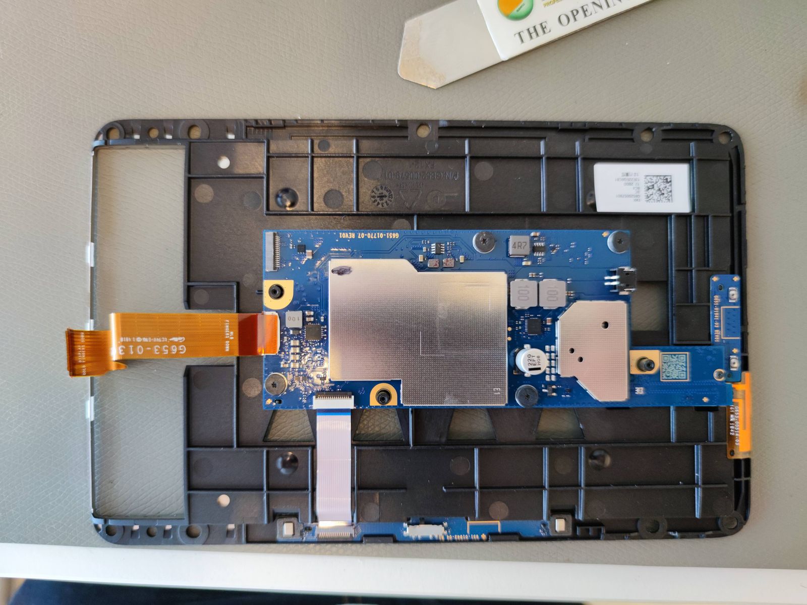

    The pcb viewed from the backside of the device. Notice the two wires next to the pink heat gum stuff. That's my RX and TX(?). Two pins next to each other seemed like a logical attempt.
    So i teared the device down, got to the PCB and found a RX/TX port. At least, i noticed that i got uart data when connecting to it. But, i can only read, it does not respond to keyboard presses. I don't know if the other pin is just no TX pin or that there is no software that will respond to keypresses.
    My question, what else can i try, or did Google just lock it's hard-/software very well? Of course i could chip-off the NAND chip, but then reflowing it on the device after altering the NAND is almost impossible, especially if you have to do it a lot of times... What else can i do?
