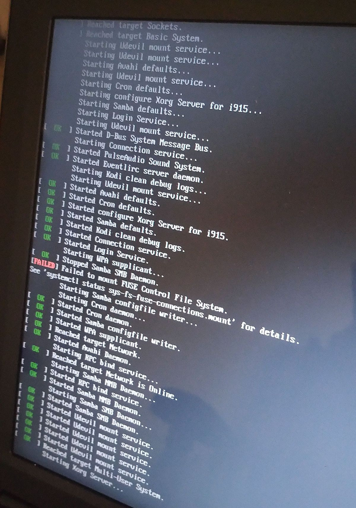

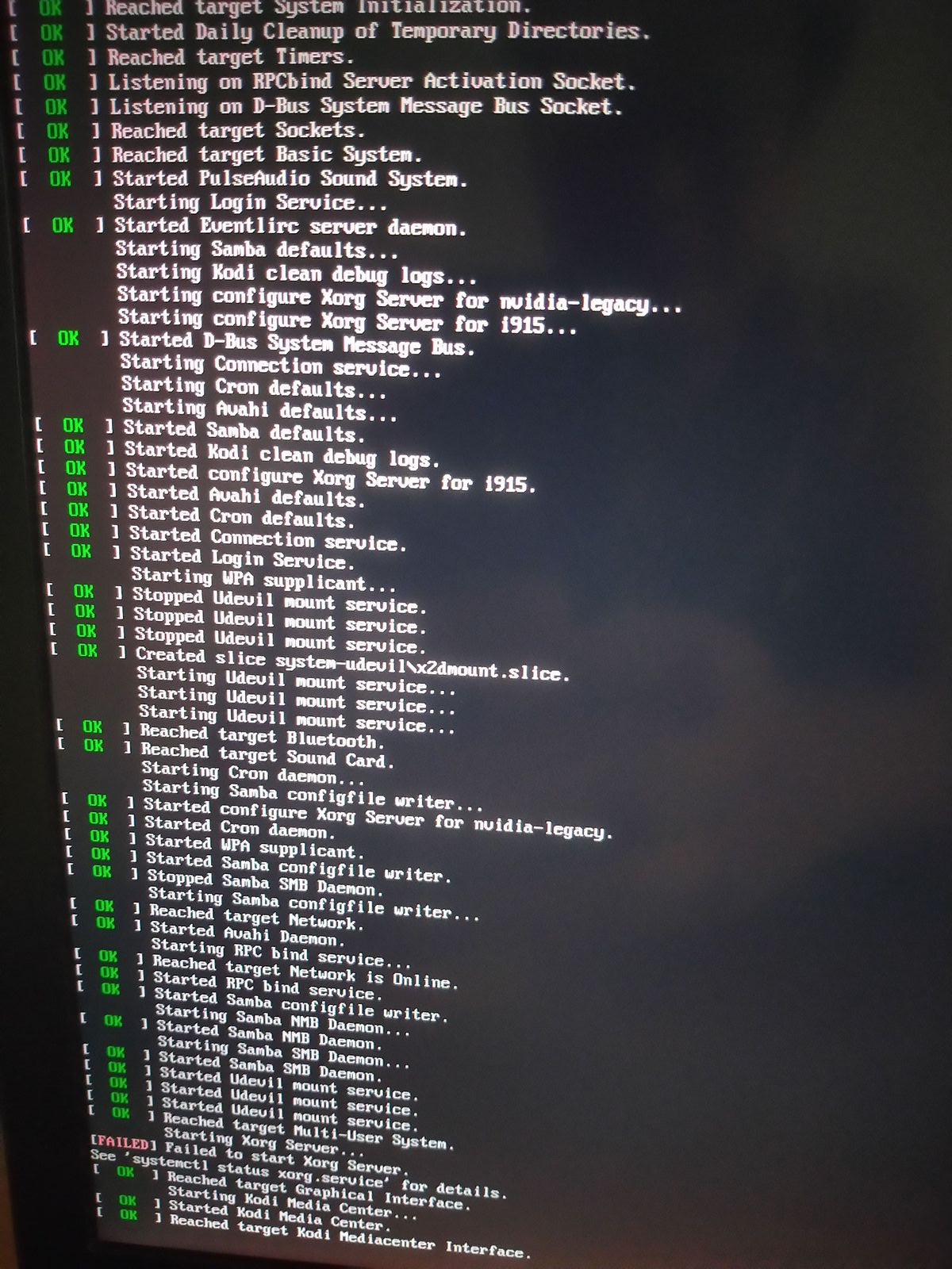

    I compared the log of LibreELEC and OE5.0.8, they both detected Intel 915GM. The difference is LibreELEC has the following trouble:
    Sep 14 00:37:53 LibreELEC xorg-launch[563]: Current version of pixman: 0.34.0
    Sep 14 00:37:53 LibreELEC xorg-launch[563]:         Before reporting problems, check http://wiki.x.org
    Sep 14 00:37:53 LibreELEC xorg-launch[563]:         to make sure that you have the latest version.
    Sep 14 00:37:53 LibreELEC xorg-launch[563]: Markers: (--) probed, (**) from config file, (==) default setting,
    Sep 14 00:37:53 LibreELEC xorg-launch[563]:         (++) from command line, (!!) notice, (II) informational,
    Sep 14 00:37:53 LibreELEC xorg-launch[563]:         (WW) warning, (EE) error, (NI) not implemented, (??) unknown.
    Sep 14 00:37:53 LibreELEC xorg-launch[563]: (==) Log file: "/var/log/Xorg.0.log", Time: Tue Sep 14 00:37:53 2021
    Sep 14 00:37:53 LibreELEC xorg-launch[563]: (==) Using system config directory "/usr/share/X11/xorg.conf.d"
    Sep 14 00:37:53 LibreELEC xorg-launch[563]: gbm: failed to open any driver (search paths /usr/lib/dri)
    Sep 14 00:37:53 LibreELEC xorg-launch[563]: gbm: Last dlopen error: /usr/lib/dri/i915_dri.so: cannot open shared object file: No such file or directory
    It seems LibreELEC can't find driver file in the specific dir. It's not whether driver is correct, instead, it's the driver does not exist. I will check file structure of LibreELEC on laptop and report.

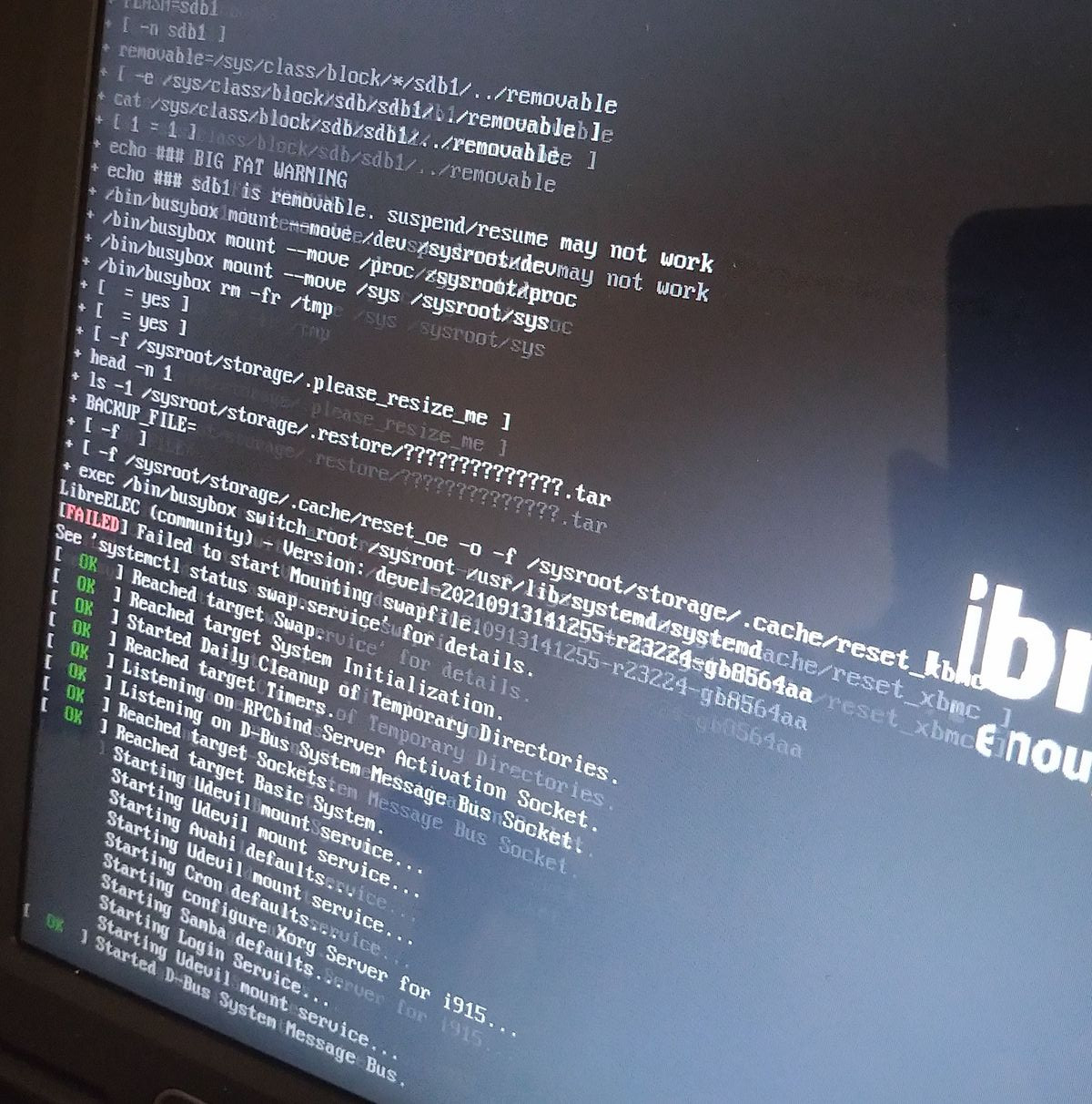

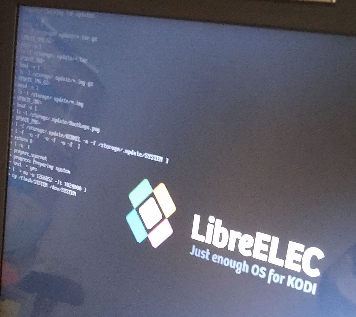

    I got it. The command I ran was "PROJECT=Generic ARCH=i386 make release". Now I run "PROJECT=Generic ARCH=i386 make image" and I got a "LibreELEC-Generic.i386-7.0-devel-20210913141255-r23224-gb8564aa.img.gz".

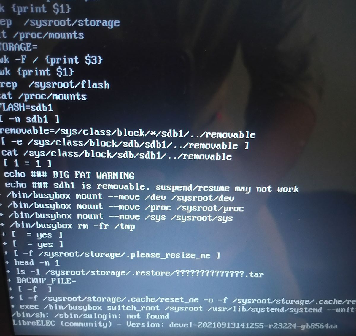

    I tried it on my old laptop. I saw LibreELEC logo screen, then the screen turned to black and stuck there forever. The CAPS Lock key is responsive.
    I looked the IP assignment in my router, LibreELEC got an IP. I tried to SSH, but connection was refused immediately, not waiting for some time and no response.
    I tried the same SD card on a newer laptop with x64 CPU. The screen stuck as the following image. SSH also got refused immediately.
