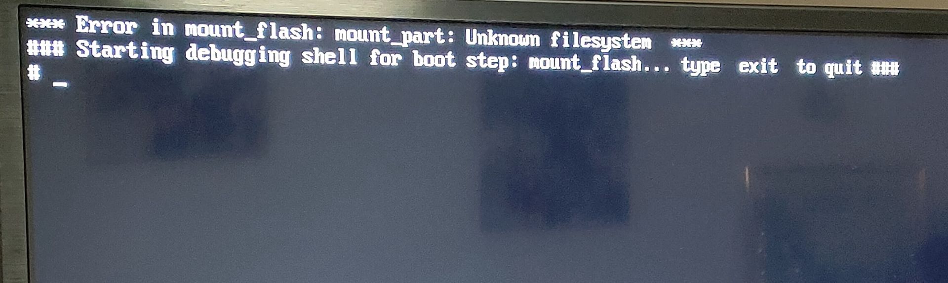

Based on the photo you sent, I would suspect the SD card in the first round.
Try rewriting the image, and if the situation doesn't change, try another SD card.
One more thing:
Be sure to use the toothpick method because aml_autoscript has changed since the previous version.
Thanks, I have tried both img. The 9.2.8 It works for me but fatally, it freezes everything over and over again, like an hour I was trying and nothing, it does not let me install in the internal memory by ssh.
The 9.2.8.2 it only shows an error screen and nothing else, like an hour trying and nothing ...
And of course, when doing all this the internal memory is screwed up, I don't know why. So I have returned to the 18.6 kodi img above that works fine (although only for h264 Bluray 1080p) and that I install in just 5 minutes on the internal one.
