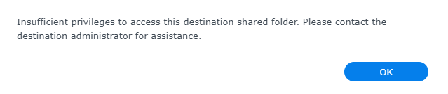

    After selecting the rsync sources for backup I need to save the configuration and I should be able to run the first test.
    But unfortunately after pressing the save button and error message appears ...
    "Insufficient privileges to access this destination shared folder. Please contact the destination administrator for assistance"
    This is due the fact that the rsync process will create the destination share and store its rsync notes (synobkpinfo.db) inside.
    Again .. all the same in LE 9.2.6 (working) and LE 10.0 (not working).
    The issue is reproduceable on any system for me ...
    Cheers
