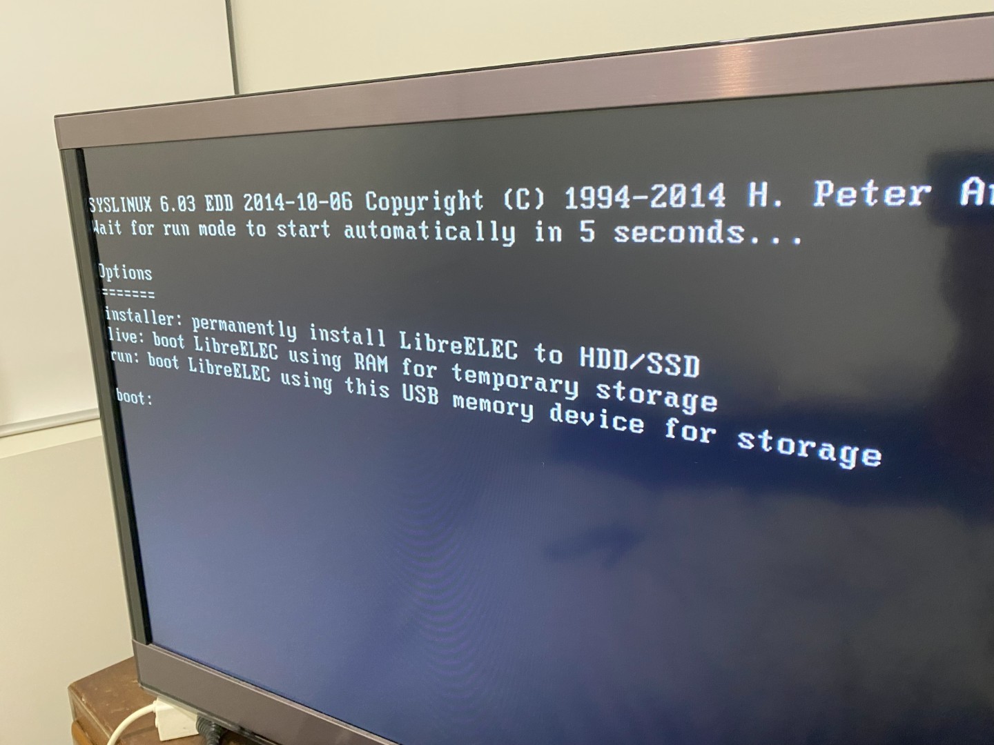

Thanks ,but there is no log file in the root at all.. maybe that's a clue ? lol
black screen after this screen:
I changed the drive just in case same thing ,but in legacy mode I'm getting now fs-resize.log any idea?

Spent hours but no go.intel i5-6400 on MB Asus B150M-K , latest firmware,secure boot disable ,with uefi or bios - cant go passed the initial install screen.
Using sandisk extreme USB to install on Kingston ssd (using live USB also doesnt work)
I managed to live boot ubuntu but only using (safe graphics) option -anything I can do?
