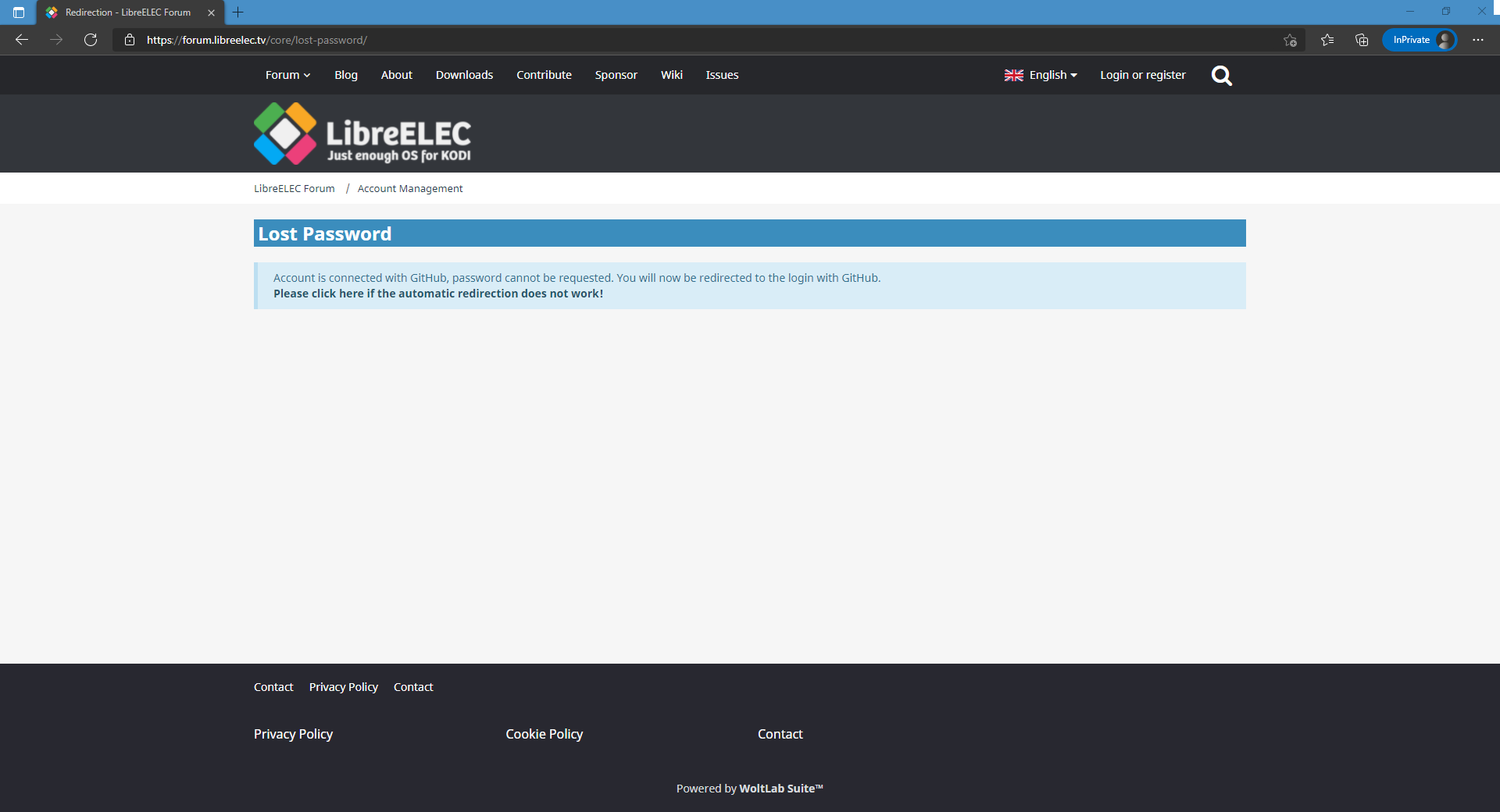

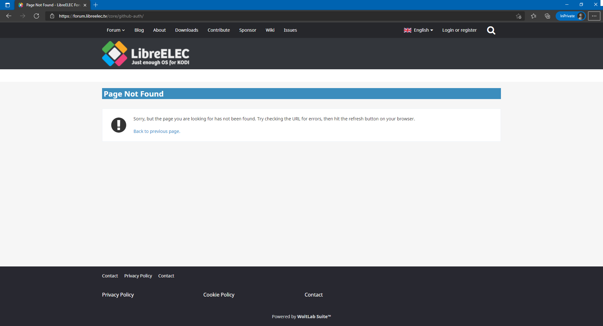

    I have been trying to recover a password I forgot for my initial account on this forum, but there is an issue.
    After I enter my username (or email attached to that account - the behavior is the same with both), I see the message from Picture 1. After a few seconds, the one from Picture 2.
    Please look into it.
