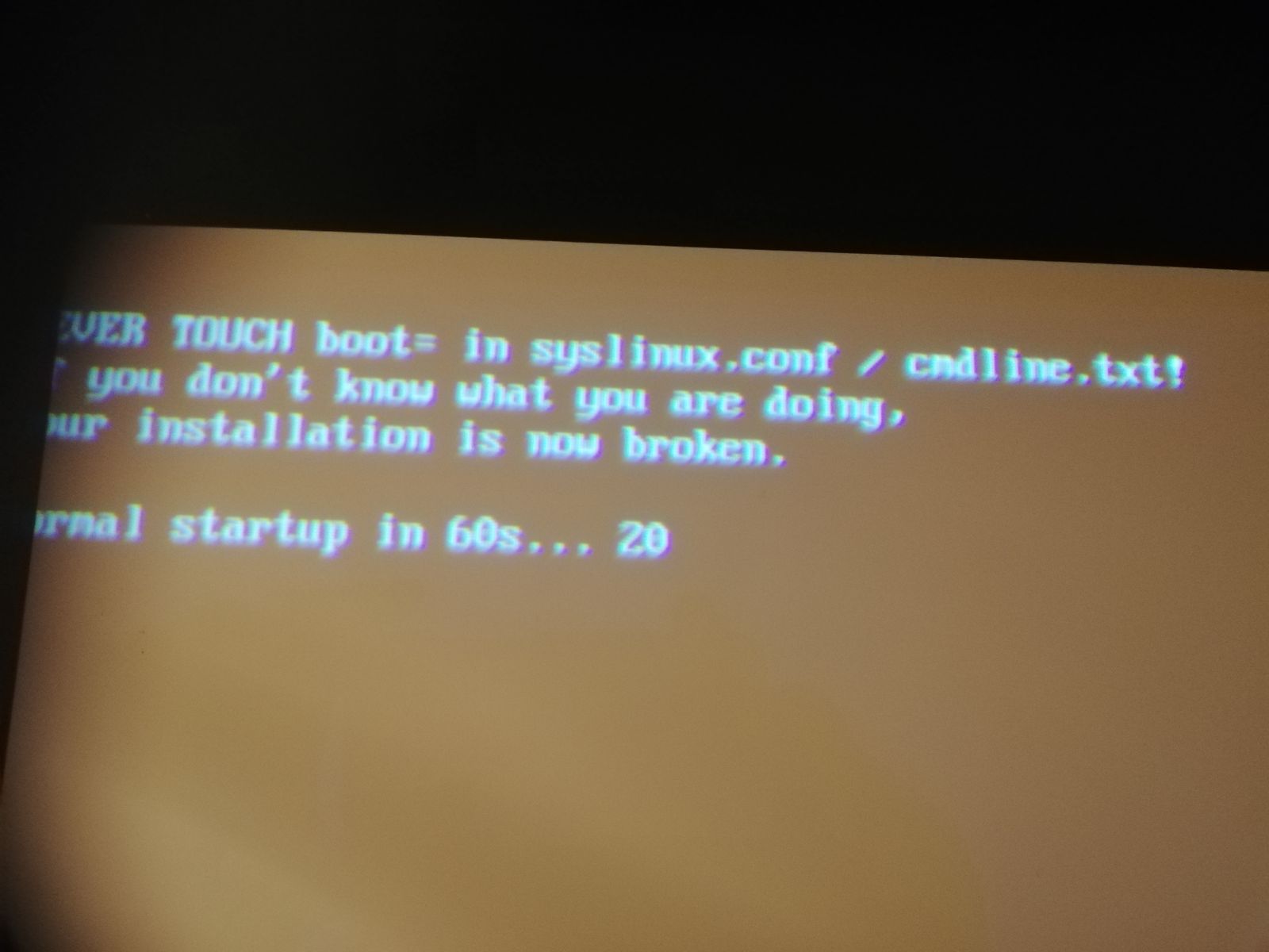

i have also test this on linux mint. if i connect the sdcard from the rpi2 with the usb port, then i can access the storage folder and i see the .update folder - i had placed the librelec update tar file into the .update folder and reboot the rpi2 with the sdcard. a error message appears that the file in the .update folder is corrupted and the boot process will be continued with the installed version. i know the file is not corrupted and i can open it on pc.
Or unpack the .tar file and simply overwrite the boot files in the first partition which is VFAT and readable on all OS.
Its not simple. i have copied the files from the tar file to the sdcard (one to one replaced), but if i start the rpi2 this error message appers.
do you really test this procedure or what i have missed to do?

you are right. the cmdline.txt was wrong.
i have -restarted the configuration procedure
first i had deleted the wrong entries (this was the default entry for my rpi2)
LibreELEC:~ # cat /flash/cmdline.txt
boot=UUID=1107-2955 disk=UUID=27ea94ba-c897-4e07-942f-594aaf01c537 quiet
then i had recreated the edid file
LibreELEC:~ # getedid create
successfully installed edid override for HDMI-A-1
after that the cmdline was modified by the getedid command
boot=UUID=1107-2955 disk=UUID=27ea94ba-c897-4e07-942f-594aaf01c537 quiet drm.edid_firmware=HDMI-A-1:edid/edid-HDMI-A-1.bin video=HDMI-A-1:D
LibreELEC:~ # ls -l /flash/edid.cpio
-rwxr-xr-x 1 root root 1028 Jul 31 18:09 /flash/edid.cpio
after that i had rebootet the rpi2 with the hdmi-converter - the video output works now. thank you for your support. ![]()
