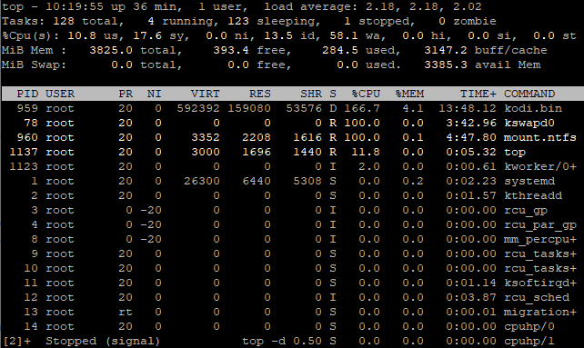

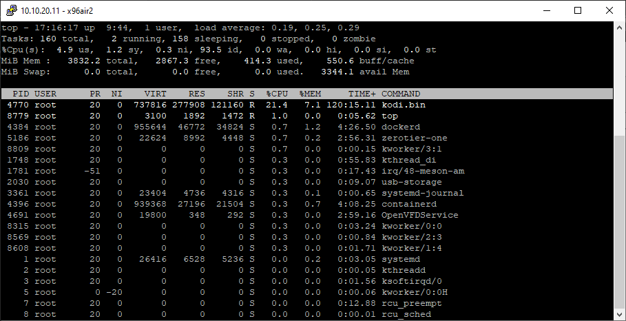

    I see very strange the little amount of free memory (393.4 / 3825.0 MB on your device - 2867.3 / 3832.2 MB on my device). This may be a good reason for your device to be slow. If I know more I would try to find some addon or kodi settings responsible for this.
    Actually, top reports 2867MB free and also Kodi itself never reports more than 750MB to be in use.

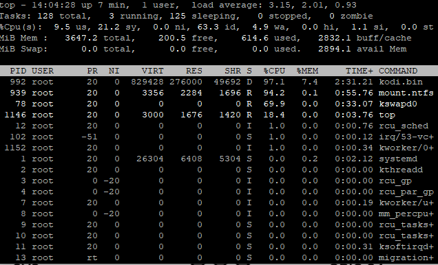

    I'm running LibreElec 10.0 beta (9.95.4) on a Raspberry Pi4b (4GB). My goal is to watch 4k dumps with audio passthrough (7.1) for all available formats to an AVR. Movies are streamed from an external HDD (NTFS) which is connected to a USB 3.0 port.
    To get some stable playback performance, I overclocked the CPU to 2300 MHz and the GPU to 750 MHz (the following problem is not tied to the overclock though, as it also occurs with stock clock values). This works greatly when booting freshly into the system. Video playback is smooth. However, after a few minutes the picture starts to lag behind the sound. First this only looks like minor lags: video micro-pausing, followed by sped up video playback where the player tries to run through the frames to catch up with the audio. This gets so bad over time that videos become unwatchable and a buffering ring is displayed every few seconds. Ultimately, total "CPU-KODI" usage just creeps higher and higher until it persistently reaches 100+%.
    I SSHed into the system and monitored system usage with top. I realized that mount.ntfs and kswapd0 would hit 100% CPU usage every time the lag occurred (see attached screenshot). The timespan between those spikes becomes shorter and shorter over time.
    Going by top, no swapping seems to be actually taking place (MiB Swap = 0.0). Also, reported memory usage by Kodi never exceeds 750MB. Is there anything I can do on my end to prevent those spikes in CPU usage as a workaround? My first idea was to reformat the external HDD to a Linux-compatible format, but that would break compatibility with my TV and other devices. The other obvious solution seems to be to deactivate the swapping service. Although I think that I have enough RAM available to not require swapping, this seems to be not advisable by the sources I found. But may be those spikes are just the symptom of an underlying problem.
