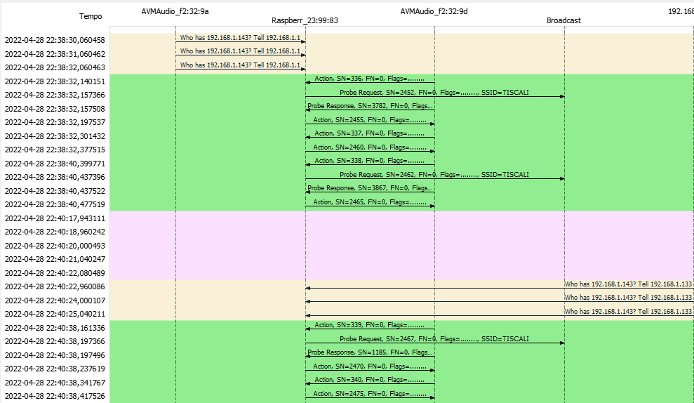

    I have taken some pcaps from my router, to see what's going on.
    What I see is that, all of a sudden, while the WiFi is still active, 802.11 packets between the router and the rpi4 are sent and received and the IP address is maintained (so, apparently, it's all good), nobody can get an ARP answer from the rpi4. The router tries, the other raspberry tries, with no success.
    It all starts at 22:38, when the capture begins and I try to connect to my NFS server. At 22:41 the vpn service detects something is wrong and connmand tears down the routes, but the WiFi gets disconnected only at 22:47. As soon as it reconnects, ARP tables are correctly populated and everything is back to normal.
    Here you see the router sending an ARP request to the RPI4, getting no answer. Also the other Raspberry tries, with no luck

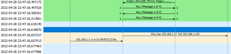

    Wifi gets disconnected at 22:47 and the rpi4 reconnects, ARP is populated
    At this point in time, the NAS (.120) is also discovered and I can start watching the TV program (10 minutes after my initial atrempt)
    So it looks like the WiFi is up but ARP requests fail, how can it be? And how could I write a script that manually tears WiFi down and up if I see something like that?

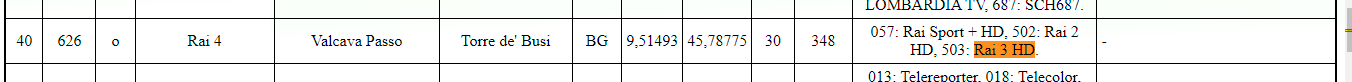

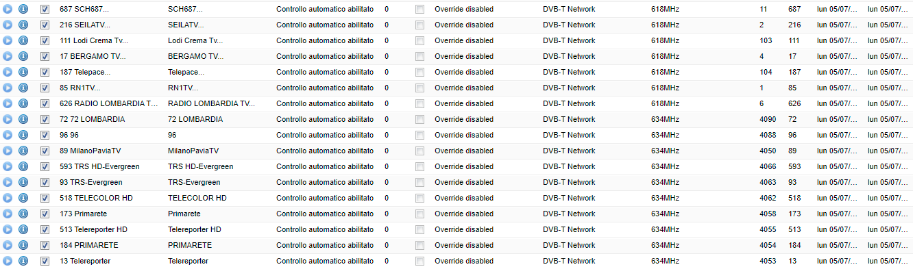

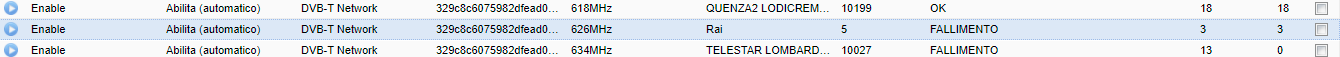

    The problem is that TVH couldn't find the TV channels I was looking for. There is a mux at 626Mhz, where TVH could see 3 services but these weren't mapped to any channels. Here below, what I should get from 626Mhz
    As you see, TVH sees the mux, scan is OK, 4 services are found (why 4?), 0 are mapped to a channel
    If I go to the services tab, though, I do not see anything under the 626Mhz
    This means that I cannot record anything from Rai3 because I just cannot find it.
    I played quite a lot of time with the configuration but I couldn't do anything to solve the issue.

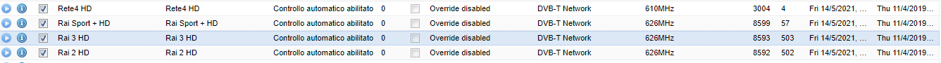

    I then uninstalled TVH 4.3.3 (also because the TV scans always stopped at 97%) and installed TVH 4.2.x. In this case, TV scan reached 100% but I couldn't find Rai3 either, so I gave up.
    I saved the image and went back to LE9 (dd took around 5 hours!) and this morning I run it again. I had forgotten the TVH Server GUI password, but after some research I have discovered it is uuencoded in the passwd folder, so I could enter it again.
    I did found Rai3 HD this time, I see the services and the channels, I see the EPG, I can watch the channel. Strange thing is that the mux scan shows "FAILURE"
    Anyhow, I see the channels (all the three services which are Rai2 HD, Rai3 HD and RaiSport+) and I can watch them.
