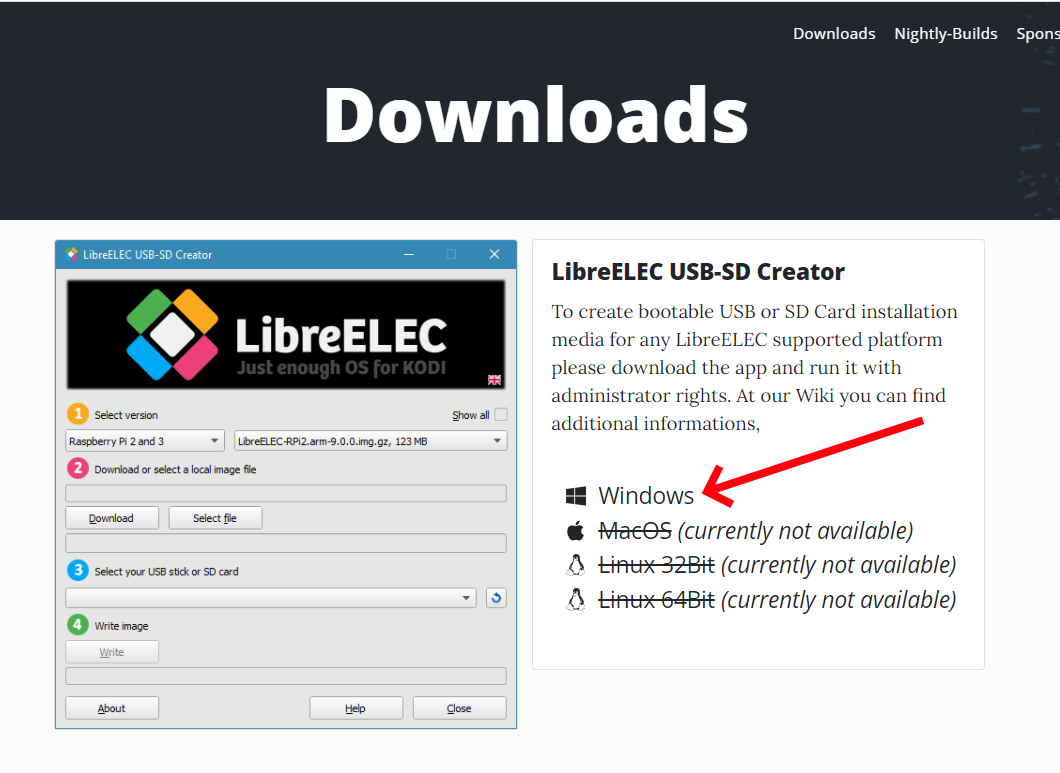

Anyone who can read has a clear advantage, I totally skipped reading it, I only paid attention to the crossed out os... Thanks for the tip

Good morning, does it really matter whether my SD card is formatted with FAT32 or NTFS before I write an image to it?
Thanks and have a nice day. -
Good morning, can you roughly say when the USB SD Creator will work again?
