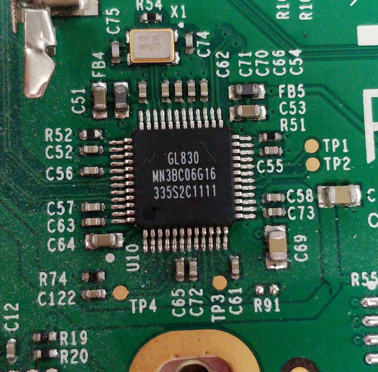

    no, just direct to the Slice USB. interestingly i've just bought this: StarTech.com SATA to USB Cable - USB 3.0 to 2.5” SATA: Amazon.co.uk: Electronics, and it doesn't work with my 4TB drive (in Slice or Windows machine).
    The USB > Sata cable that does work only draws 0.3A with the 4TB drive, so i'm going to backtrack and say its the Slice's USB > SATA chip that's the issue.

    how does the onboard sata port work? i had assumed there was a built-in USB > Sata adaptor?
    I wonder if it's a power issue? i think i remember there being some concern over drive compatibility during the Kickstarter but i can't find this noted online anymore.
