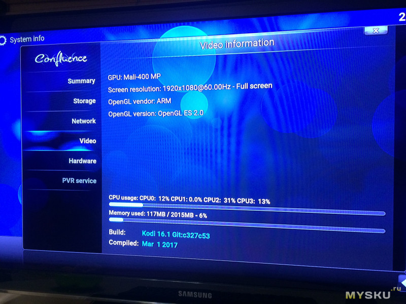

    Thanks for reply, but as I see the review (link in Russian is here Обзор купленного на Aliexpress одноплатного ПЭКА Orange Pi Plus 2E, созданного с учетом пожеланий сообщества Armbian и тест LibreELEC Kodi) - it shows that LE compiled on Mar 1, 2017 is on the screen. With KODI 16. That's why I guess it was older releases.
    Maybe my Chenise 2E board is not the same as official one, and this is the cause of my problems? My Pi 2E is from Aliexpress.
