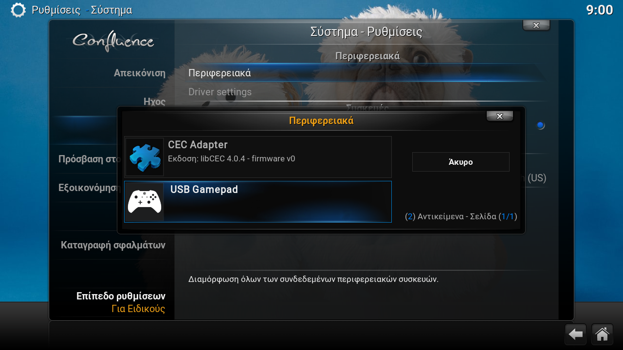

    Any idea on how to make this gamepad work on the all black mxq? It works fine on the pc (tested only on windows' built in app for checking the controllers) and it does show up inside kodi as you can see on the image below, but nothing happens when pressing the arrows/keys/joysticks. I have tried connecting it on all 4 usbs and changing its driver from linux to udev.
    I have also tried an older, and better, gamepad from spartangear, which worked first try.
    [  305.188133@0] Indeed it is in host mode hprt0 = 00041901
    [  305.390771@0] usb 2-1: New USB device found, idVendor=0810, idProduct=0001
    [  305.390787@0] usb 2-1: New USB device strings: Mfr=0, Product=2, SerialNumber=0
    [  305.390794@0] usb 2-1: Product:  USB Gamepad
    [  305.421210@0] input:  USB Gamepad           as /devices/lm0/usb2/2-1/2-1:1.0/input/input2
    [  305.433236@0] pantherlord 0003:0810:0001.0001: input,hidraw0: USB HID v1.10 Joystick [ USB Gamepad          ] on usb-lm0-1/input0
    [  305.433304@0] pantherlord 0003:0810:0001.0001: Force feedback for PantherLord/GreenAsia devices by Anssi Hannula <[email protected]>
