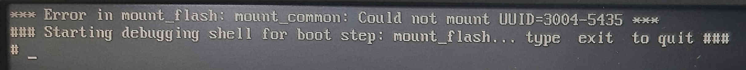

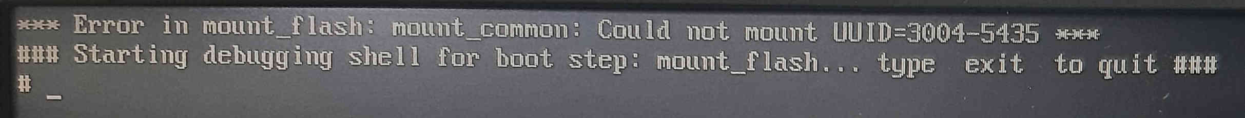

    I did some more researches and found the "mount_flash" (from second error message above) in scripts for busybox.
    That means to me, that the boot-master (who is it?) already accessed the emmc and read the SYSTEM and KERNEL files and executed KERNEL.
    Is that right?
    But then I don't understand the error-message. The shorter UUID is from the tiny FAT partition, where KERNEL and SYSTEM reside. If they are already active, what could be the problem?
    I did some tests and when I boot from sdcard, I have no problem mount the partitions from emmc.
    so I stil have a big gap in understanding.

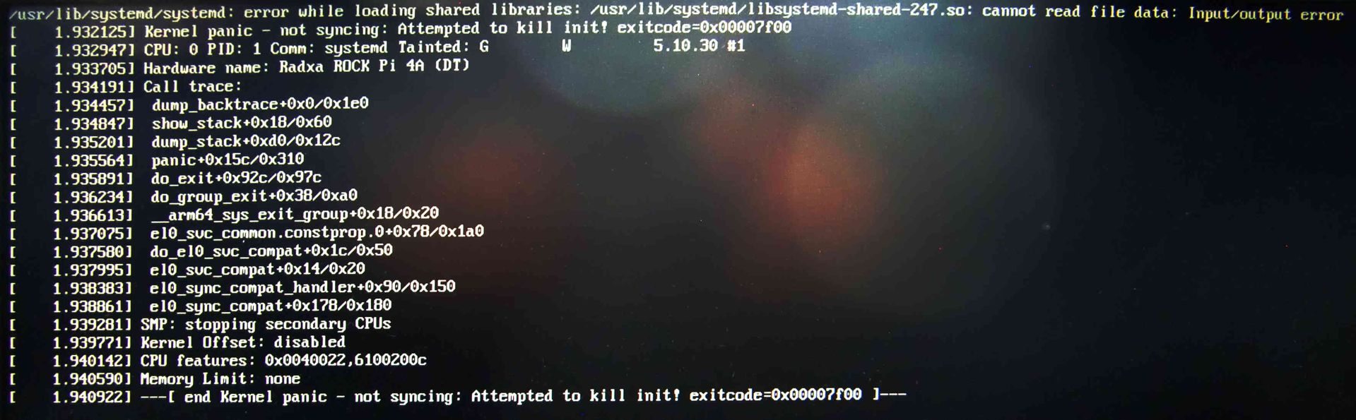

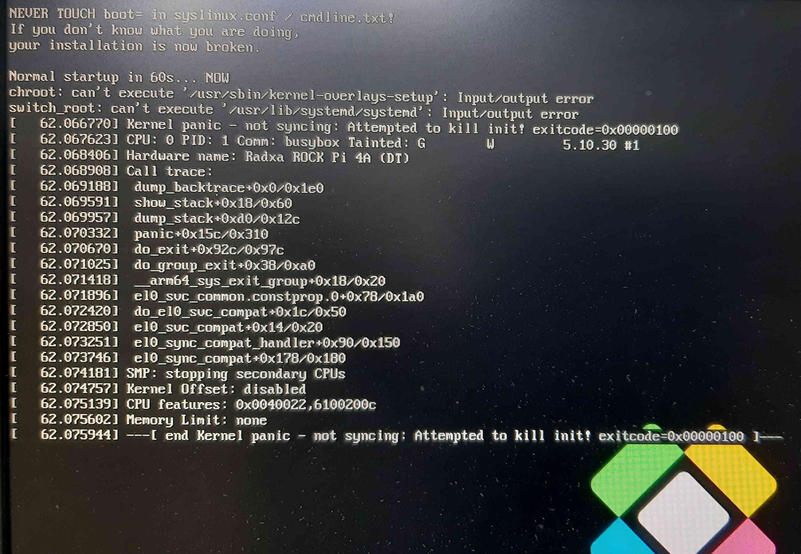

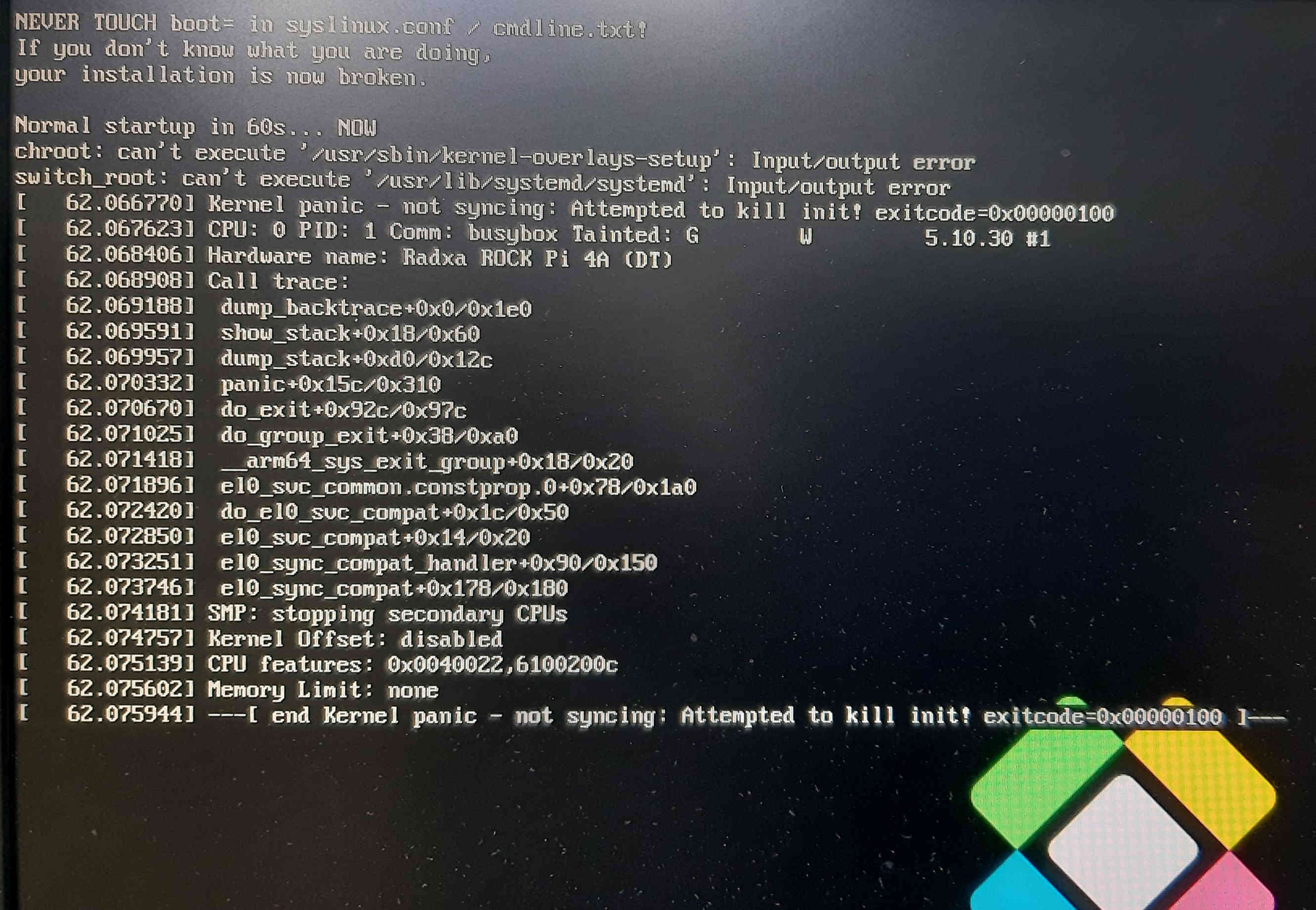

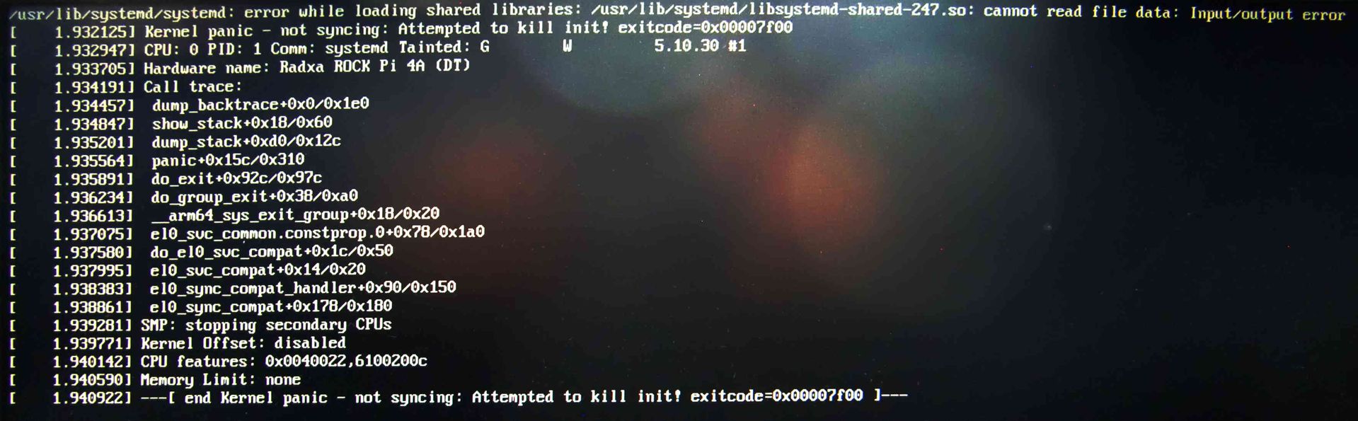

    ... but the pi does not boot from emmc card. First I tried the self built image with my changes and got these errors:
    Then I thought: may be I made a mistake on image creation and tried a nightly image, which leaded to this output:
