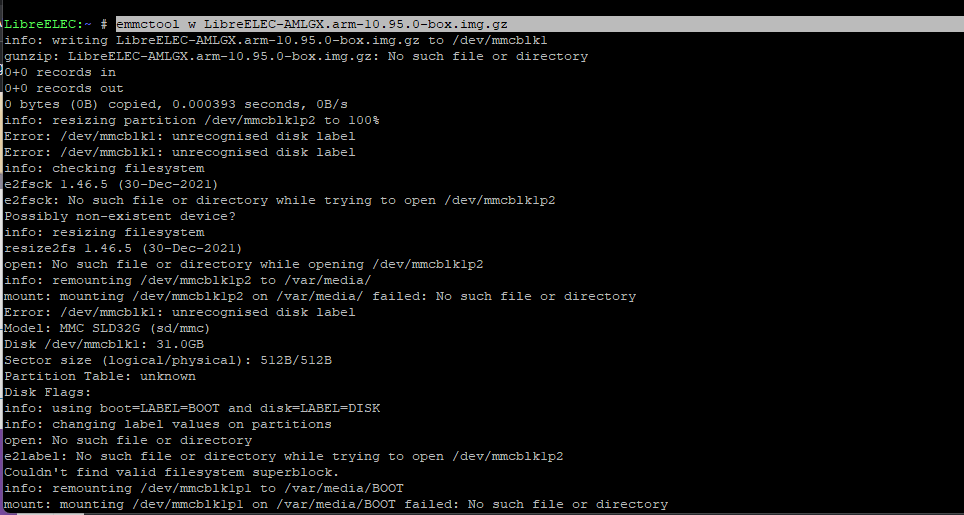

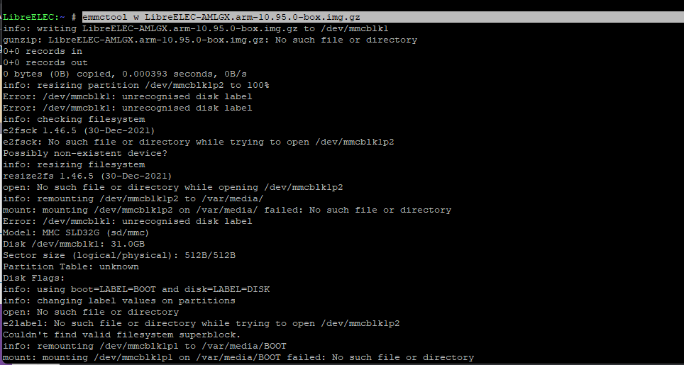

    Re-reading the original screenshot: You ran emmctool without actually having the AMLGX file to write on the /storage partition so it's errored and written no data to the device. Hence boot has still worked. If the box boots; that's where advice stops because I have no interest in wading into the shitfest of atetmpting support for internal installs on hardware I don't have. I've deleted the GT1 image from my test share.

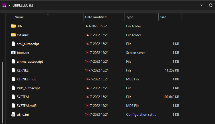

    Sorry, if i was not fully clear but the image is working if you add the meson-gxm-gt1-ultimate.dtb file to the dtb folder in the root in the SD Card:
    Ik pick the dtb folder from the LibreELEC-AMLGX.arm-10.95.0-box.img and added the you dtb file to that folder.

    I tried : emmctool w LibreELEC-AMLGX.arm-10.85.0-beelink-gt1.img trough ssh.
    Many thx for all the work.
    chewitt Did not know that the box image is not capable of booting from eMMC storage. Is that also why i could not update it within libeelec to 10.95.0?
    The box is still booting without any issues i could not send the whole error message so maybe that is why it is still booting.
