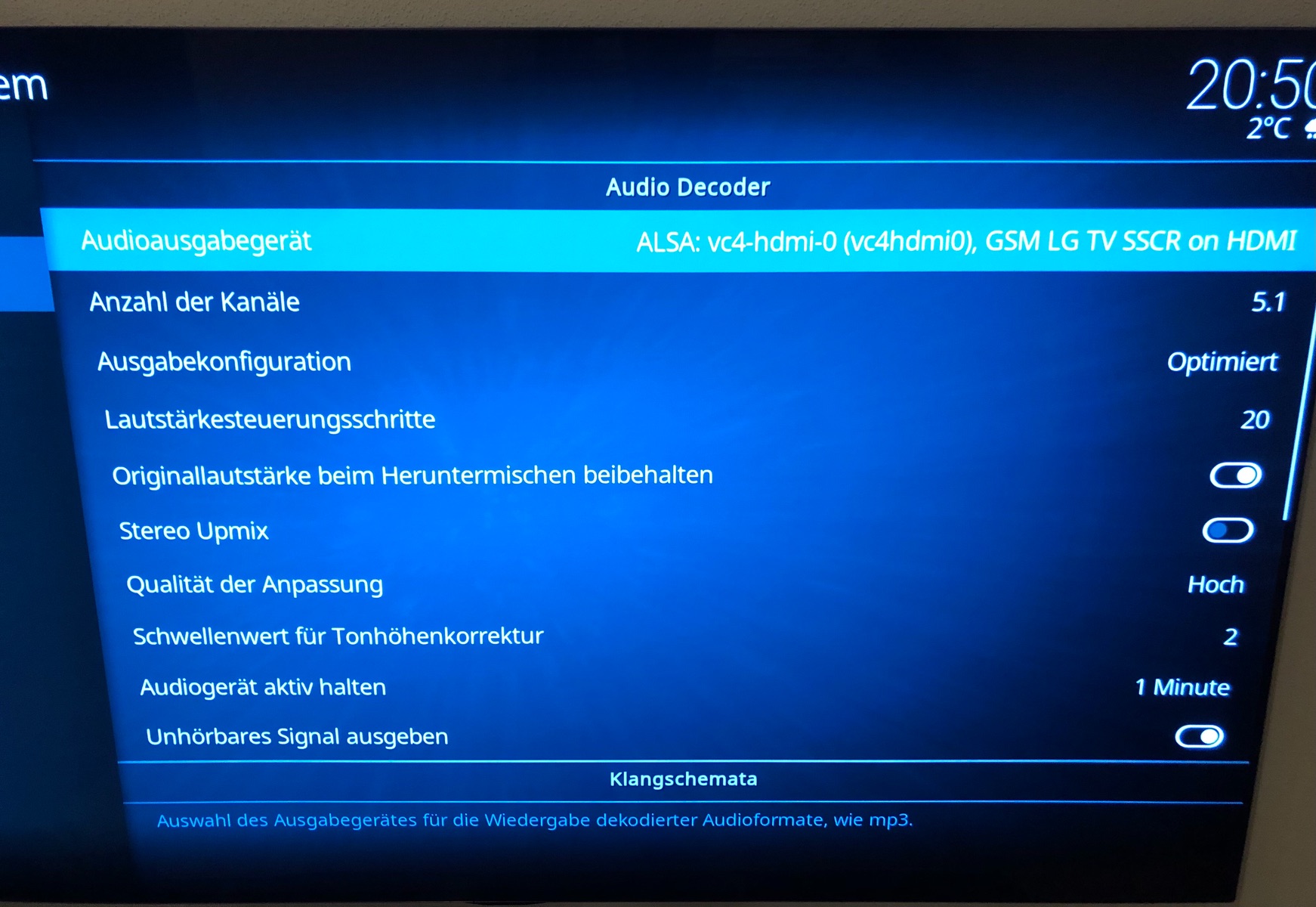

Yes eARC from TV to eARC Soundbar Ambeo
It Works now. It shows Dolby or Dolby +
DTS or DTSHD do not work.
Atmos is apparently not available for selection?
Problem was with the number of Channels 5.1
now have 2.0
And I also had to activate converting Dolby Digital.
The RPi is directly to TV.
Soundbar is Sennheiser Ambeo
My logfile is 2T67

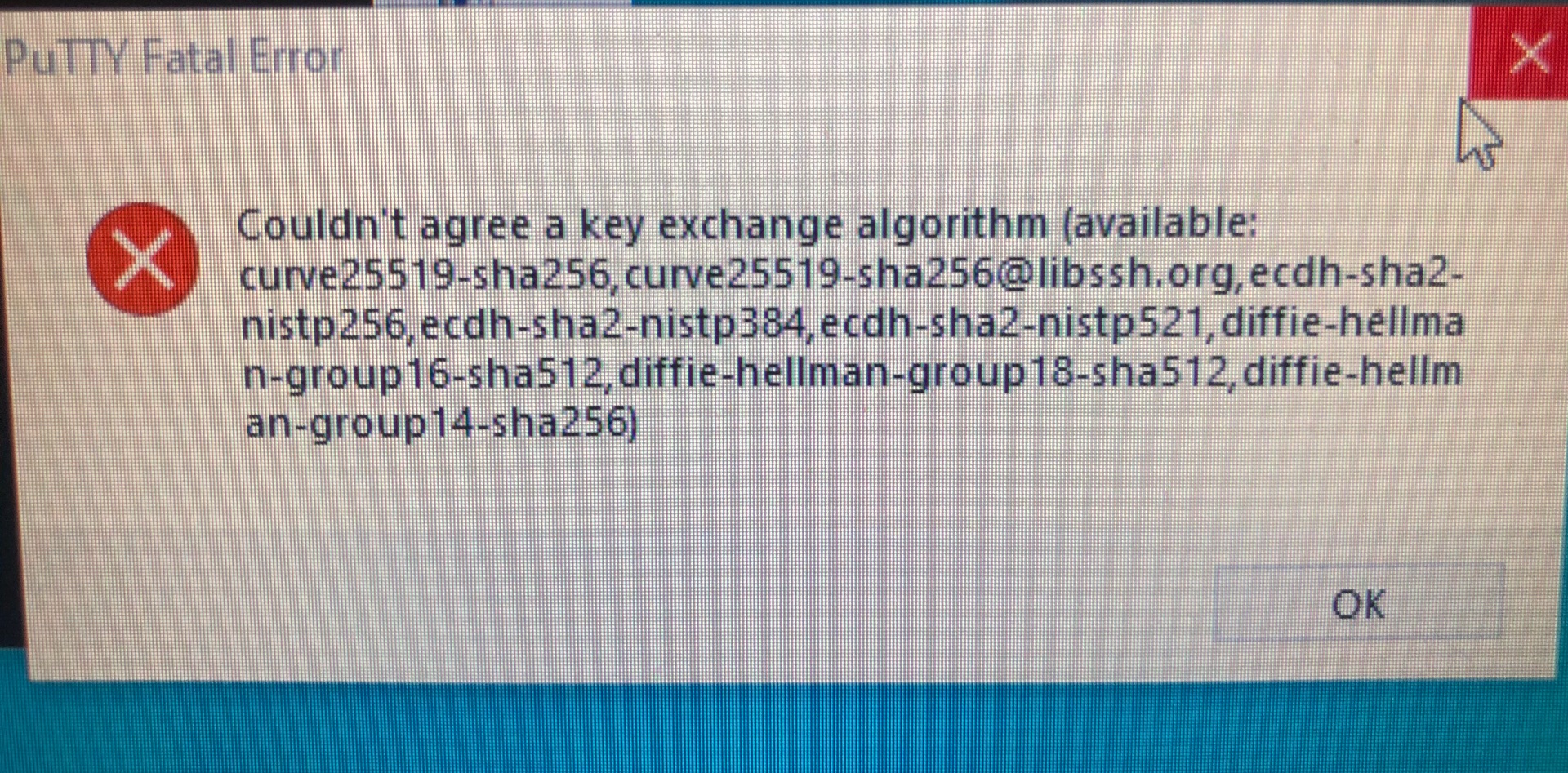

With PuTTy?
I am getting the following error
How can i create a pastekodi Log

Hello @all , have installed the latest Nightly but have the problem that the sound format is only displayed as a PCM at the Ambeo Soundbar. Atmos is not available for selection. TV is an LG GX 4k
