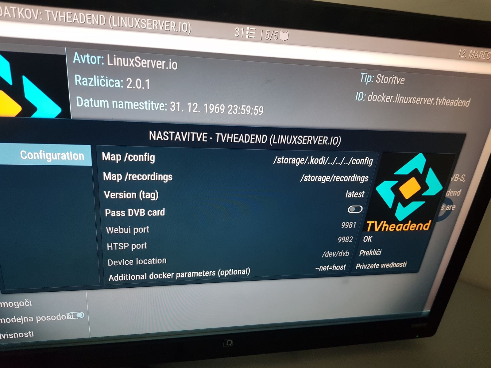

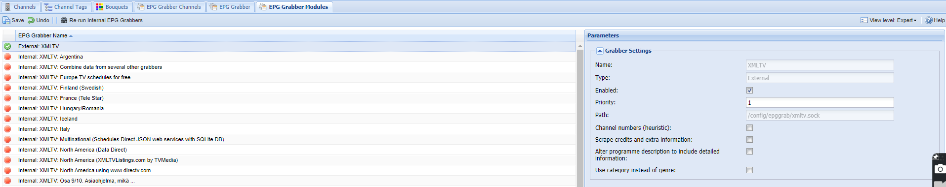

    The EPG configuration for an XMLTV file in tvheadend is done (1) in the kodi tvheadend addon configuration, and (2) enabling external EPG XMLTV Grabber in http://tvheadend-ip-device:9981
    You mean like this? See image.
    Now I don't know how to connect "/storage/.kodi/userdata/addon_data/docker.linuxserver.webgrabplus/data/guide.xml" with "/config/epggrab/xmltv.sock"
