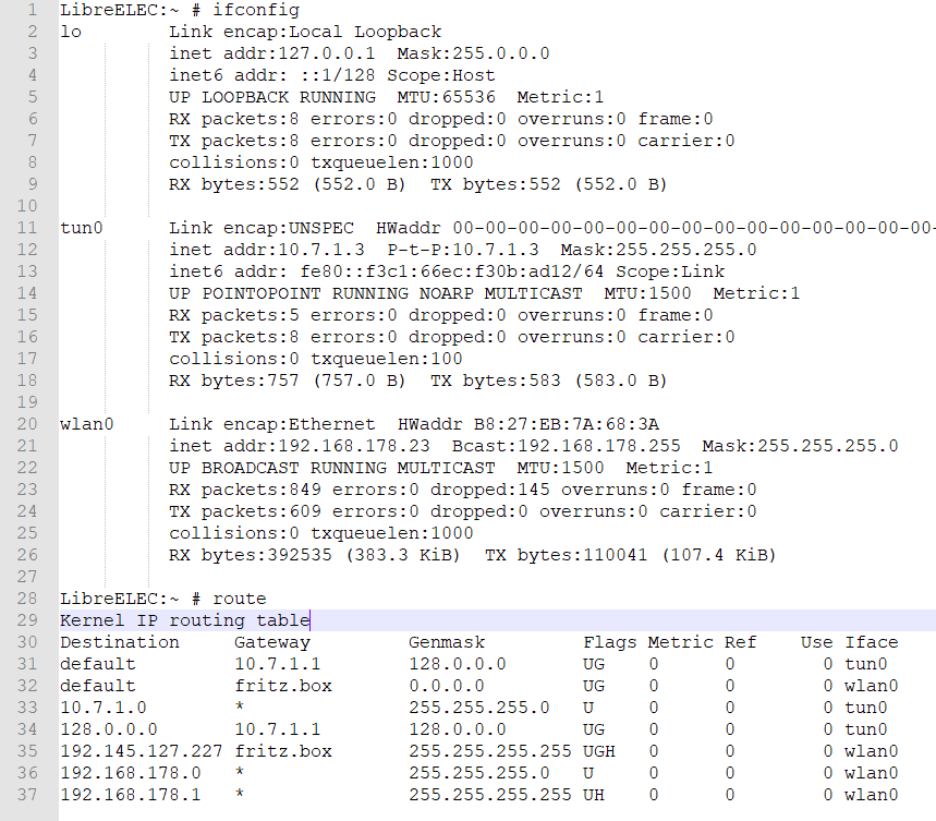

Hi,
after testing and contacting the VPN provider support we ended up there is some DNS leak in my sistem. This happens even if I manually specify the DNS address into the system options.
I found this old thread reporting a bug that could be the same in my case:
Static route when specify DNS Server and DNS leak in VPN - Bug Reports - LibreELEC Forum
Even in my case, the interface specified for the DNS addresses is the wlan instead of the tun0. So, I think it may be related to the general linux installation on which LibreElec is running... what do you think?
Hi and thanks a lot for your suggestion.
Unfortunately I'm not such a linux user (therefore I decided to go for LibreElec
), but I can share the ifconfig and the routing table I get from the system with the VPN up and running. Would you mind to take a look and see if you notice something that can be related to my issue? What would be in case the analogue command I would have to test like it is in your network?
Thanks a lot for the help,
Giuseppe
