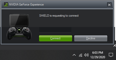

    4. SSH into your LibreELEC device, download/extract the latest release of this repository to your LibreELEC device and run install.sh
    wget https://github.com/clarkemw/moonlight-embedded-launcher/archive/v0.4/moonlight-embedded-launcher-0.4.zip
    unzip moonlight-embedded-launcher-0.4.zip
    cd moonlight-embedded-launcher-0.4
    bash ./install.sh
    5. The installer script will guide you through the process. The only user interaction required is during the pairing process. The LibreELEC terminal will give you a 4 digit code, and you will see a pop-up on your gaming PC to enter the code.
    Searching for server...
    Connect to 192.168.0.101...
    Generating certificate...done
    Please enter the following PIN on the target PC: 4321
