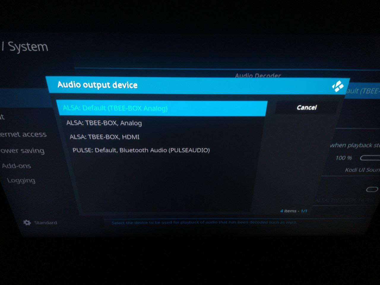

If I remember it correctly (years ago) I had to choose HDMI, Also s/pdif only supports 2 channel audio and ac3 (5.1) passthrough. You need to deselect all the other audio formats in the settings, so that Kodi will transcode these other formats to ac3 format. The number of channels should be on 2.0 (you will still get 5.1 on ac3 passthrough)
Even with HDMI selected and 2 channels, it doesn't output any audio. I'm using the same cable that works on my TV with the same sound bar, also the sound bar shows a red LED, indicating there's no audio coming out.
Hmm.. the Tbee dts has the device-tree plumbing in-place. Have you selected the S/PDIF output in Kodi settings? You shouldn't need to make any changes to alsa settings as the routing for S/PDIF should be set by default.
Weird, I don't see the S/PDIF output in the Kodi Settings, I've never tried it on Android, but the red light on the port is on.
Optical outputs should work as long as the device-tree file has the necessary content. What box? What device-tree are you using?

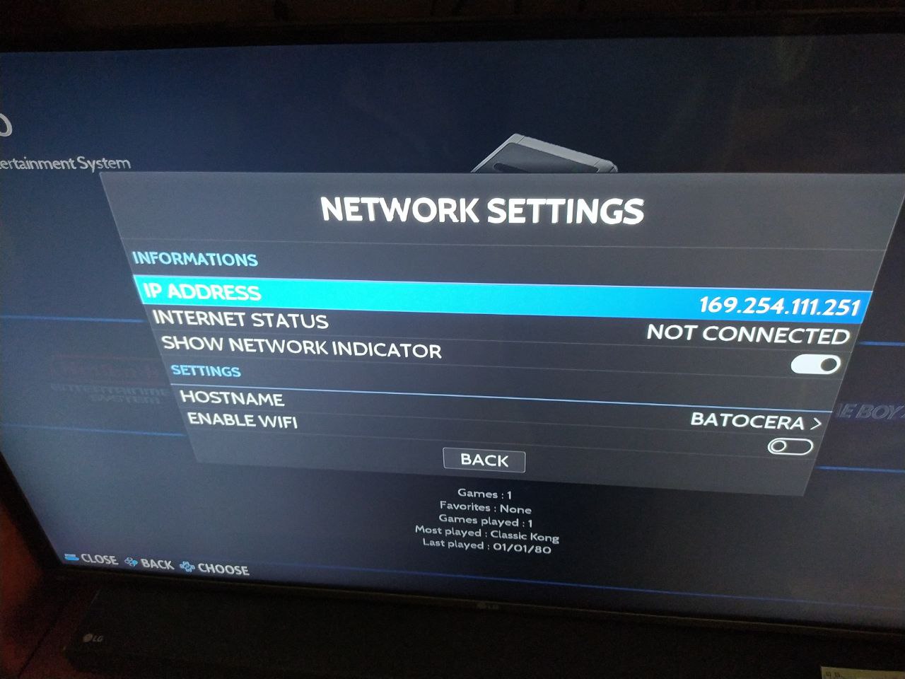

Hi. After some tries I found why the controllers weren't working, it seems like just one of the usb port works here. Xbox 360 Controller and Series X works fine (from the USB Port), I have no Wifi, Bluetooth (AP6330) or ethernet, ethernet has a weird IP Adresss, DHCP broken probably, I'll attach image bellow. Any way to get logs without internet connection ? Thanks.
