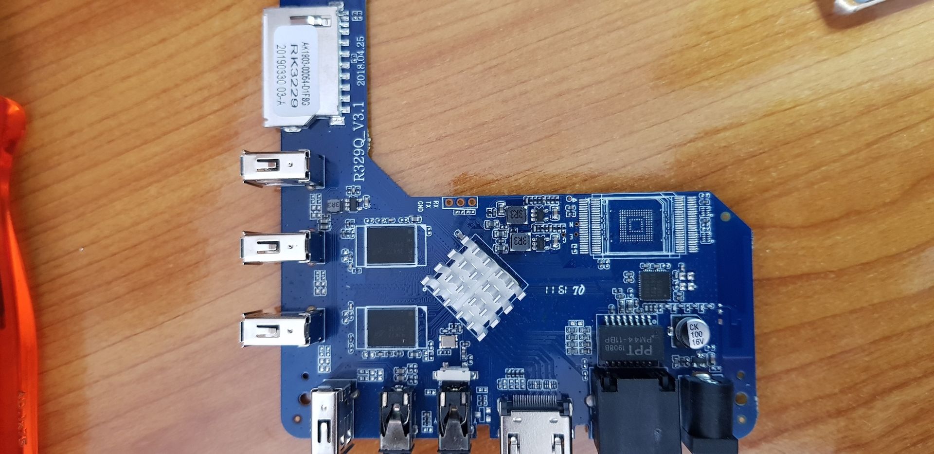

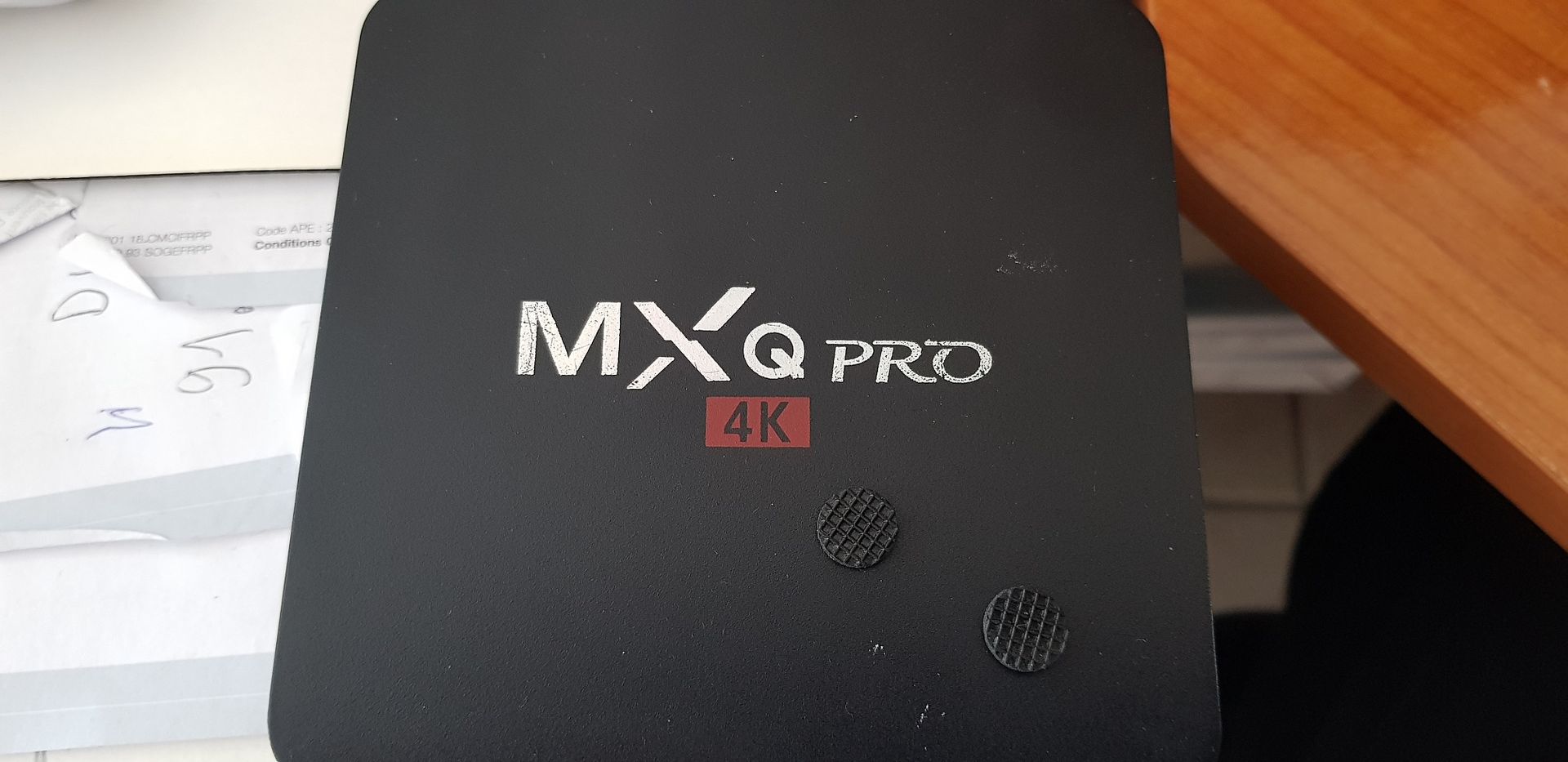

Now the remote control works well except the color of the led which is again reversed with the MXQPRO4K tree.
With the previous version the led was fine.
Do you think I can extract the device tree from the previous version and put it with the latter??

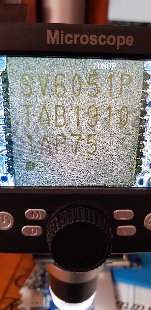

- ssv6051p wireless driver
- other fixes and small optimizations
Wifi works well... all you have to do is start and stop from the remote control and you're done.

I followed the tutorial and it's ok for the led. The rest works fine for now but I'll use it to confirm.
I took this version rk3229-box-mxq4kpro-ovclk
Of course the wifi and the start with the remote control does not work yet but I understand the difficulty and I cross my fingers.

thanks, although to do that I went out of 'standard' libreelec as that driver is 'legacy'. however mine is and will remain an unofficial build and my goal is to make as many things work as possible
To sum up, everything works well except the remote control which does not want to turn on the box, the color of the led which is reversed and the WIFI which does not work.
Apart from that it is for the moment the version that runs best on my old box...
I would like to point out that the 1080p resolution is much smoother than with LibreElec 9 and that's cool.
