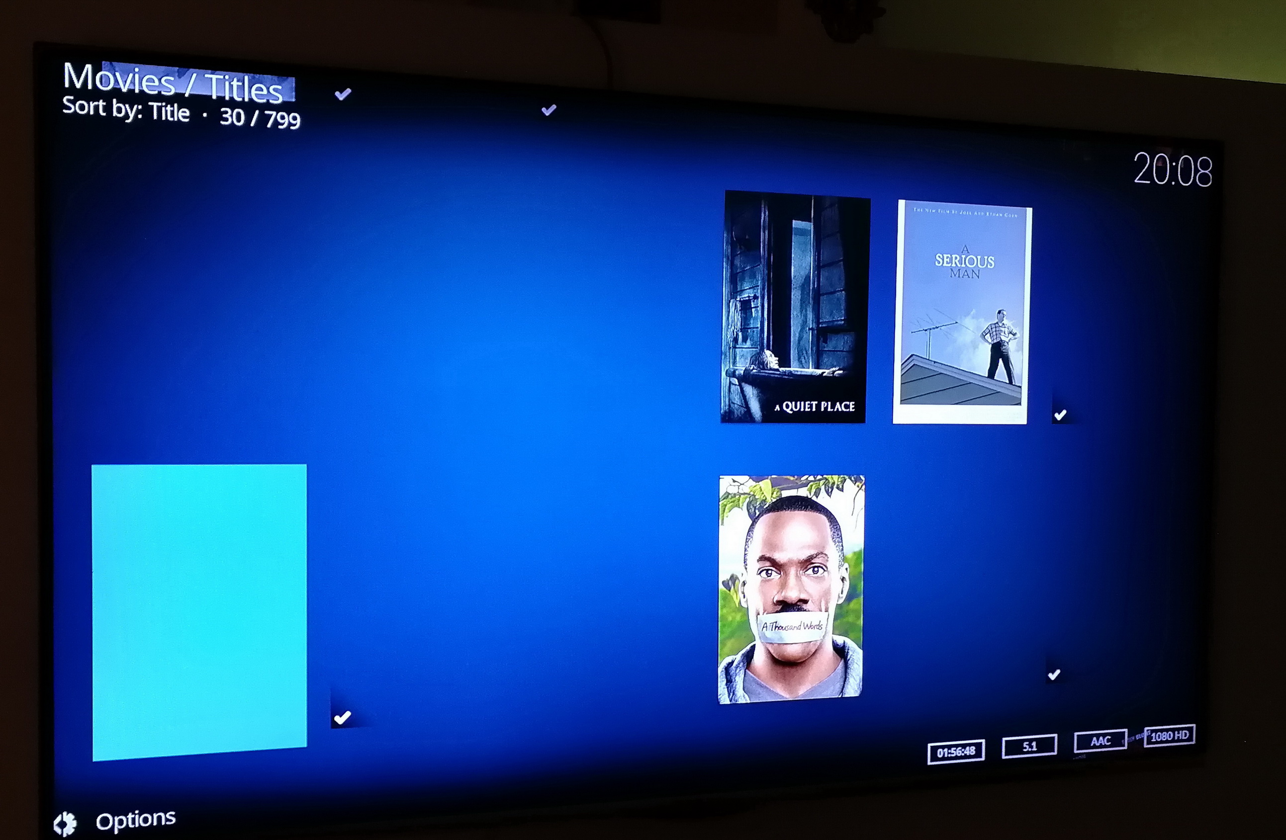

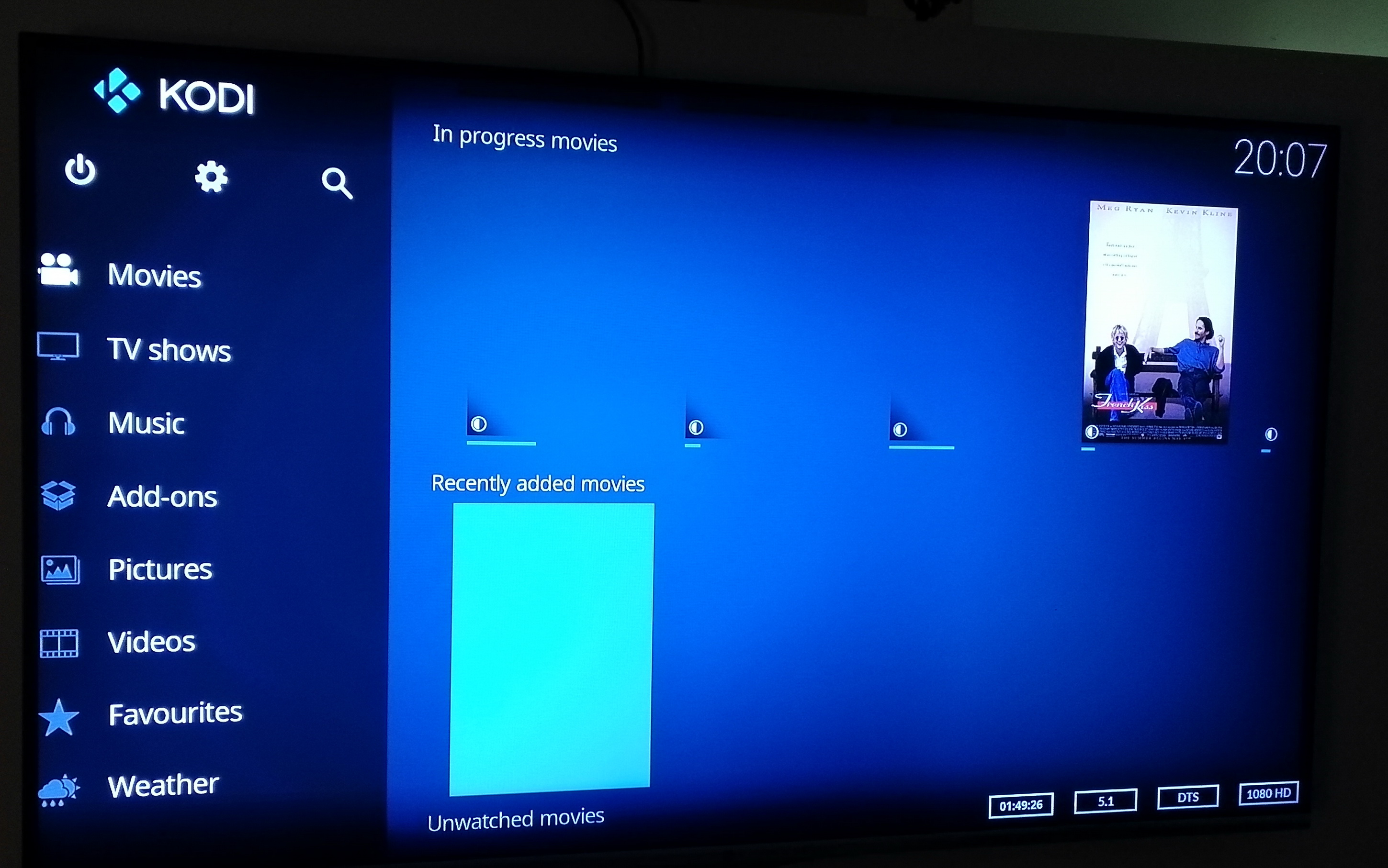

When I ran the "Update library" command yesterday evening again I realized that the process runs through quite quickly like when there is nothing to update at all.
I recalled that I once accidentally removed a movie from my library and that even after I updated the library it would not show up anymore although the video file was still on the hard drive.
This made me think to maybe use a different scraper. So I changed the scraper from the "The Movie Database" to "The Universal Movie Scraper" an low and behold after a lengthy update process all posters are showing up except the ones for Movie set but that's not a big deal since I can refresh them manually .

Hi,
The other day I deleted the Thumbnails directory and the
TexturesXX.db file because I ran out of storage space. There were a lot (really, a lot !!) of thumbnails from Youtube clips.
Now (after reboot) I cannot get libreelec to show all the cover art of my movies anymore . Updating the library does not seem to help. Only a few movie covers are showing up. If I manually refresh a particular video the poster comes up but with over 700 movies it's a bit cumbersome. The TV-Shows and Music libs are fine.
Any idea what went wrong and how I can fix it ?. See also attached pix.
