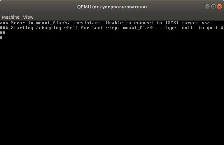

    I want boot diskless LibreELEC station from remote iscsi-target. I follow this instruction but loading fails with message: "Error in mount_flash: iscsistart: Unable to connect to ISCSI target"). How i can check my config? and etc... ?
    My be problem in quotes boot=ISCSI in extlinux.conf ???
    My extlinux.config:
    DEFAULT linux
    PROMPT 0
    LABEL linux
    KERNEL /KERNEL
    APPEND ip=192.168.0.195 boot=ISCSI='''iscsi_initiator=iqn.client,iscsi_target_name=iqn.2021-01.domain.ru:libreelec,iscsi_target_ip=192.168.0.2,iscai_target_port=3260''',LABEL=System disk=LABEL=Storage quiet
    I try only single quotes,
    boot=ISCSI='iscsi_initiator=iqn.client,iscsi_target_name=iqn.2021-01.domain.ru:libreelec,iscsi_target_ip=192.168.0.2,iscai_target_port=3260'
    but not heve effect.
