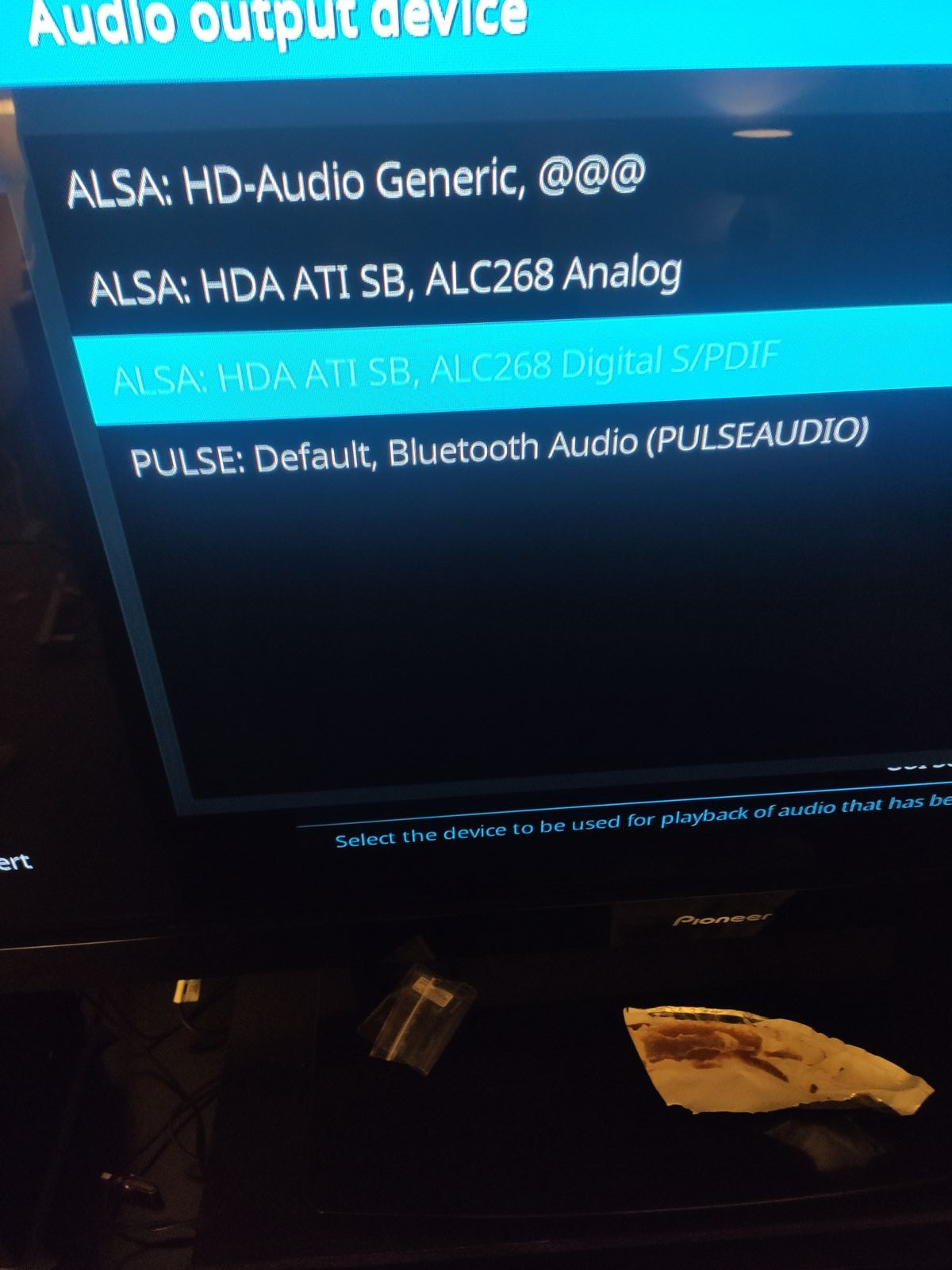

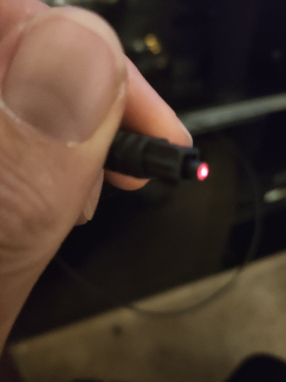

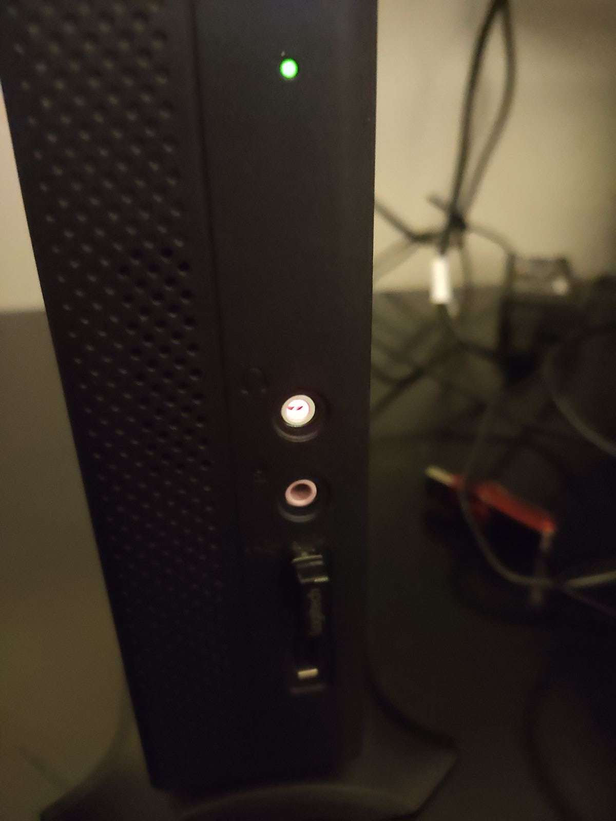

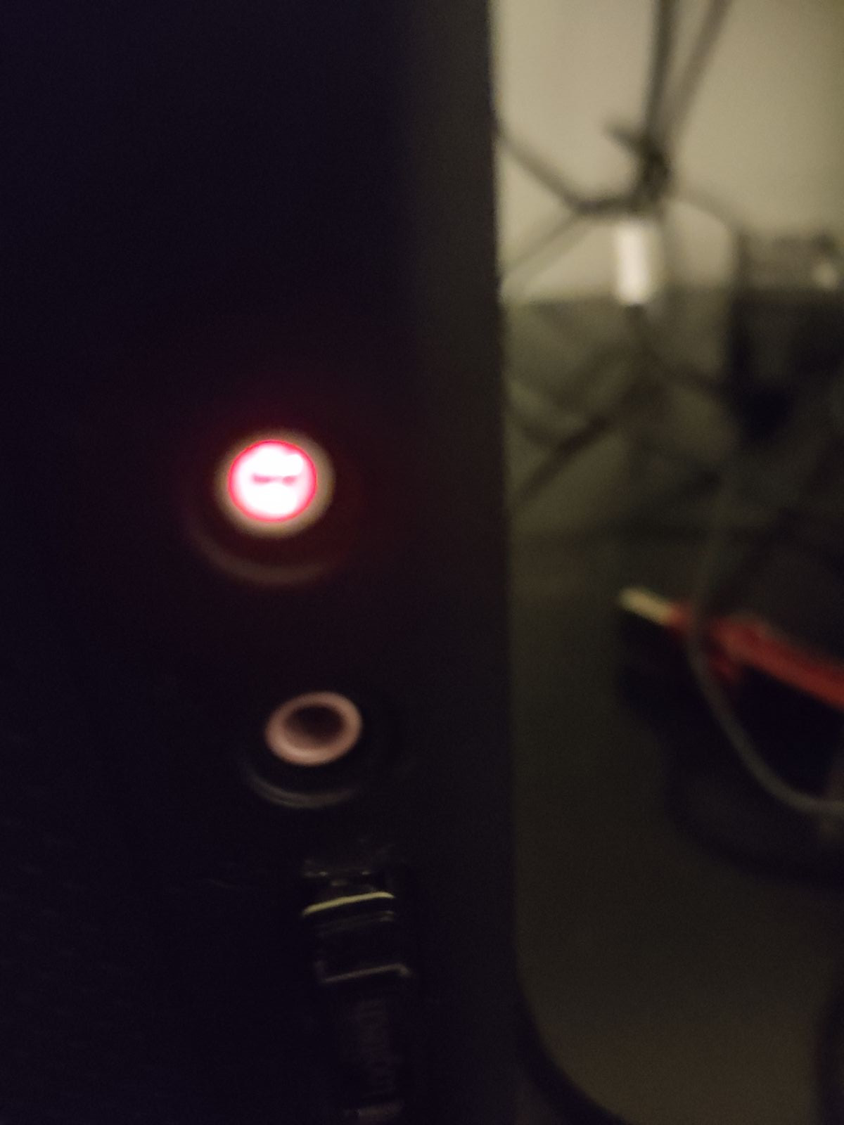

    Yeh it's using basically none of the 4gb of ram. The CPU is a different story however it never cuts out or lags. Skipping during 4k is also a problem. I plugged the optical in both a high eend dac and also an avr.
    Got 5.1 from the avr. If only optical could do a higher bitrate.
    Out of interest has anyone ever used an is2 or i2s via hdmi cable as their audio output to a dac from a rpi or something similar.
    Pink faunn cards are way too expensive
    Yeah ofcourse. I don't know how it happened but I restarted it a few times and not only am I getting 2 channels I'm getting 5.1 with the settings at 5.1 in Kodi.
    $27 + $7 ssd +2 dvi-hdmi +2 3.5mm optica cable and it's a pretty good streamer. Even playing 4k at 1080p.
    I would suggest if anyone went this route to get one with a better processor. Will try putting 16gb ram in it and see.
