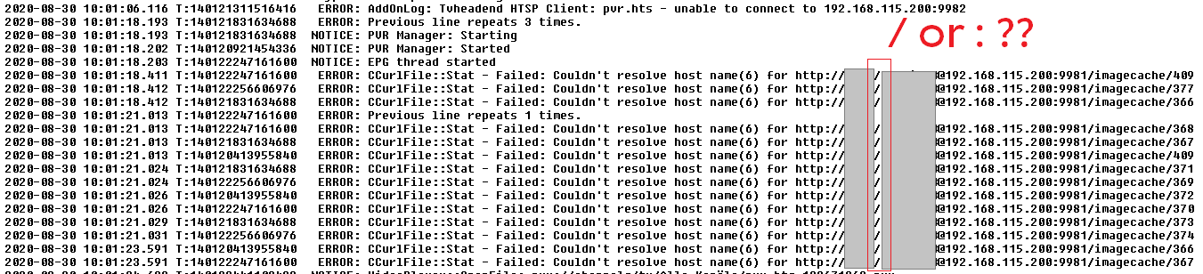

Hello
I have installed LE on an HP-AIO-PC.
Then I installed and set up the addon PVRTvheadend HTSP Client pvr.hts v4.4.21.1.
LiveTV, recording everything works.
Unfortunately no picons are displayed.
The icons are displayed in the TVH server and Android app.
Some error messages can be found in the log file.
Is the registration strip wrong here?
so is the registration:
http: //user/[email protected]: 9981 / imagecache / 409
Shouldn't it be so right ?:
http: // user: [email protected]: 9981 / imagecache / 409
LibreELEC release: Generic.x86_64-9.2.4
Starting Kodi (18.8 (18.8.0) Git:18.8-Leia). Platform: Linux x86 64-bit
Using Release Kodi x64 build
Kodi compiled 2020-07-29 by GCC 8.3.0 for Linux x86 64-bit version 5.1.16 (327952)
Running on LibreELEC (official): 9.2.4, kernel: Linux x86 64-bit version 5.1.16
FFmpeg version/source: 4.0.4-Kodi
Host CPU: Intel(R) Core(TM) i5-2390T CPU @ 2.70GHz, 4 cores available
