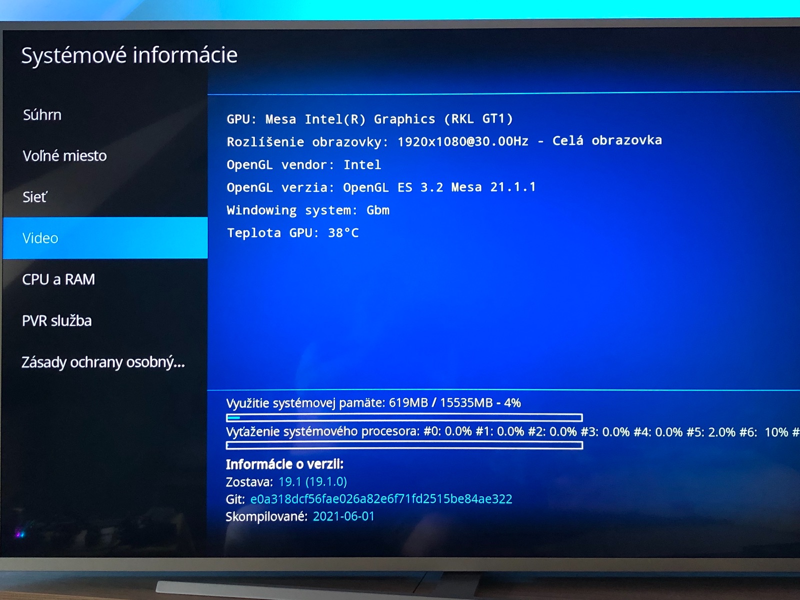

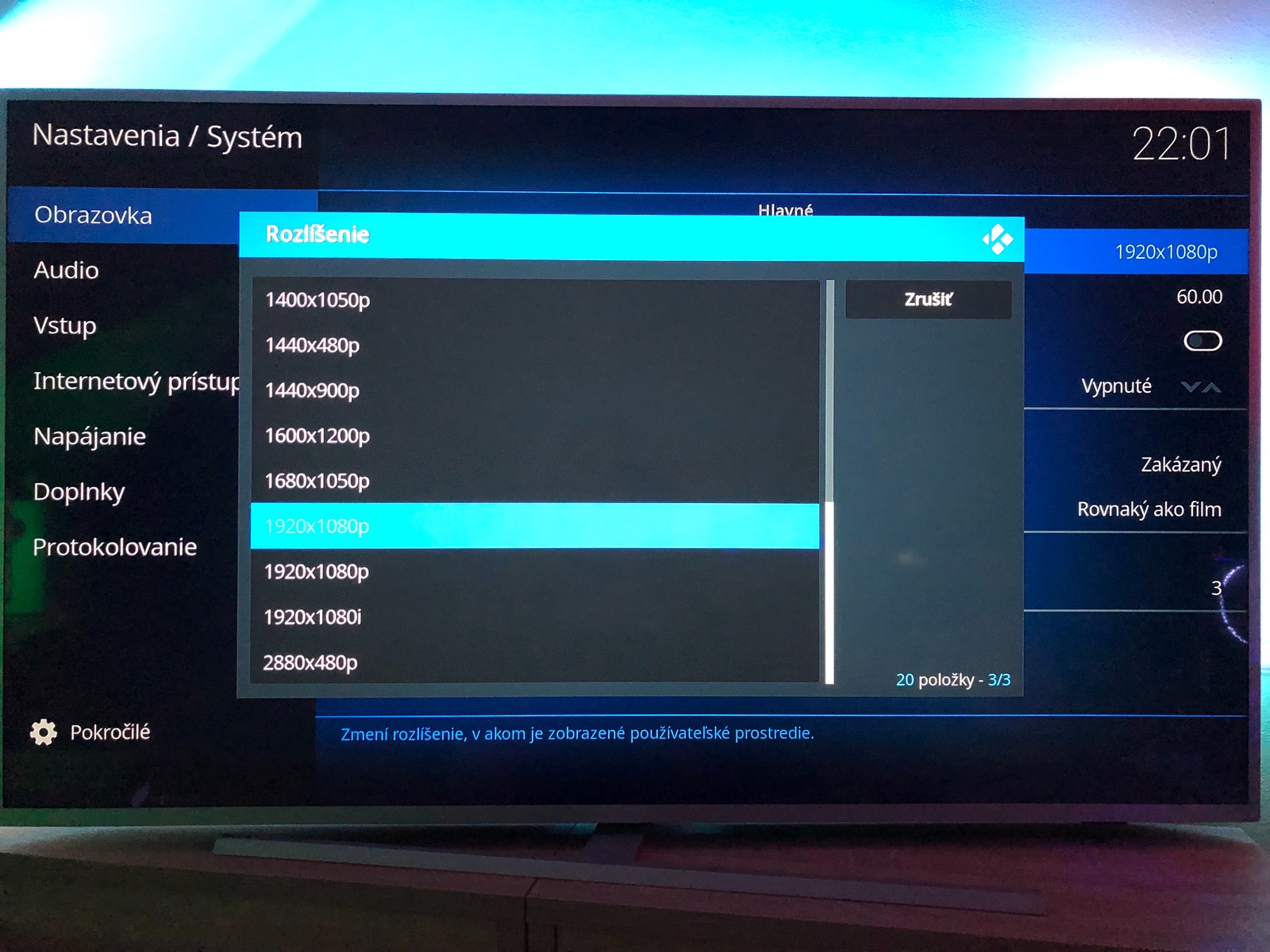

In both logs I see that it is connected to a Marantz AVR.
Can you connect it directly to the TV, reboot, and post kodi.log?
Directly TV ![]()

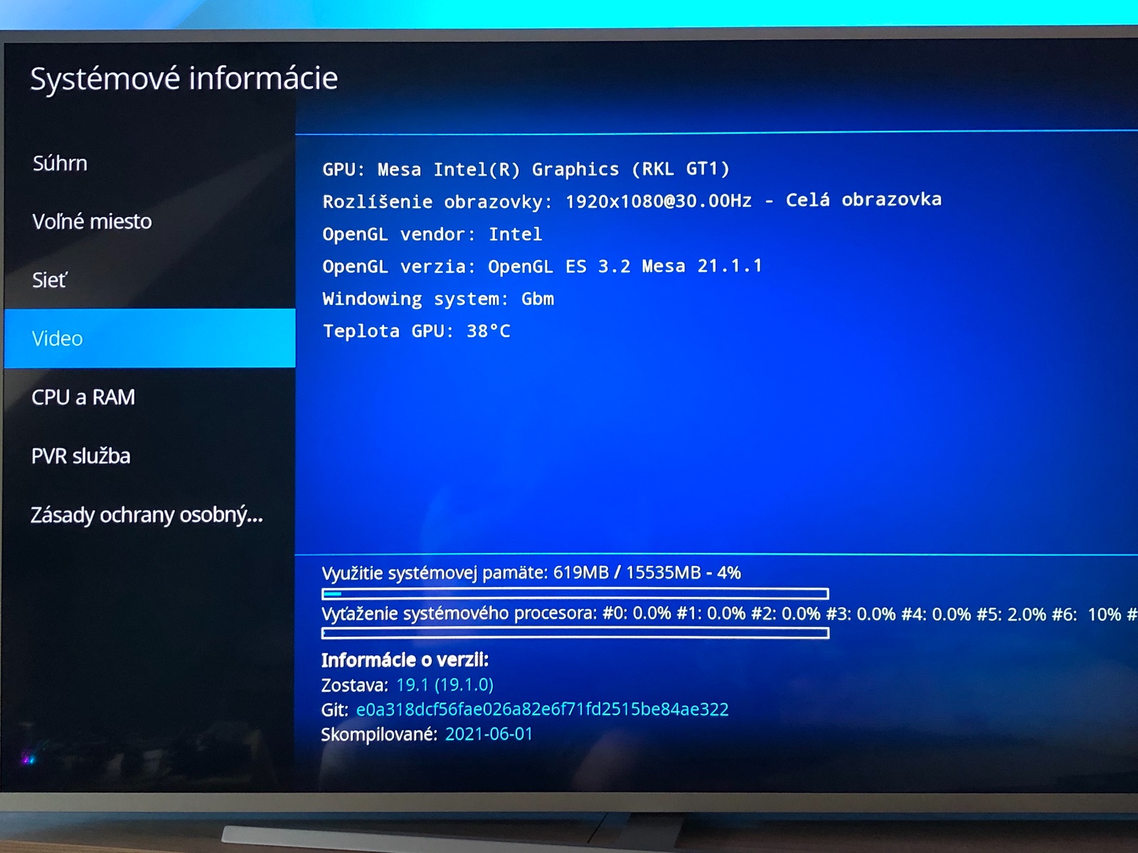

Bios is definitely up to date. Through Windows 10, the HDMI output is in the order of 4K @ 60.
Connected DP http://ix.io/3ts7
Connected HDMI http://ix.io/3ts8

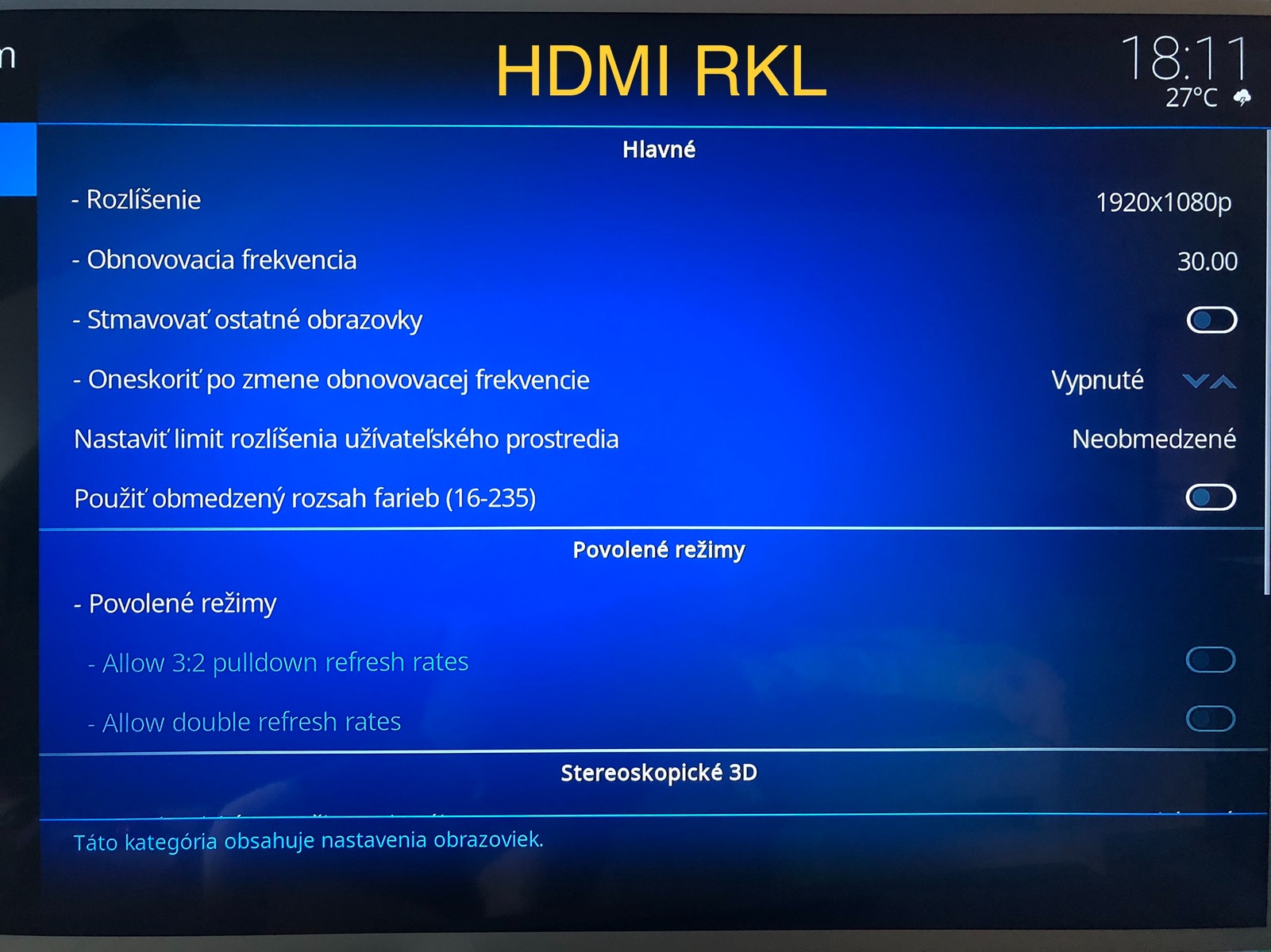

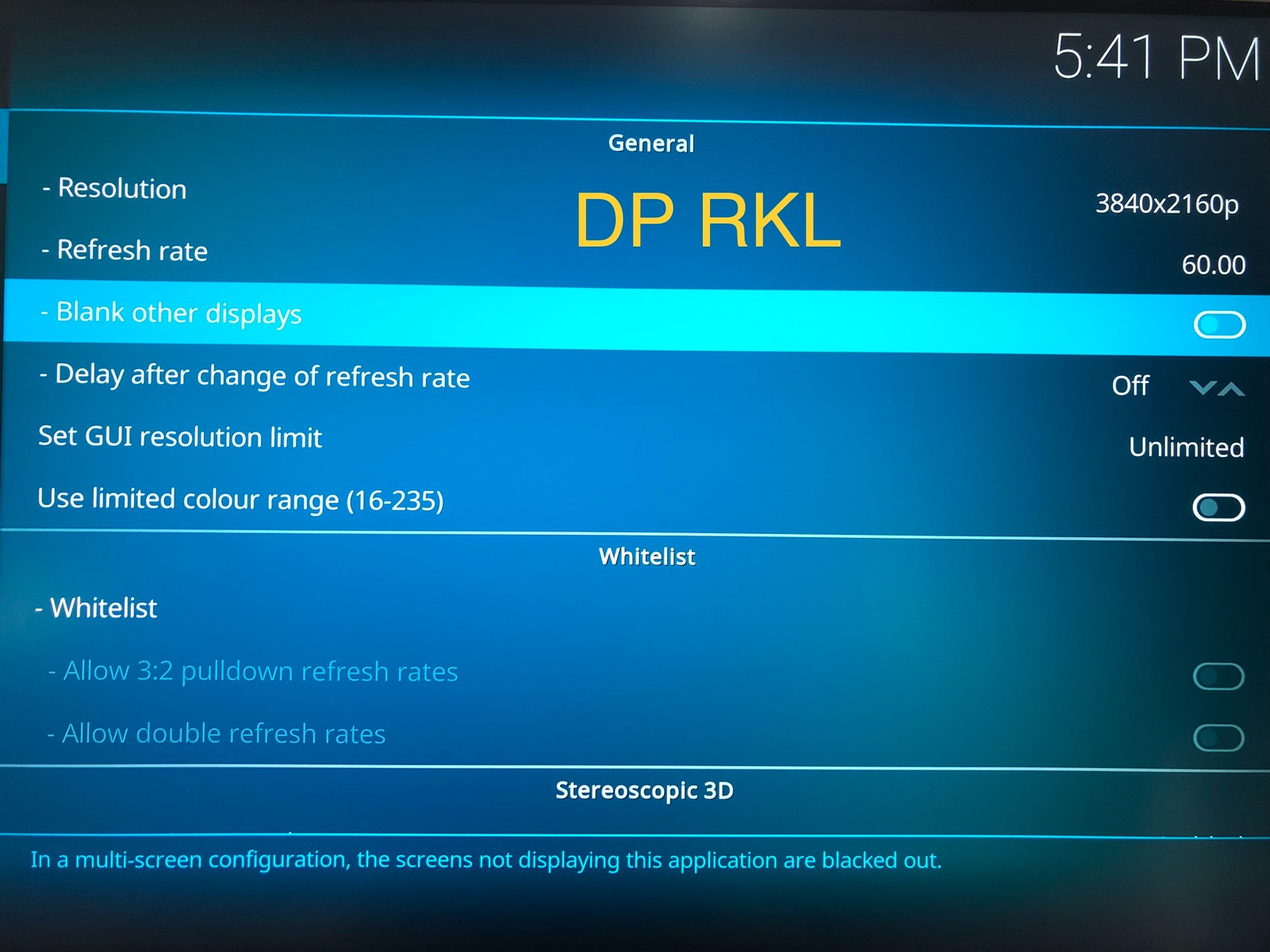

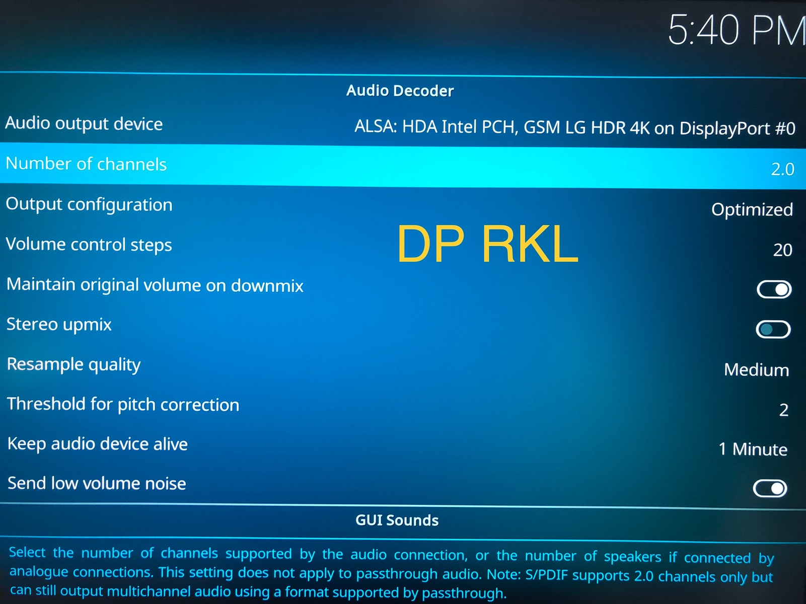

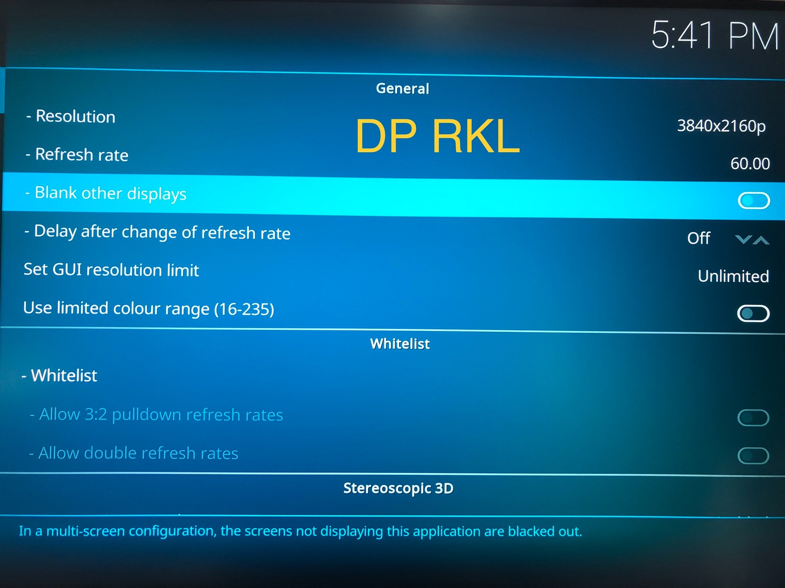

Display MoreI found out that via DP on the LG monitor it works fine 4K@60.
It is also strange that it is not possible to select another output in the video output settings. (at least HDMI / DP or default)
I have a TV and a projector connected to the Asrock J5005 and it works there.
Is it unrelated to the fact that the HDMI 2.0 native 4K@60 is on the RKL?
I have Asrock Z370 and i3-9100 and there is an integrated LSPCON DP to HDMI 2.0 chip.
The question is whether it is possible to adjust the Libreelec settings so that the 4K signal is on the native HDMI 2.0 output.

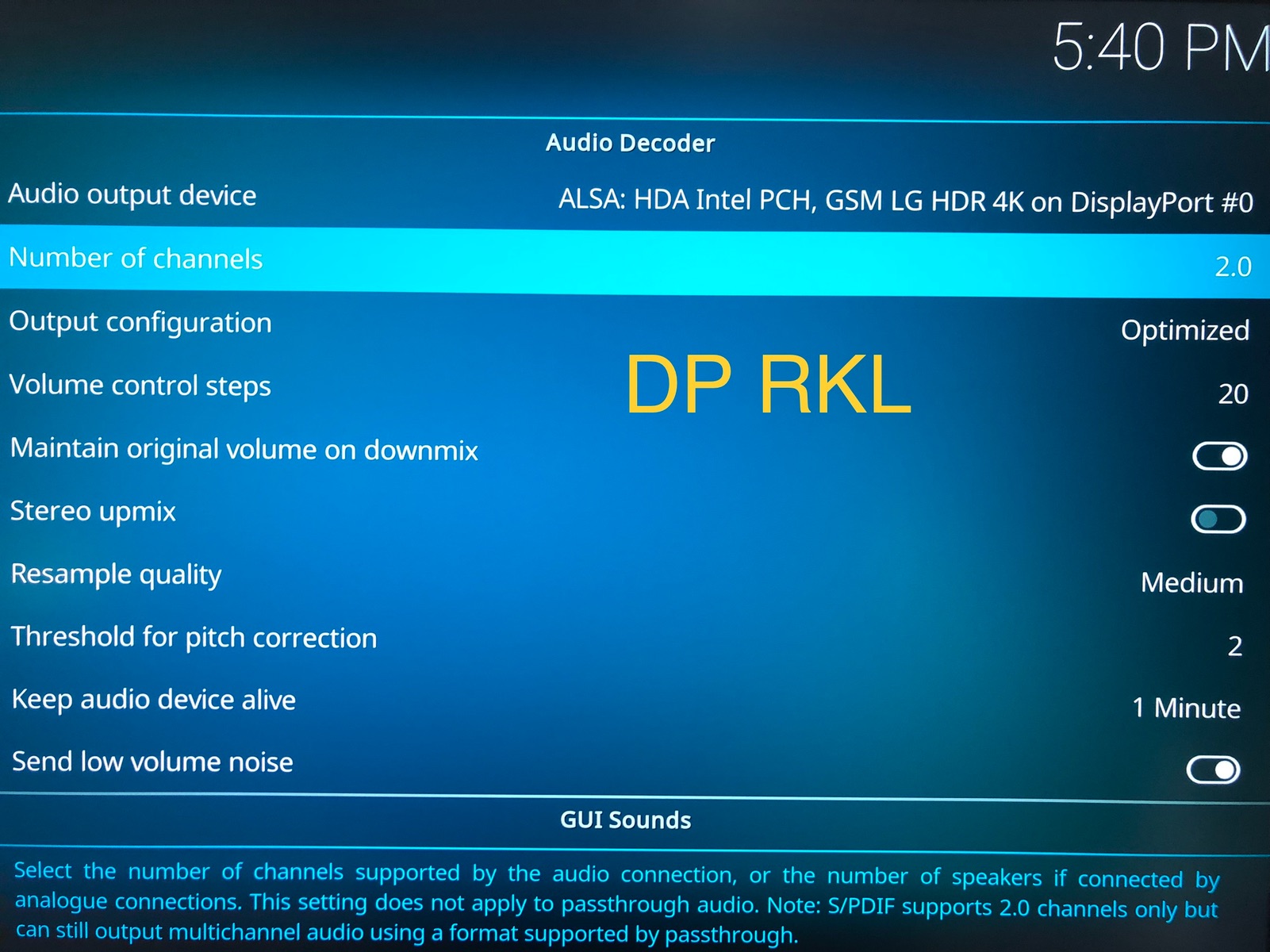

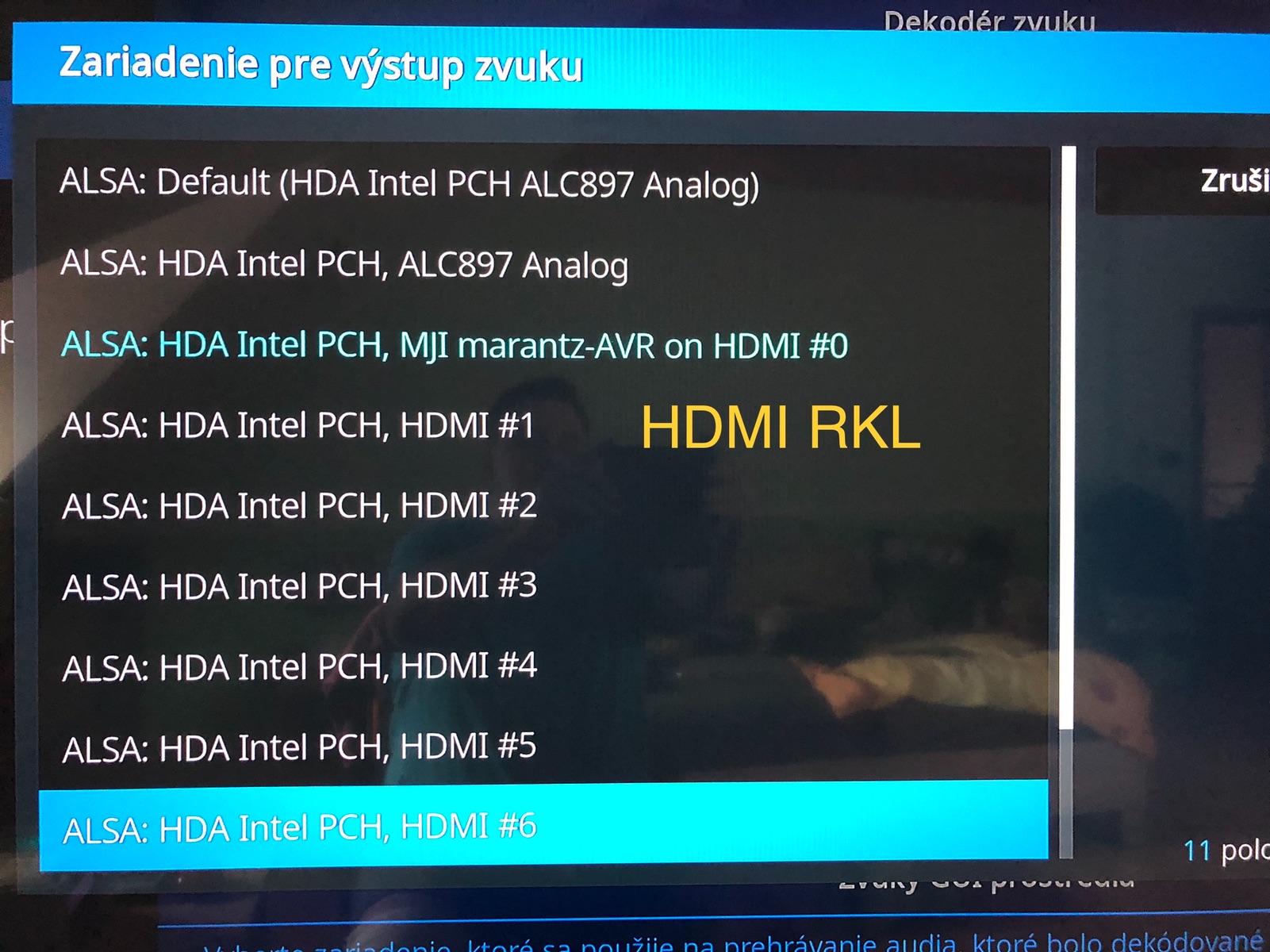

According to the sound output, I feel that it's HDMI#0 as in the picture.
/I tested KODI on RKL 11600 + ASRock H570m via Win10, and it goes via HDMI 2.0 4K@60/
smp Please is there really no way to change that output from DP to HDMI 4K @ 60 as I described in this post?

EDID looks ok, no idea why Kodi is limiting to 1080. Try a clean install.
Yes, I did everything as a clean installation ...

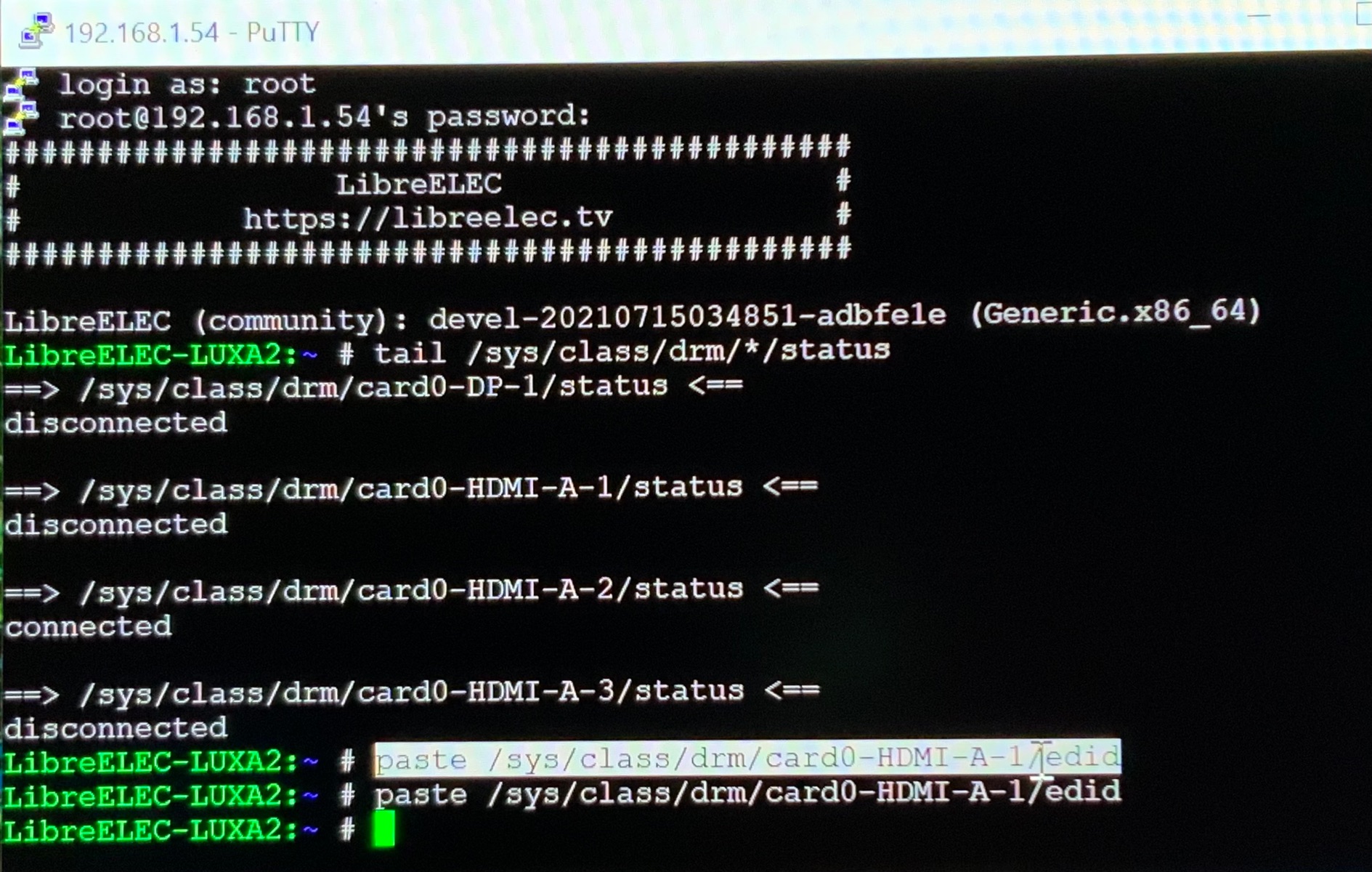

Run
paste /sys/class/drm/card0-HDMI-A-2/edid
and post the ix.io link here.

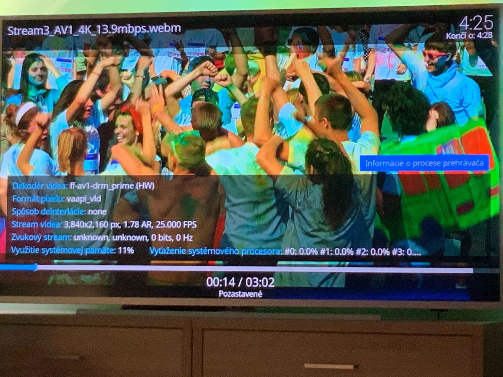

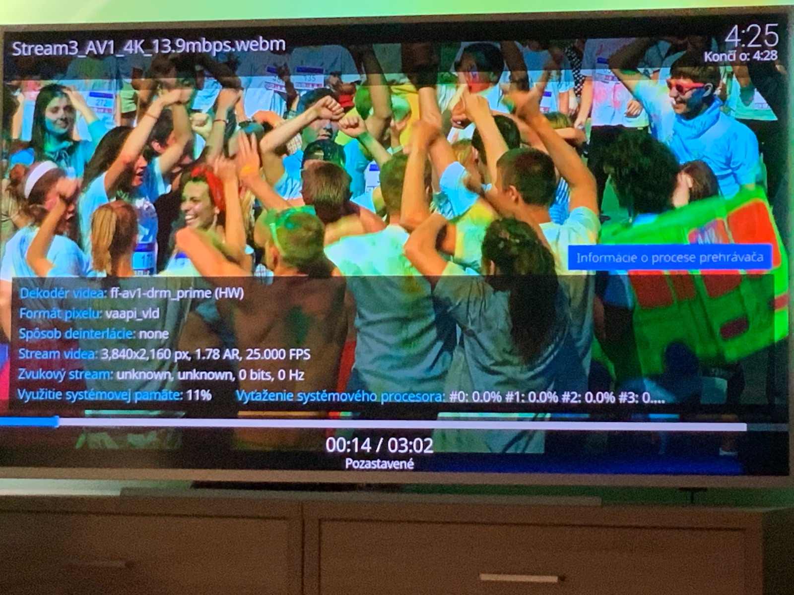

Yes, I also tried it directly on TV.
AV1 VAAPI 4K 25FPS video test OK, no sound yet
I will try other videos…

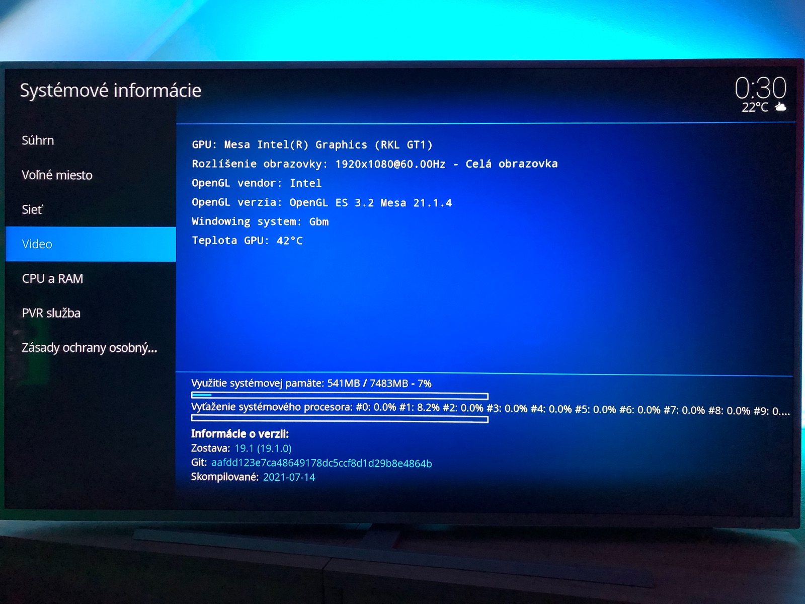

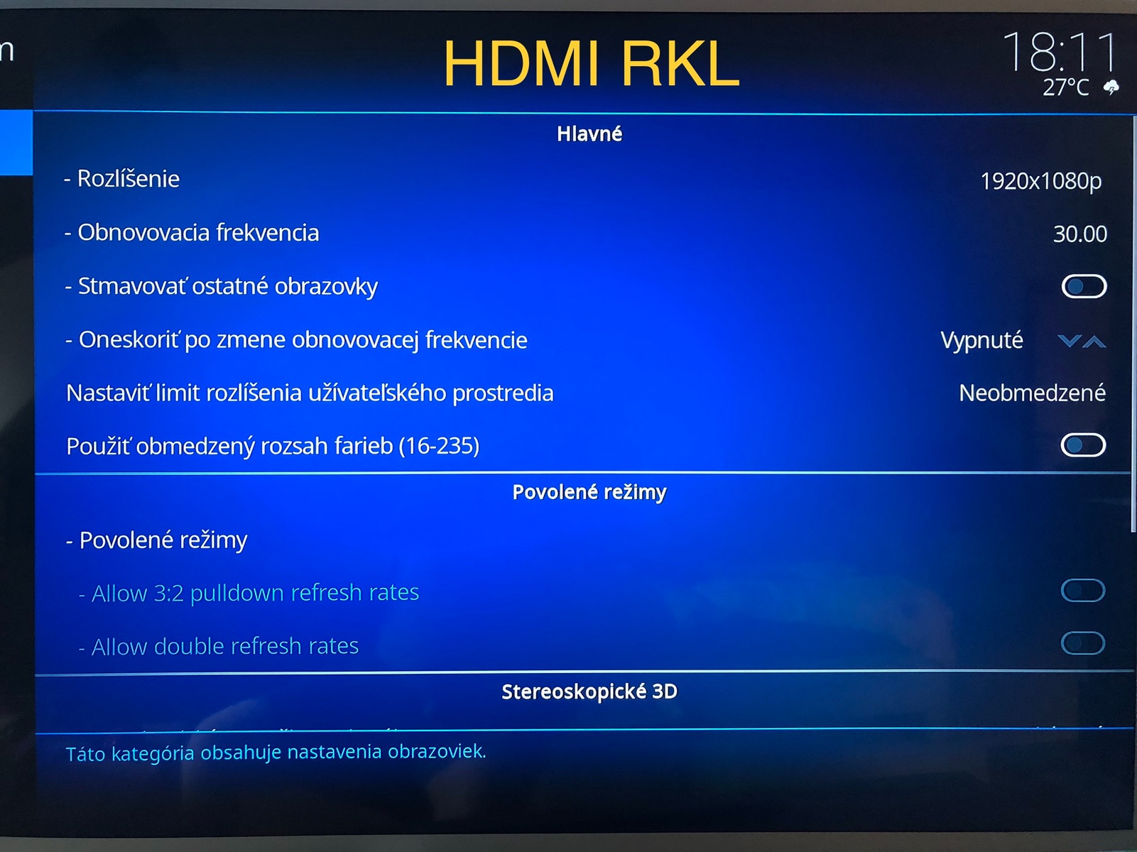

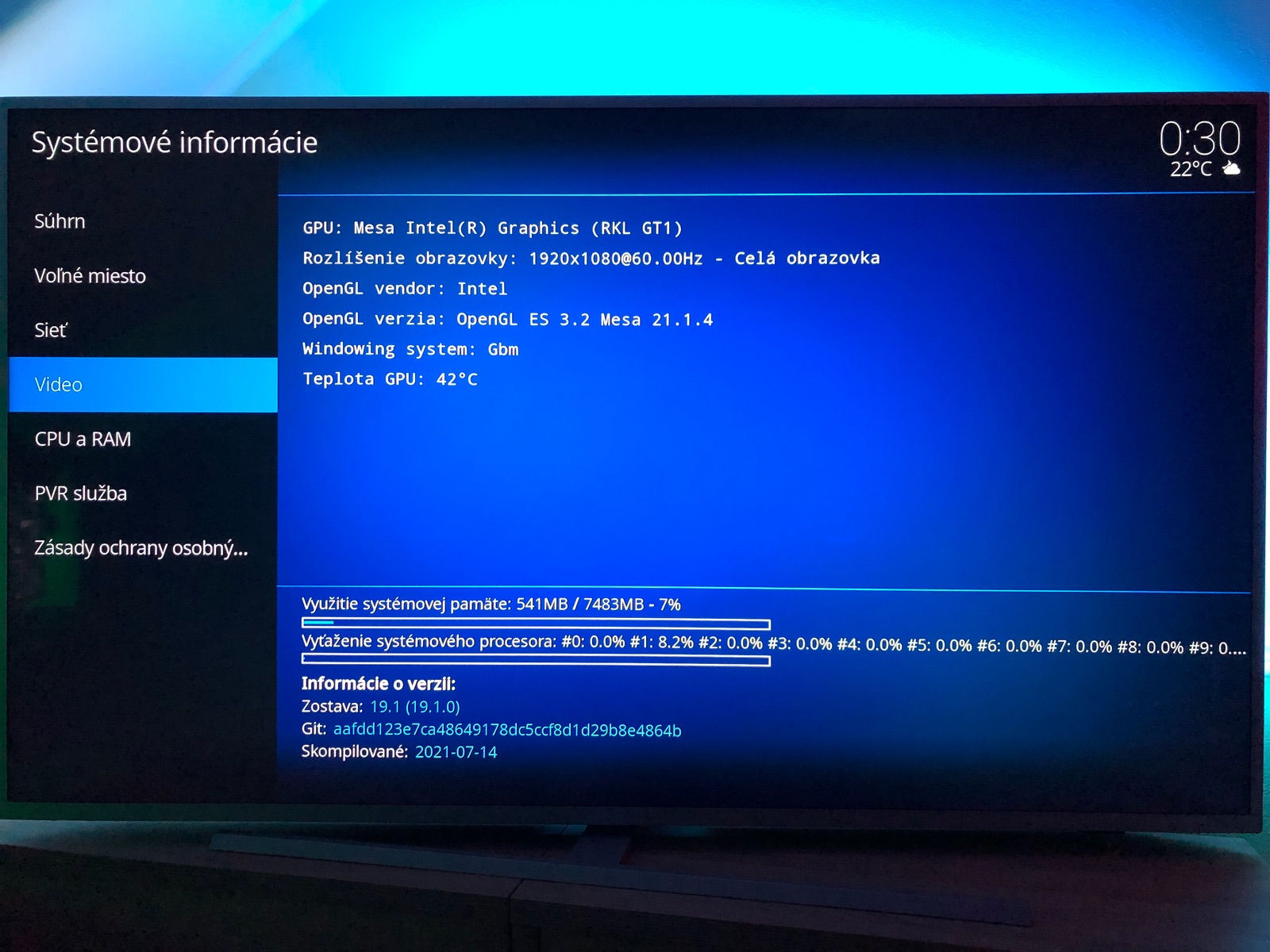

New build - no change in resolution.

Hi, super!
Thank you, I'll try and let you know ![]()

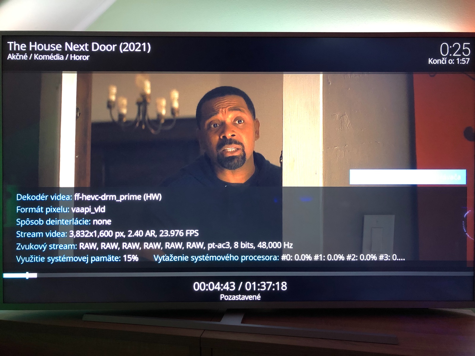

VAAPI hardware acceleration works ![]()
(DRM PRIME - Direct To Plane)
HDR works ![]()
But the maximum resolution is only 1080 @ 30/60 ![]()

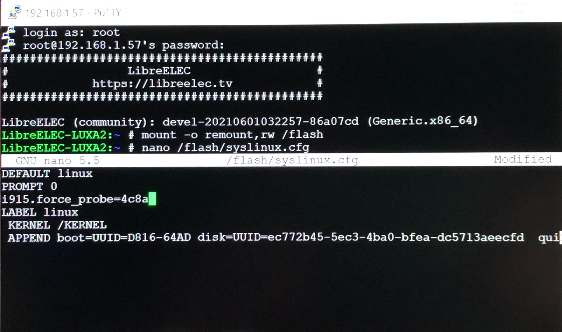

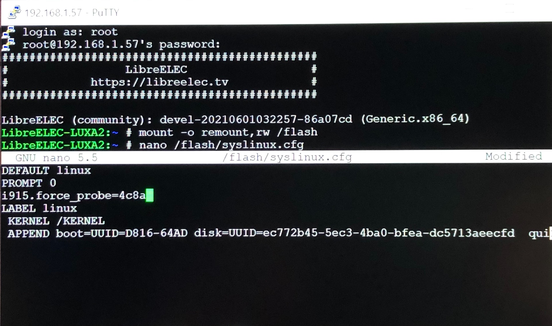

I downloaded syslinux.cfg to the text editor and added the line i915.force_probe = 4c8a, but I can't save or delete the modified syslinux.cfg.
It's probably write-protected.
How do I get there?
Well thank you.
The graphics drivers are build into the kernel and not loaded via modprobe.
Technically you have to add the parameter i915.force_probe=4c8a to the kernel command line in /flash/syslinux.cfg.

I tried to send it via PuTTY ssh command line, but nothing happened after the restart.
I also created the folder etc/modprobe.d and in it "config i915-fingerscrossed.conf"
with line: options i915 force_probe = 4c8a
and no change.

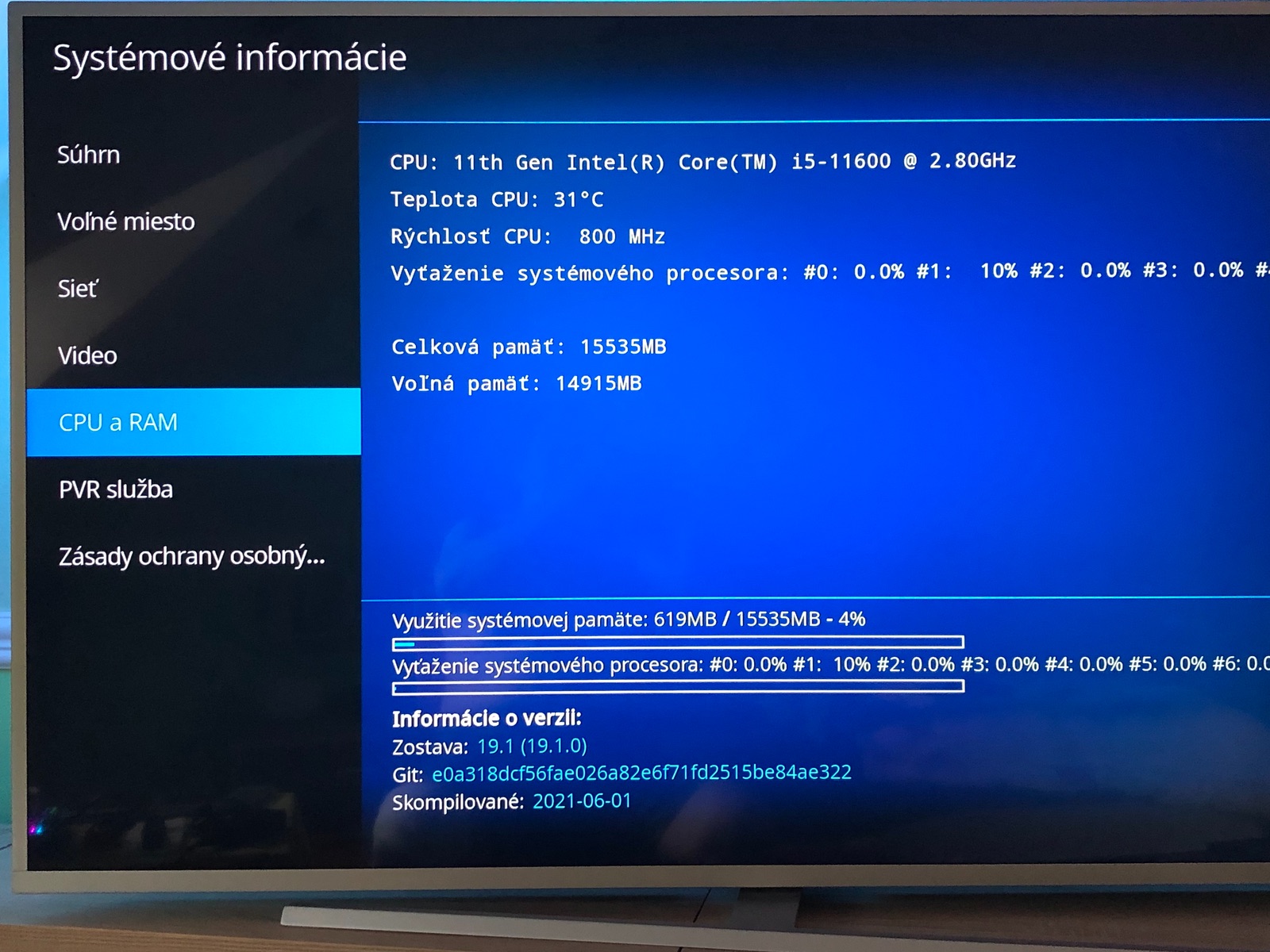

When I turn off VAAPI hardware acceleration in the player, I get a 1080p image.
I use LibreELEC devel-20210601032257
Thank you.

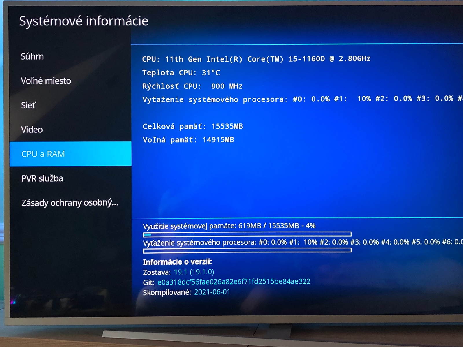

I tried the Asrock H570M-ITX and the new Intel i5-11600 processor, but there is probably no driver for the new GPU 750. Libreelec will run, in max. 1080p resolution, but nothing can be played. (black screen)
The official version 9.95.4 does not work.
Is there a chance it could work?
