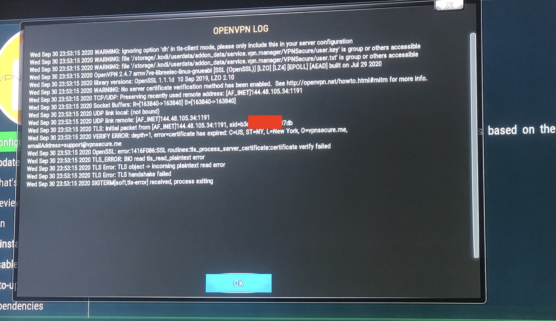

    I'd want to see a log but likely if you want this to work you'll have to go fetch their latest .ovpn files so I can update everything.
    So, I contacted VPNSecure support and they sent me a OVPN file for me to use. It does not work either. I am getting the same "certificate expired" error. See attached screenshot of the log.
    One issue I am seeing is that their OVPN file has port 1282 but VPNManager is connecting to 1192 per the log. I even tried to disable "Use VPN provider default UDP port" option and manually enter 1282. But from the logs, I am seeing that its still trying to connect to 1192. I contacted their support again with the same error and they are blaming the port as well.

    FYI - I tried to use their OVPN file on OpenVPN in Mac to test it. It seems to work fine and connect without issues to port 1282. Just doesnt want to work in Kodi VPNManager alone : /
    Here is the OVPN file (removed the actual certificate and keys obviously). I wonder if the port number is not positioned the way your code expects?

    Is VPNSecure still working for this? I got a VPNSecure account, generated fresh key, cert from member area. Then reset all settings in VPNManager for OpenVPN in kodi and configured by following the below steps
    - Choose VPNSecure as VPN provider
    - Entered username and password
    - Then clicked configure first connection
    - Chose United States 5 (UDP) server
    - Selected my username.key file emailed by VPNSecure
    - Selected my username.crt file emailed by VPNSecure
    - Now its asking me to enter the password for the key file. I have no idea what this is. Contacted VPNSecure and they had no clue. They said there is no password for key file. Not entering it is throwing an error. So entered my VPNSecure password. This seems to be fine because I get password error when I enter something random. No password related error when I enter my VPNSecure password.
    - After this step, I get error connecting. Checked log and it says certificate has expired? Not sure why it would say that? I generated them just a few mins ago and they are valid (attached screenshot)
    Would really appreciate the help. Thanks in advance!
