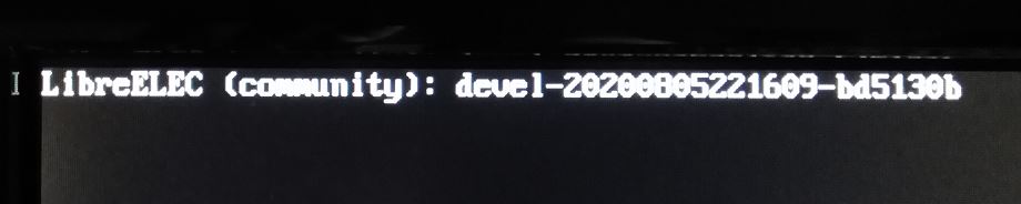

    LibreELEC-A64.arm-9.80-devel-20200805221609-bd5130b-orangepi-win.img.gz
    U-Boot SPL 2020.04 (Aug 05 2020 - 19:54:16 +0200)
    DRAM: 2048 MiB
    Trying to boot from MMC1
    NOTICE: BL31: v2.2(release):9.0.0-3780-geabee4a8a97c-dirty
    NOTICE: BL31: Built : 21:12:59, Aug 4 2020
    NOTICE: BL31: Detected Allwinner A64/H64/R18 SoC (1689)
    NOTICE: BL31: Found U-Boot DTB at 0x40800e0, model: OrangePi Win/Win Plus
    NOTICE: BL31: PMIC: Detected AXP803 on RSB.
    U-Boot 2020.04 (Aug 05 2020 - 19:54:16 +0200) Allwinner Technology
    CPU: Allwinner A64 (SUN50I)
    Model: OrangePi Win/Win Plus
    DRAM: 2 GiB
    MMC: mmc@1c0f000: 0, mmc@1c10000: 1
    Loading Environment from FAT... *** Warning - bad CRC, using default environment
    In: serial@1c28000
    Out: serial@1c28000
    Err: serial@1c28000
    Net: No ethernet found.
    starting USB...
    No working controllers found
    Hit any key to stop autoboot: 0
    switch to partitions #0, OK
    mmc0 is current device
    Scanning mmc 0:1...
    Found /extlinux/extlinux.conf
    Retrieving file: /extlinux/extlinux.conf
    183 bytes read in 5 ms (35.2 KiB/s)
    1: LibreELEC
    Retrieving file: /KERNEL
    21524488 bytes read in 1128 ms (18.2 MiB/s)
    append: boot=UUID=0508-1625 disk=UUID=084266b3-ef42-4473-85a7-fbf6d8269ca8 quiet console=ttyS0,115200 console=tty1 systemd.debug-shell=1
    Retrieving file: /sun50i-a64-orangepi-win.dtb
    30039 bytes read in 5 ms (5.7 MiB/s)
    ## Flattened Device Tree blob at 4fa00000
    Booting using the fdt blob at 0x4fa00000
    Loading Device Tree to 0000000049ff5000, end 0000000049fff556 ... OK
    Starting kernel ...
    [ 0.198532] sun50i-de2-bus 1000000.bus: Error couldn't map SRAM to device
    [ 0.199304] sun4i-usb-phy 1c19400.phy: Couldn't request ID GPIO
    [ 0.395076] sun8i-dw-hdmi 1ee0000.hdmi: Couldn't get regulator
    [ 0.395586] sun4i-drm display-engine: Couldn't bind all pipelines components
    [ 0.410605] sun4i-usb-phy 1c19400.phy: Couldn't request ID GPIO

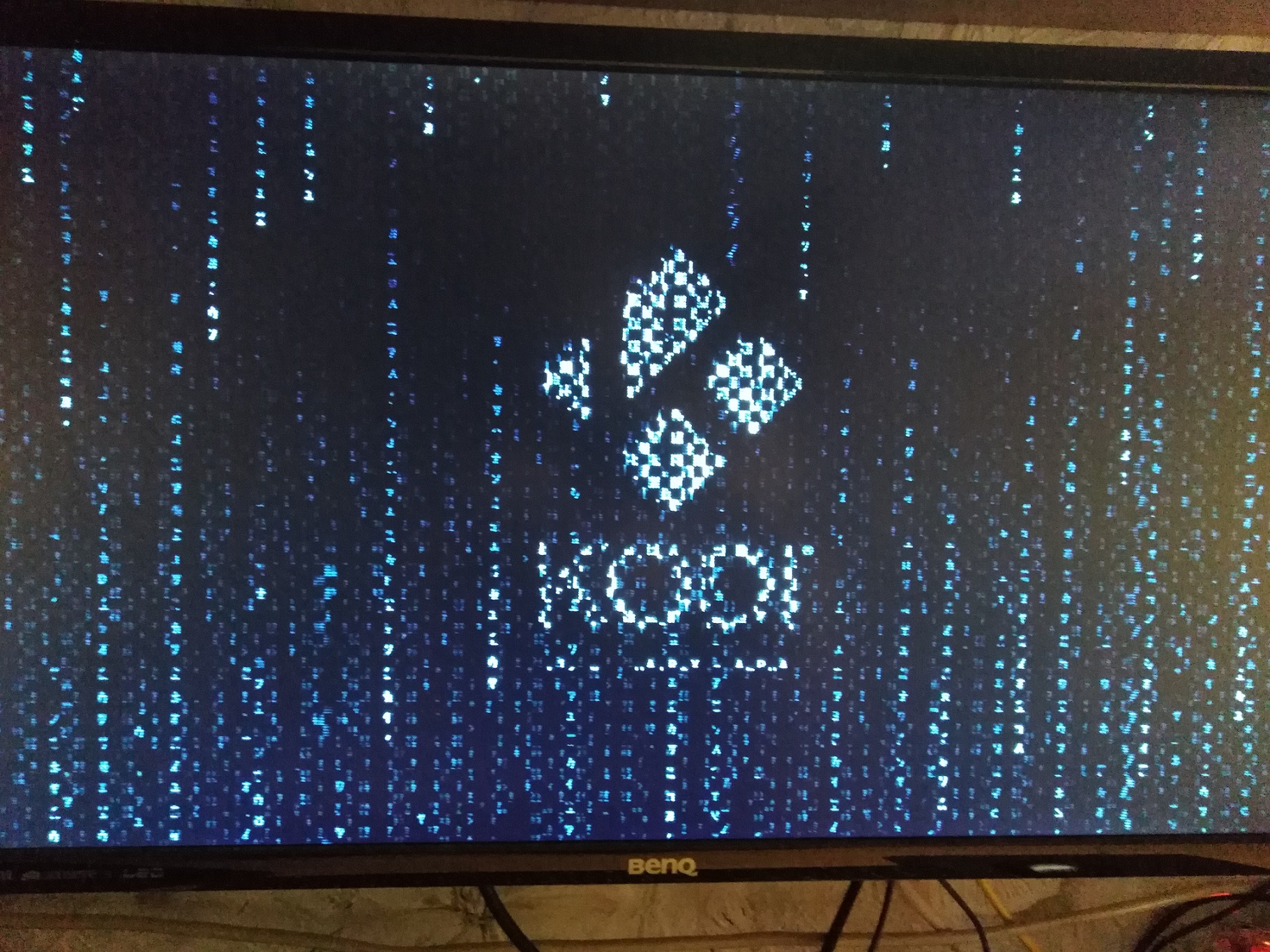

    and it's all from the console.......................
    LibreELEC-A64.arm-9.80-nightly-20200808-63dfb3b-orangepi-win.img.gz
    replaced file
    system booted
    these are logs
    log-2020-08-09-12.25.56.zip
