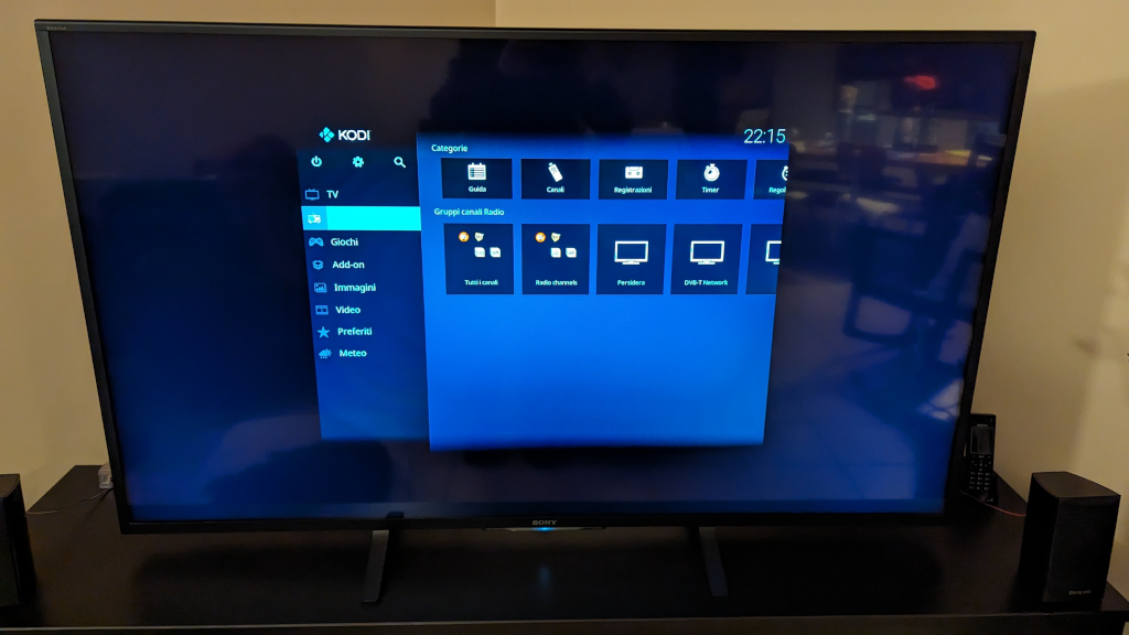

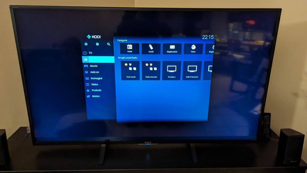

    I finally managed to see the low resolution screen with the logs enabled.
    The log is https://paste.libreelec.tv/rational-crane.log
    This is the xrandr output:
    The problem happens randomly, when I start Kodi with AV Receiver and TV off,
    thanks for help,
    tode
