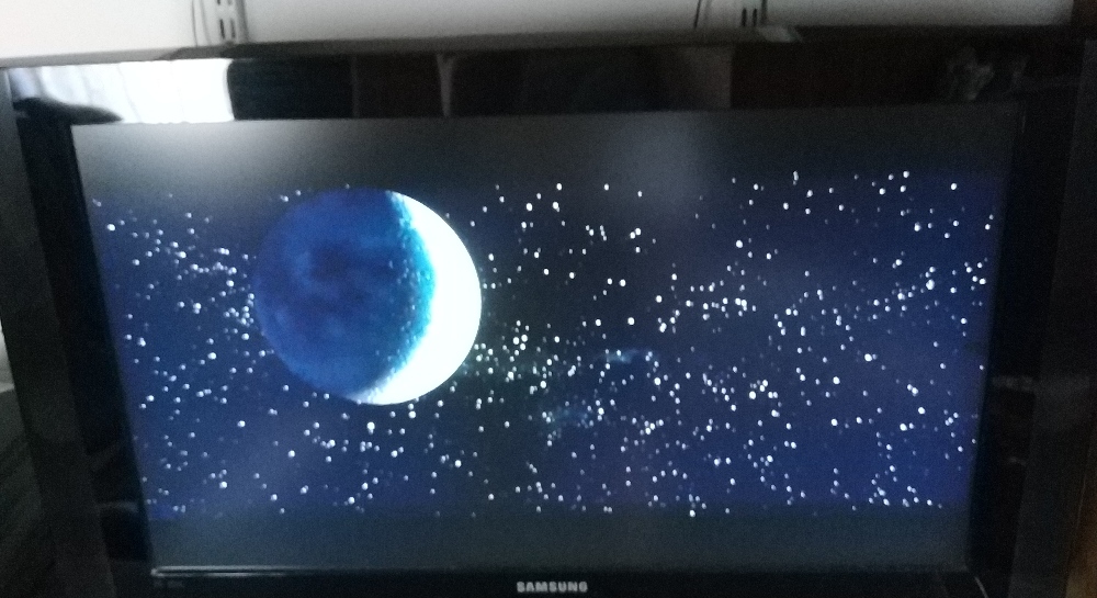

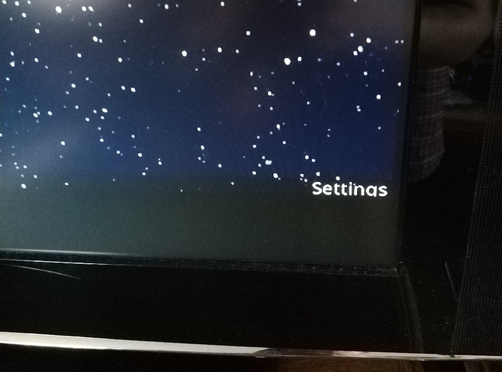

Yeah, I saw such issues when there was a bug in display driver when using more than one plane. In this case video is one plane and GUI overlay another. For some reason overlay plane gets clipped to the visible size of video plane.

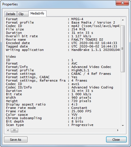

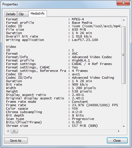

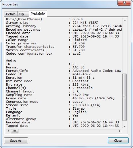

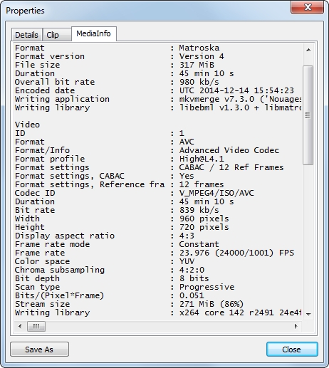

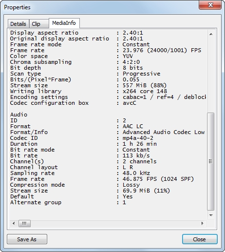

Can you tell me more about your setup? What is your display resolution and refresh rate? What is the frame rate of the videos which can cause this issue? Board is OrangePi PC, right?

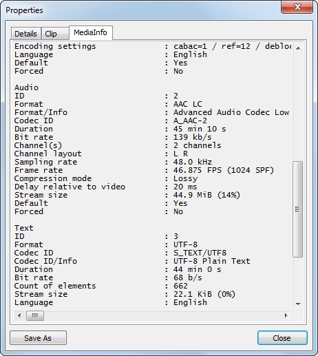

Display is a Samsung TV, 1280x720, 60 Hz. Vids are usual 24/25 FPS, nothing fancy. I grabbed media info screens from MPC, hope it helps. Yes, I have Orange Pi PC.
This sounds like display driver issue, more specifically DE2 driver. I'm aware of one unfixed issue but it shouldn't be visible like this. I would need to reproduce it to figure it out...

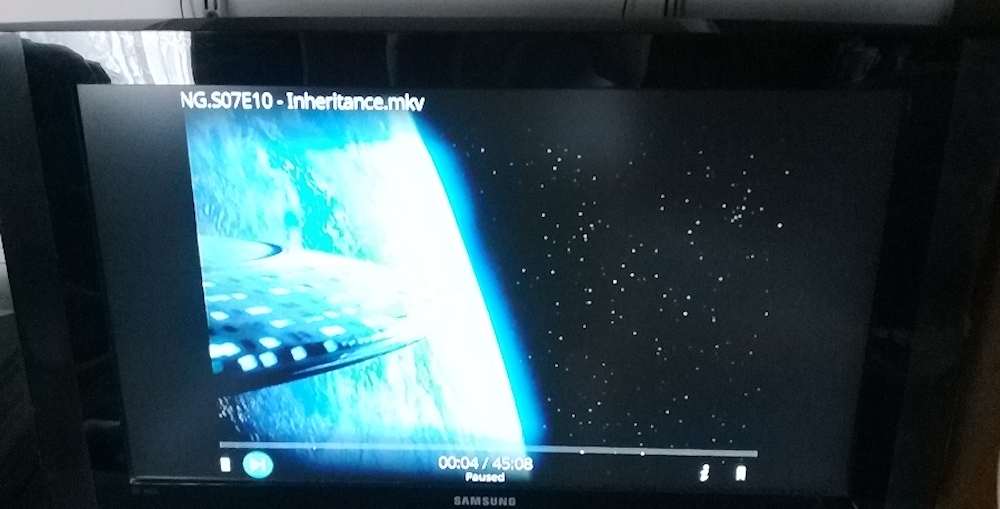

Sometimes it happens after a few minutes, sometimes it takes longer. I made some photos to show what's happening. First photo is 4:3 vid, second a movie and on third pic only thing that cn be seen after I scroll through menu.
Hi everyone, first I want to say thanks to jernej for his amazing work on this project. After using Armbian on all of my trusty old Opi PCs for ages I decided to repurpose one of them and try LE on it. Impressions: Boot was super fast, menus are smooth, cpu runs very cool, never exceeded 53 degrees. Playback is great most of the time with some green screens here and there but the strangest thing is that video menus disappear on non 16:9 vids after some time. For example, on vids with vertical bars (4:3 ratio) portion of menus that go beyond black bars are not visible but parts of title and menu that runs over area where video is running are still there while on movies which have horizontal bars title and menus are not visible at all. Guess this is issue with lima/mesa.
