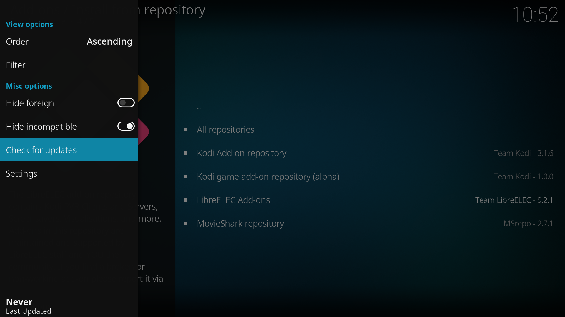

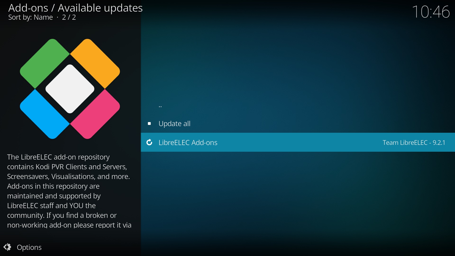

IMPORTANT NOTICE!
Due to the switch to GLIBC v2.34, all binary addons have been rebuilt. The main version of the add-ons has been changed from v9.2.0 to v9.2.1, so after the system update, the binary add-ons will also be updated. In addition, the default transfer protocol in the repository has also changed from HTTP to HTTPS.
NOTICE: If the auto update is enabled, but the installed version is not the latest, then the supported devices…
