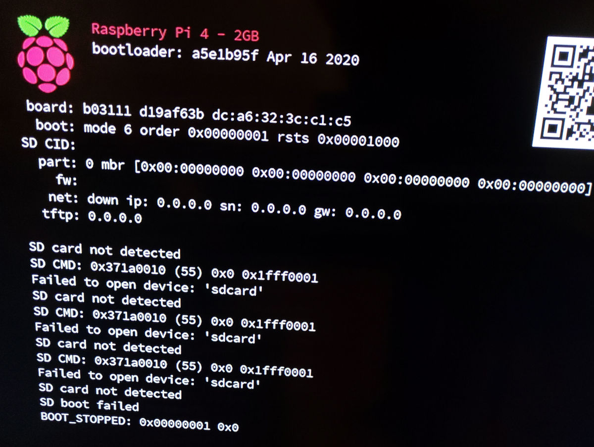

    There was no SD card inside when I have tried to boot from the SSD. The UUID's of the partitions (viewed from GParted) match those in cmdline.txt. LIBREELEC-partition has type vfat, isn't that correct?
    Incompatible?
    It worked the 1st time, so it should work the next time as well.
    Double-check the correct uuid's of the drive and in the config.txt file.
    Well I installed a fresh instance of LibreELEC to the external SSD so how could UUID there? I'll check it in the evening.
    I did use a different adapter however when installing LibreELEC and when I booted the RPI.
    I have had weird freezings with the main adapter when I've copied huge amounts of data to it.
    My USB-to-SATA-adapter is USB312SAT3CB by StarTech. I think it'll suffice.
