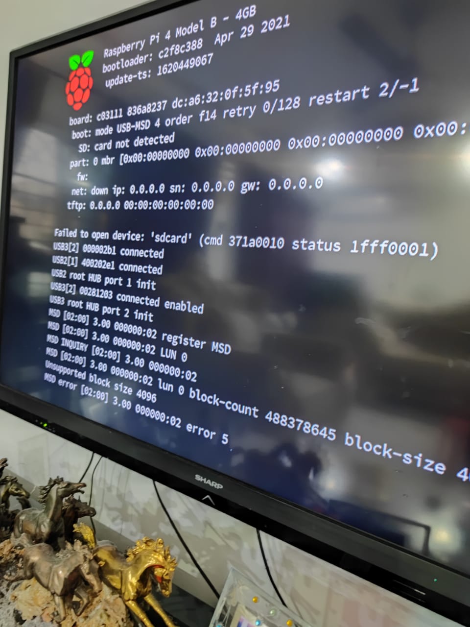

    Hi. Thanks for the reply. I have been able to boot from ssd for some time already. After further checking, i believe my ssd adapter is broken. Ordered a new one. Hopefully it would work.

    hi HiassofT . repartitioned the ssd as your suggestion. it detected immediately after that. no delay. then I restored my backup. now its stuck in a restart loop.
    I get
    checking backup file ... ok
    This may take some time to complete, please be patient.
    Restoring.. \|/
    after a long time, it restarts and repeats the process.
