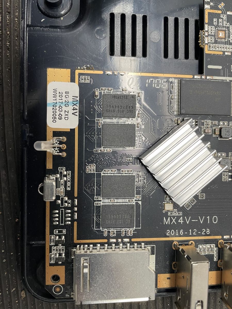

    2) can you give me the name of your board !? Definitely with libreelec 11, but already now I want to start censoring the boxes and creating the appropriate dts. Doing it by model does not work, because often what is indicated in the case does not correspond to the board contained in it.

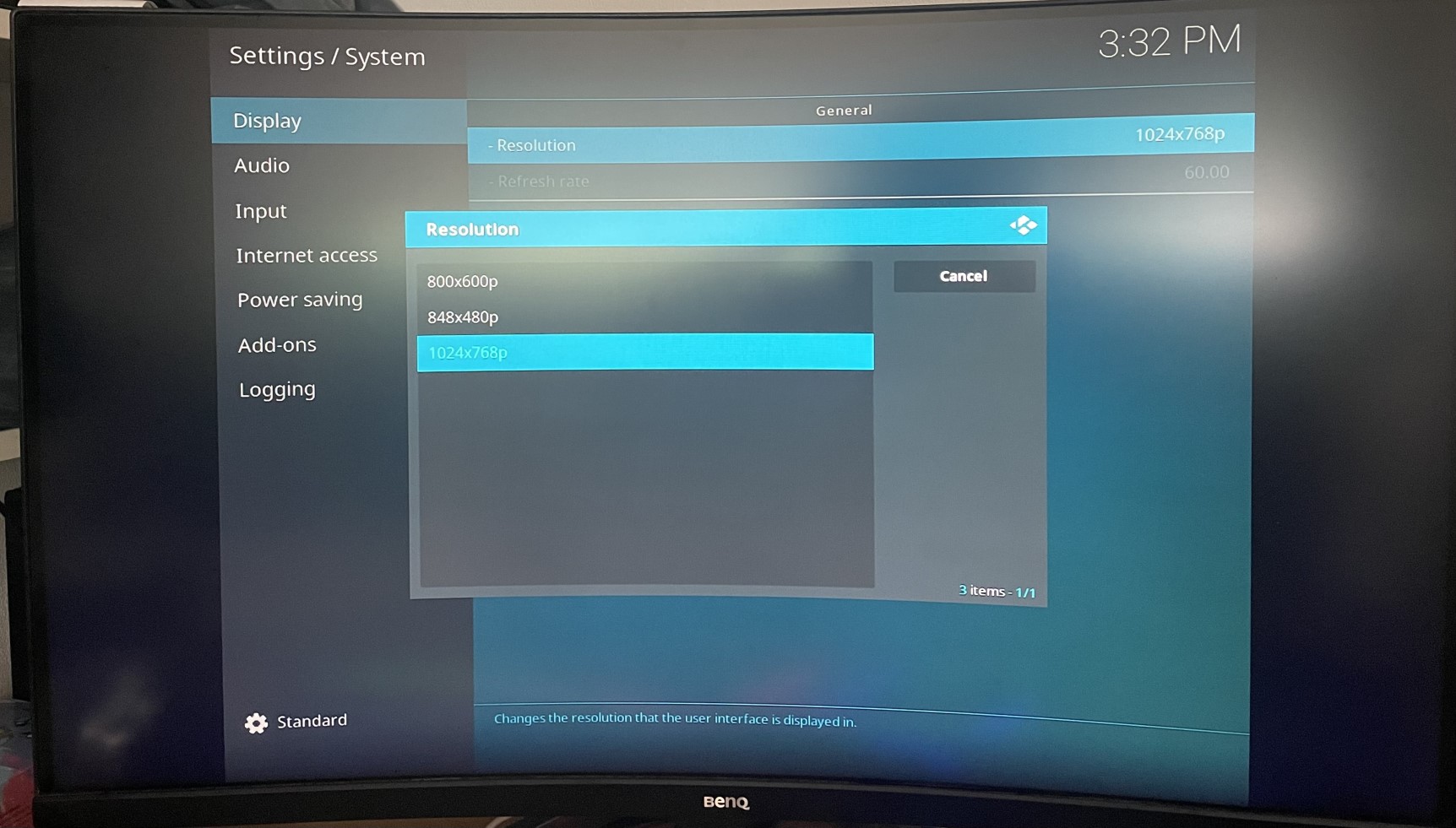

    Anyways the pics I uploaded are on my QHD BenQ EX3203R
    For the name of the board here you have a pic, I suppose it is MX4V

    As spected I have the same problems
    - Max image resolution 1024x768 --> no image on my main viera TV and 4:3 image on my monitor as seen in pics
