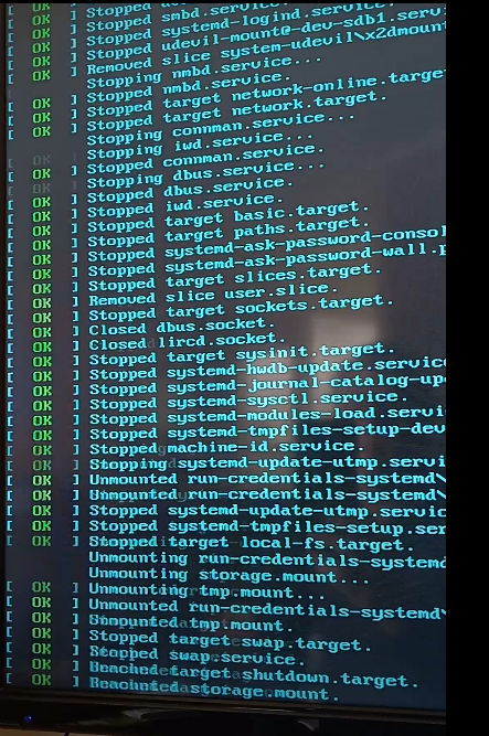

    I poked around using a bootable usb drive. And turned of f Quiet and got the following output. here is a picture of the last thing that shows up on the screen before it reboots. Maybe its of no help.
    This is libreelec generic AMD/Intel etc.v11 install. that I have done a new install on. I was using the other generic -legacy before. Both don't work. Im an expert at installing anyway.
    Please advise

    Update on my situation.
    I have tried several installs. Same issue. One time I went in and blew away everything and partiions, then recreated and formatted as ntfs, (Because I have have seen sometimes linux likes to blow this away. ) after this it did the same eg. continuous rebooting but before failing it said
    failed to start iwd.services,
    dbus.services
    pulseaudio.service ,
    systemd-logind.service,
    connman-vpn.service
    and maybe one other failure message but i didnt get it.
    Does that help ??
    Its like its getting almost done, eg there is video, a mouse then reboots.
    I changed the HD thinking maybe its bad, but this did not work.
    I remind you this worked fine on version 10.
    Anybody want to take a stab at it ?
    Thanks.
