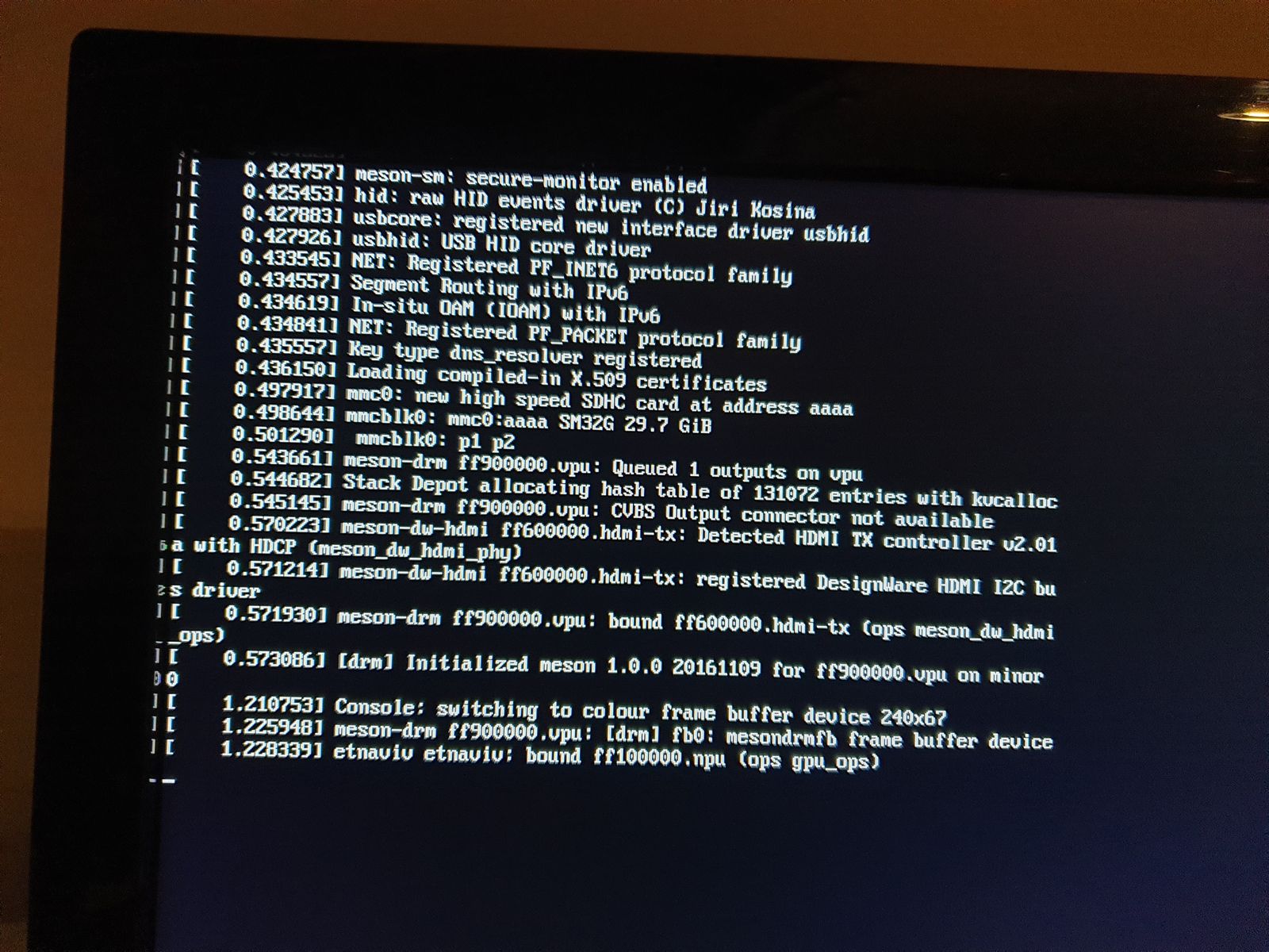

By the way: I've also tested the Img on "dreamtv" (s905x2, u212) same manufacture, other vendor, android streaming box.
it has a real problem with mmc 0, it can load kernel form it, but the later mount fails and the /dev/mmcblk0 does not exists only mmc 1 (emmc).
