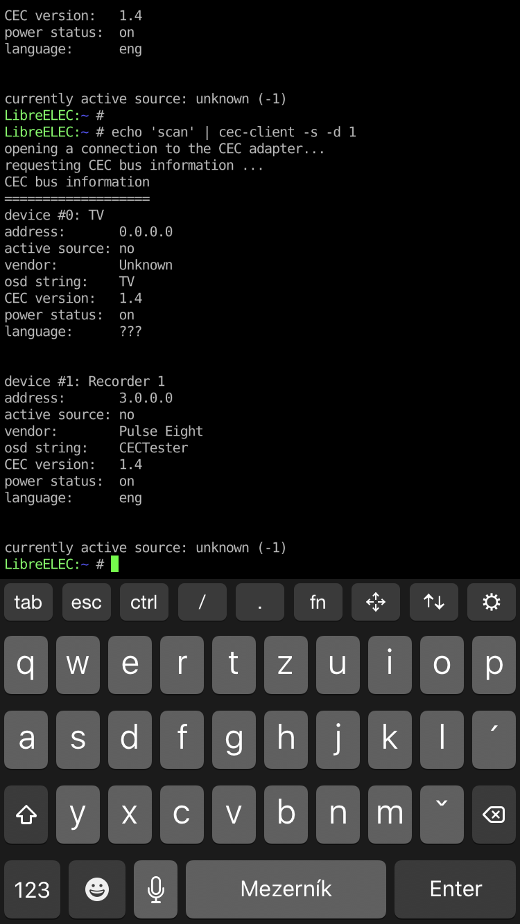

    On my QE65Q60 after command echo 'scan' | cec-client -s -d 1
    but not working :(

    like turn off/on the tv via HDMI-CEC from the PI? or switch the active source with this: 'as' ? I would go with some easy commands to see if the hdmi-cec is working correctly, out of this image for me it is interesting why the Vendor is not known...

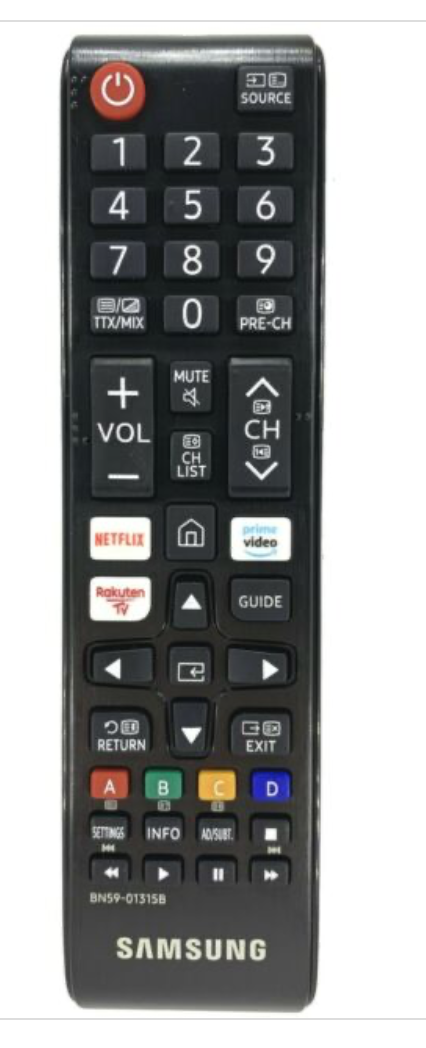

    For me I have a samsung tv remote with some pre defined buttons, like Netflix, Prime (i am not happy with it, but that's the way...) and unfortunately the button "Exit" in my old Samsung TV was the simple command to go back, navigate back, previous menu... now in this remote this is not working :D so i needed to remap it to button A(red)...

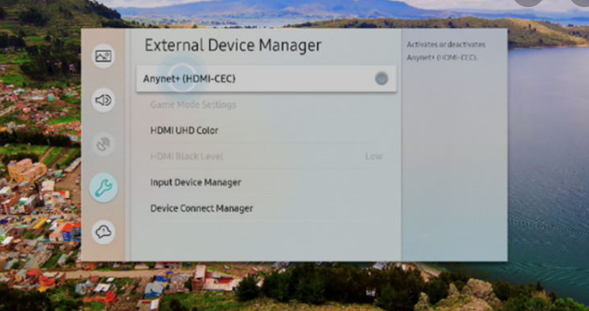

    Last but not least, i have a Samsung TV with this new Tizen OS (not better, but once again that's the way... :) ) , so in this newSamsung (pictures attached) look-a-like setup when i connect my PI over HDMI to the TV then the HDMI-CEC setup starts... and there is a predefined list of hardwares like blueray players, AVs, XBOX, PS4, soundbars, lot's of stuff... but PI only works for me if I select "PC"... no clue why, as said before this only in the newSamsung Tizen OS.

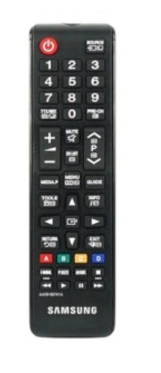

    I have a Samsung RU7099 (2019 model) with a Pi 4 and latest LibreELEC 9.2.1 with kernel Linux 4.19.106 Kodi 18.6 and the HDMI-CEC also not working for me :( Pi is connected directly to TV nothing in-between. I have a small HDMI cable to change small HDMI from Pi4 to normal big HDMI to TV.
    Can somebody confirm who has modern Samsung TV that he/she has the following buttons in the remote: Rakuten TV, Netflix, Amazon Prime... My stupid samsung tv has those buttons (before it was other buttons there) and maybe it is not working because of these pre configured buttons on the remote? (I am attaching 2 pictures of the different remotes)
