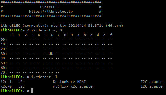

    Thank you for the advice.
    Unfortunately, I have little knowledge in this regard.
    I've read about overlays in the wiki, but there is only Raspberry described, no Allwinner.
    I took the sun50i-h6-i2c0.dtbo file from Armbian and copied it to the /flash/overlays folder in LE.
    But still no detection of the PCF8574 interface address.
    How do I know the overlay is loaded?
    Does it have to be allowed somewhere else?
    I intend to run LCDproc on an Orange Pi 3. I would like to use a display with an HD44780 controller connected via i2c.
    I connected PCF8574 to OPi3 and it doesn't work. So I tried the i2cdetect utility and I see that my PCF8574 interface is not detected.
    Then I inserted an SD card with the Armbian system into my device and tried the same thing (without any change of connection).
    It works so my circuit is correct.
    What should I do to make i2c work in LibreELEC?
